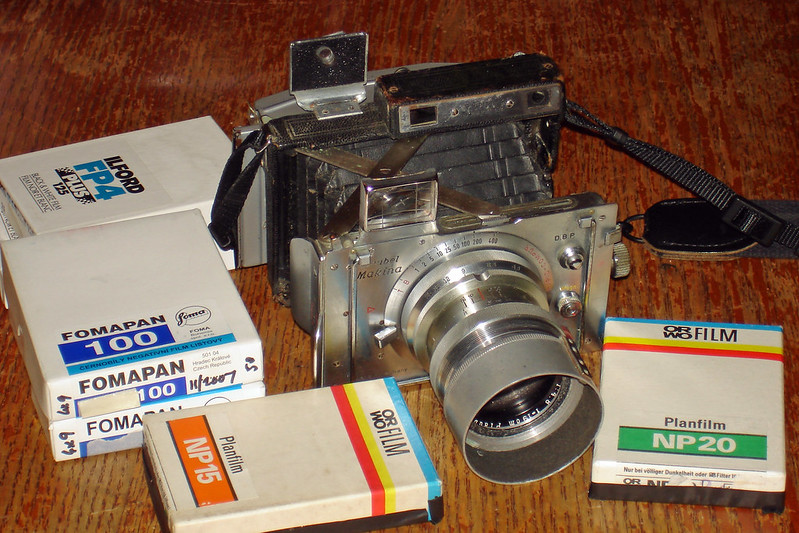

I use 6.5x9cm sheets of Foma 100, Orwo NP20 and NP22, and Ilford FP4+ in my Plaubel Makina III and IIIR, and my three Plaubel Makiflexes. I also shoot full frame Makiflex negs (9x9cm) onto 9x12cm films. Most of this film has come to me from Europe, 9x12cm being the most easy to find. I process the sheets in a Jobo Multitank 6 with sheet film reels on a Unicolor Uniroller.
Sheet film is more expensive to shoot than rolls, but I enjoy the process, it's a lot of fun to do.
