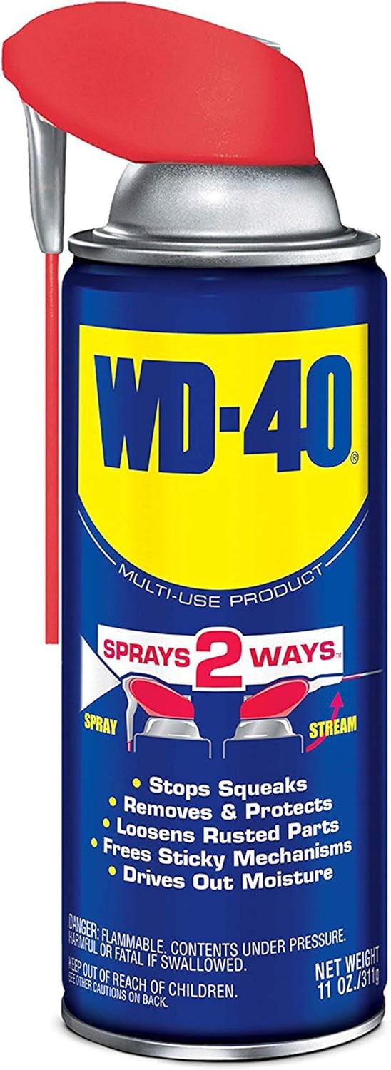

I am pissed and I don't get it . A friend found a Nikon F2 , sounding odd, smells strange, and so we opened and take a look. There are LOTS of WD-40 inside.
"WD-40 is not suitable for camera repairing" is not something new, why people still wished to try on WD-40?
There are still lots of people , from youtube and Reddits, from showing how WD-40 helped them , and then asking why WD-4- is not helping .
I can recall there is a meme of WD-40 for moving parts vs Duct tape for non-moving parts. So would I be seeing people putting duct tapes in the camera later, saying for mounting the lens ?
And I rarely see people would put WD-40 in the watches. Since they believed WD-40 is almost "universally workable on everything" why don't they put it on watches ? Or, should I say , would I see it too in the future?
WD-40 is a common household item (a lightweight oil / solvent) that a lot of people have, and it comes in a spray can so it's easy to apply on hard to reach things, so it is often used by amateur do-it-yourselfers even when it's not the right choice. I just used it to flush out the squeaky hinges on my friend's dishwasher for both its spray and lube properties, which saved me from having to take apart the entire front of the dishwasher. It's not really appropriate for anything more delicate than that, or for any place that has strong requirements on material properties (you wouldn't use it as car engine oil or bearing grease). It doesn't belong anywhere near cameras, but it is one of the default tools of people who don't have the right tools or knowledge, like using pliers to turn nuts.
WD-40 isn't a lube and if it looks like lube inside your F2 it probably isn't WD-40. It is as the name says a Water Displacement spray that can also loosen up grease that's already in a mechanism to make the mechanism work again, which is why it is often confused with a lube. If it is a lube that you want use GT-85 spray which has a silicone lube in it. When WD-40 has evaporated it shouldn't leave any reside unless it has flushed out old grease and oil in the process. Because of the way it can penetrate WD-40 can be used in place of a proper penetrating oil for stuck nuts so it's always good to have some around the house.
If you use it specifically when working on lenses, for example, it is very useful. I like to use it to loosen stuck retaining rings that resist the spanner wrench. Since it creeps, it must be removed afterwards.

WD-40 isn't really suitable for much of anything. It's a low budget spray lubricant, not a pro product. The pressure of spraying might displace water, but water actually gets trapped underneath it too. It was forbidden for that reason in the locksmithing dept where I worked. It induced corrosion more often than preventing it. (I was the lock buyer, among numerous other hats I wore). We used a far better product called LPS-1. But would I personally use any of those oily substances inside a camera? - nope, unless it was an extremely small amount applied to a mechanical connection. The rear release pull on my Pentax 6x7 was getting stubborn, so I used the tiniest amount of LPS in there, pulled the release a few time, and let is all dry out with the rear open all night before putting the camera back in service.
Another giveaway is when people would wipe down the surfaces of their cast iron table saws and so forth with WD-40, and find out it makes the rust worse. LPS solved that issue too.

What the manufacturer claims for WD-40 Multi-use Product Aerosol : https://www.wd40.com/myths-legends-fun-facts/
"A QUESTION OF LUBRICATION​
Myth: WD-40 Multi-Use Product is not really a lubricant.​
Fact: While the “W-D” in WD-40 stands for Water Displacement, WD-40 Multi-Use Product is a unique, special blend of lubricants. The product’s formulation also contains anti-corrosion agents and ingredients for penetration, water displacement and soil removal."​
The MSDS list of contents includes only 'Aliphatic hydrocarbon', and 'Petroleum Base Oil', and CO2
The WD-40 Specialist Penentrant MSDS also lists the above three, with the additional 'Petroleum Solvent'
Petroleum Base 'Oil' is common to both of the above products. Nevertheless, as an ocean-going sailing vessel owner, I never used WD-40 to 'lubricate' much of anything. Limited WD-40 use to clean, de-grease, and dissipate moisture; there were a number of much better 'lubricants'
Millions of products are aliphatic hydrocarbon petro based. That in itself tells you nothing pertaining to quality. CO2 is just the propellant. There are numerous brands of spray lubricant in this general category. WD-40 is sold everywhere. But it's distinctly on the low side in terms of performance. Check out any true industrial supplier like McMaster or Grainger for a more serious selection. Starrett offers their M-1 machine oil in little hypodermic like packs too, nice for confined spaces. At one time, genuine sperm whale oil was preferred for delicate projects or instrument winterization; jojoba based plant oils replaced that, but proved short term. I haven't kept up with it - just so many kinds. I do need to order some more LPS-1 over the web, since none of the local hardware stores carry it anymore. Knowledgeable staff are even rarer.
But that Myth page of WD-40 was fun to read. I haven't heard Stoddard Solvent mentioned by anyone in the past 40 years. Then there was the fad when people were rubbing DMSO solvent on their joints for arthritis. I didn't know a similar trend occurred with WD-40. Might have been OK for the Tin Man in the Wizard of Oz, but per human physiology? Yikes!

wd-40 has only one significant problem... it has excellent penetration and "cleaning" properties, BUT over time it does dry to a gummy residue, therein lies the problem on watches and camera's, etc.
Yes, WD-40 clumps the dirt it moves and forms a gummy residue. An example with different equipment is that WD-40 will temporarily free a garage door mechanism from jamming on the screw shaft. However, over time, the debris and residue from the WD-40 will build up and the screw thread has to be completely cleaned for the garage door to function again. This WD-40 property of moving dirt on the garage door opener is an example of WD-40 moving dirt on camera parts. WD-40, as noted in a number of previous posts, is not a lubricant and should not be used for cameras or watches. WD-40 is not a fix-it-all for all problems.
WD-40 is a mix of light oil and solvents - probably light hydrocarbons. It basically says that on the data sheet. You can get an idea of what's in there by spraying some into a cup. It isn't magically good, or magically bad. If left on a mechanism in an environment that has some dirt/dust, an oil-dirt mixture will form that is gummy or gritty and will cause problems. In this respect it's not much different from other oils. If we put too much oil on something, dirt will stick to it.
The good and bad of WD-40 is that it comes in a spray can. This makes it easy to get into hard to reach places, and easy to apply way too much of it. If we sprayed it into a cup and used a pin to apply a pinprick of WD-40 to oil a mechanism, it would probably behave like a pinprick of other light oil and not get overly dirty. But nobody uses WD-40 that way.
