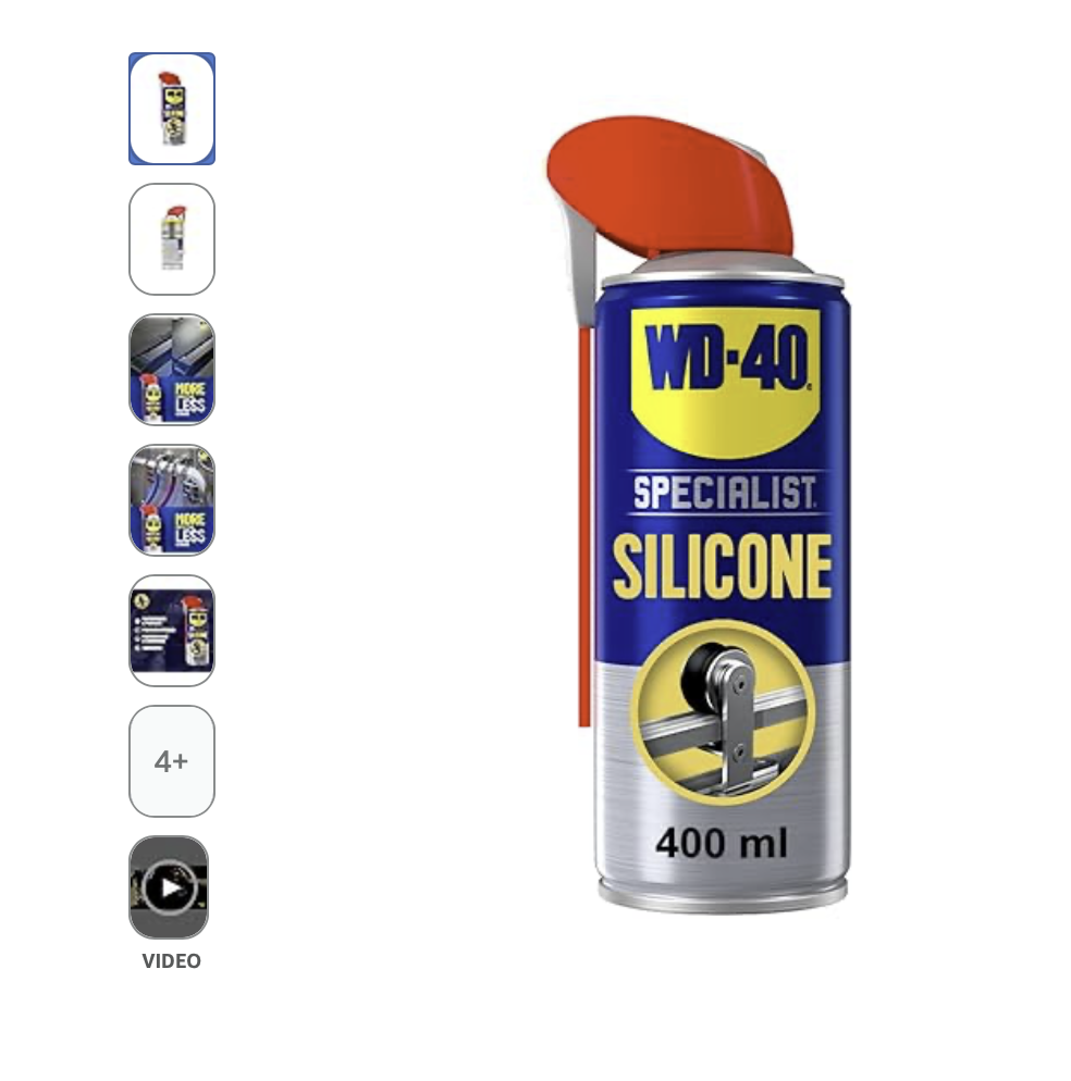

I use WD 40 Silicone Spray on the ball bearings inside plastic developing reels!
