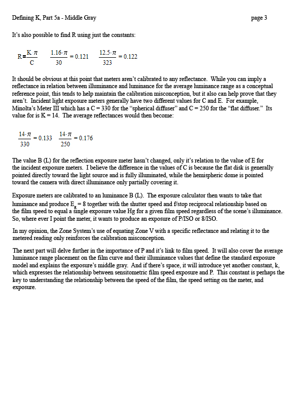

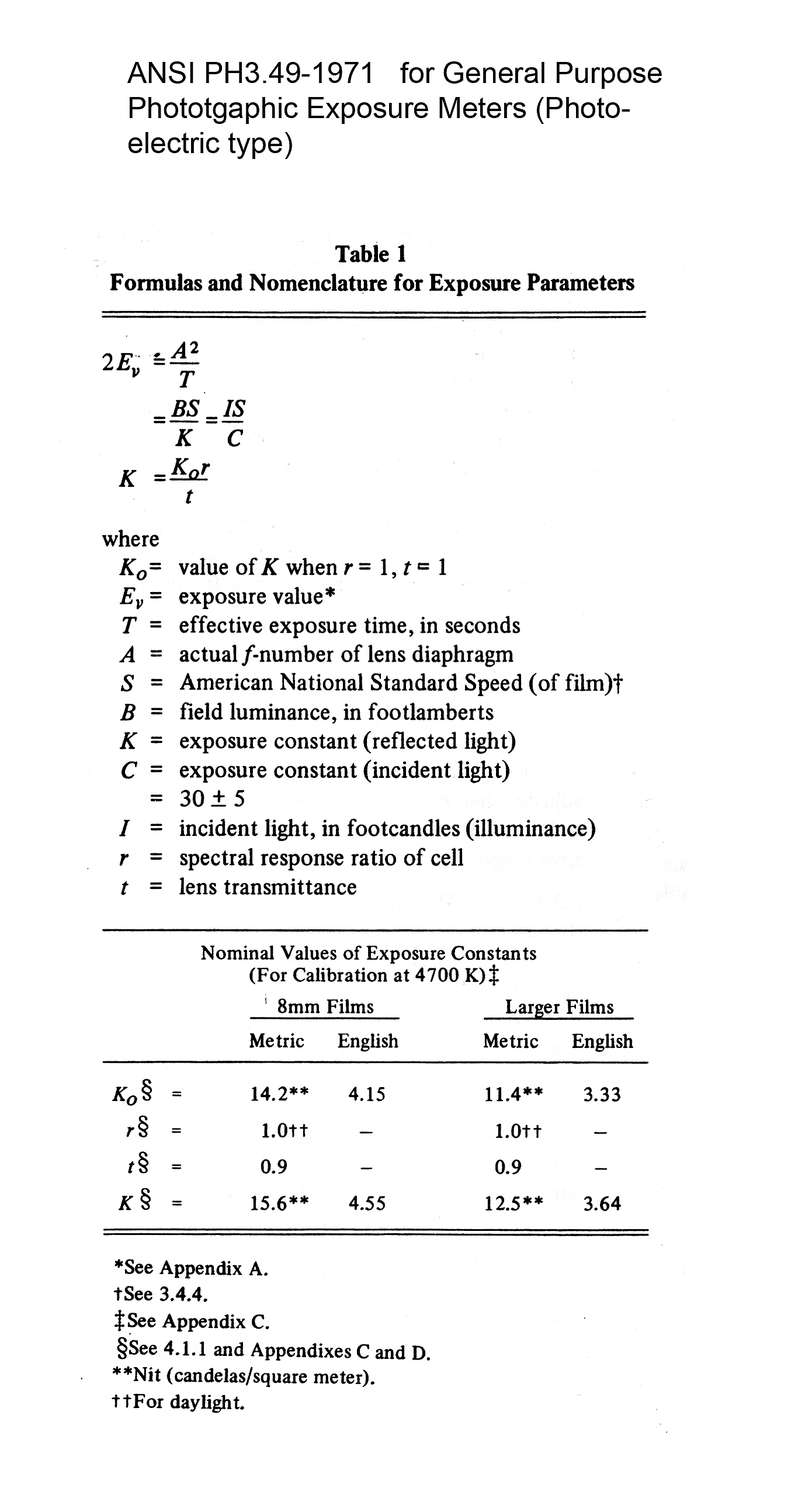

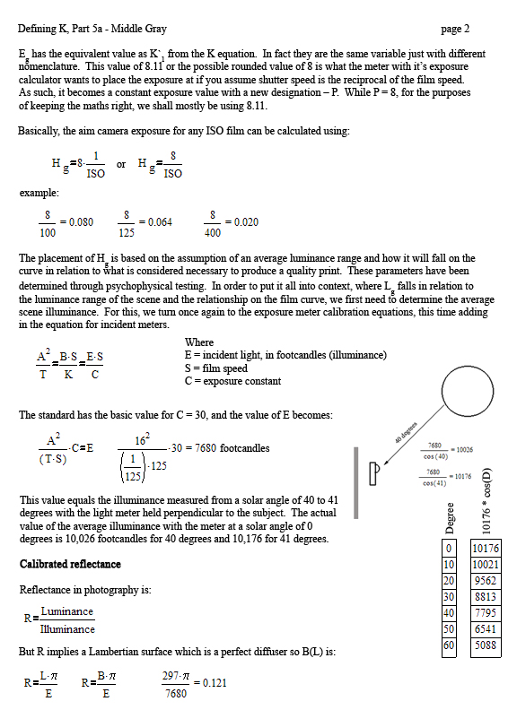

BUT having measured the light falling on the scene which is a measurement in Lux or lamberts or whatever, they MUST do something with it to convert it to an aperture and/or shutter speed for you to set your camera to. They do this by taking your input parameters which are film speed plus aperture or speed and then spit out a result.
2Ev = A2 / T = B*S / K = E*S/C
Where:
B = Luminance
S = Film Speed
K = Exposure Constant (reflected)
A = Aperture
T = Shutter Speed
E = Incident light
C = Exposure Constant (incident)
Ev = Exposure Value
Exposure meter standards formulas and Nomenclature for Exposure Parameters.jpg
Defining K, part 5a p1.jpgDefining K, part 5a p2.jpgDefining K, part 5a p3.jpg
Where:
B = Luminance
S = Film Speed
A = Aperture
T = Shutter Speed
E = Incident light
Ev = Exposure Value
That implies an incident meter will give same reading as a spot meter but it won't unless you point the spot meter at a subject of specific reflectance. So what is that specific reflectance percentage?
I'm asking becasue that percentage will tell you if an incident meter is keyed to a highlight, mid tone or a shadow.

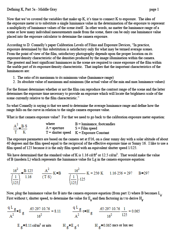

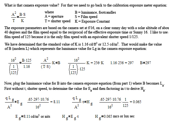

Reflection meters "see" luminance, but it's possible to calculate an equivalent reflectance. It's broken down in detail in the three bottom attachments in the previous post but here is an excerpt with the calculations:
but a quick way to figure equivalent reflectance is with the equation K / C.
K = 1.16 * pi
C = 30
3.664 / 30 = .121 or 12%

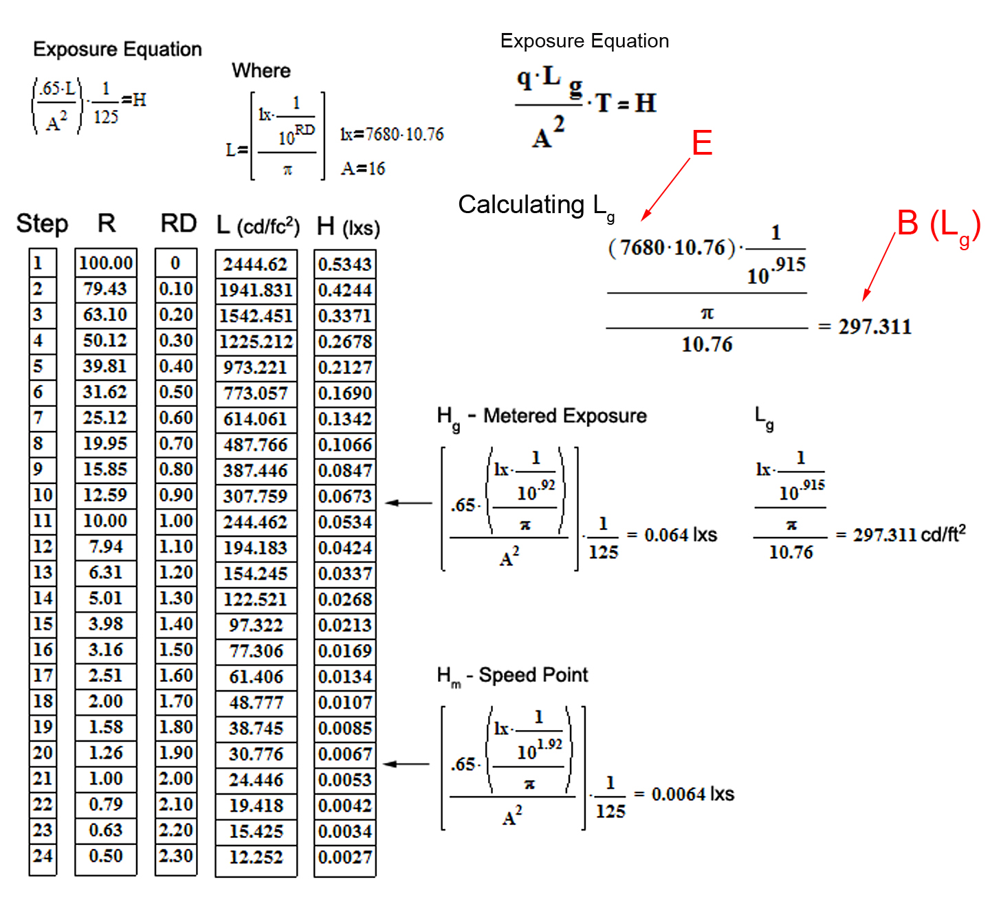

E in incident meter for f/16 at 1/ISO is 7680 footcandles. This is also explained in the three attachments which are part of the Defining K document available online.

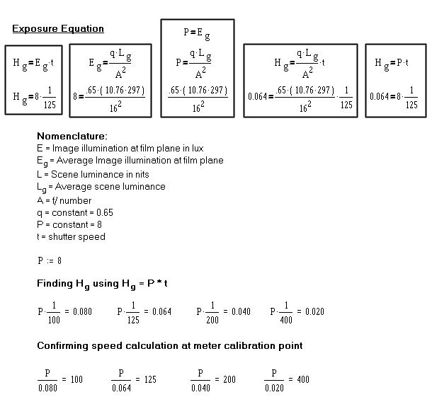

Exposure meters are calibrated to an luminance Bg (Lg). (subscript g means the statistically average or mean value). The exposure calculator then wants to take that luminance and produce Eg = 8 together with the shutter speed and f/stop reciprocal relationship based on the film speed to equal a single exposure value Hg for a given film speed regardless of the scene’s illuminance. So, where ever I point the meter, it wants to produce an exposure of Eg/ISO or 8/ISO.
Incident meters also want to produce a an exposure of 8/ISO. Let's plug that in for different film speeds.
8/100 = 0.080
8/125 = 0.064
8/400 = 0.020
Here is the breakdown using the camera exposure equation.
So where does the 8/ISO exposure fall? Here is a breakdown of the values of exposure from 100% to 0.6% reflectance using a film speed of 125. Lg is the statistically average luminance. Notice how the two values of C and B from the exposure meter equations work in the exposure equation. Where does the exposure of 8/125 = 0.064 fall?
So where does that place Lg? The RD of 0 (highlight) is 0.91 logs above or 3 stops. The RD of 2.20 (Shadow) is 1.29 logs or 4 1/3 stops below. The entire range is 2.20 or 7 1/3 stops.
I don't expect anyone to be able to digest everything in a single read through. It took me a number of years to figure all this out. With the Defining K document that I eventually put together, with everything spelled out, and examples with everything linked together, it shouldn't take anyone interested nearly as long.

I can not stress this point enough. All meters want to create a film plane exposure of 8 lx * 1/ISO or 8/ISO = Hg.
