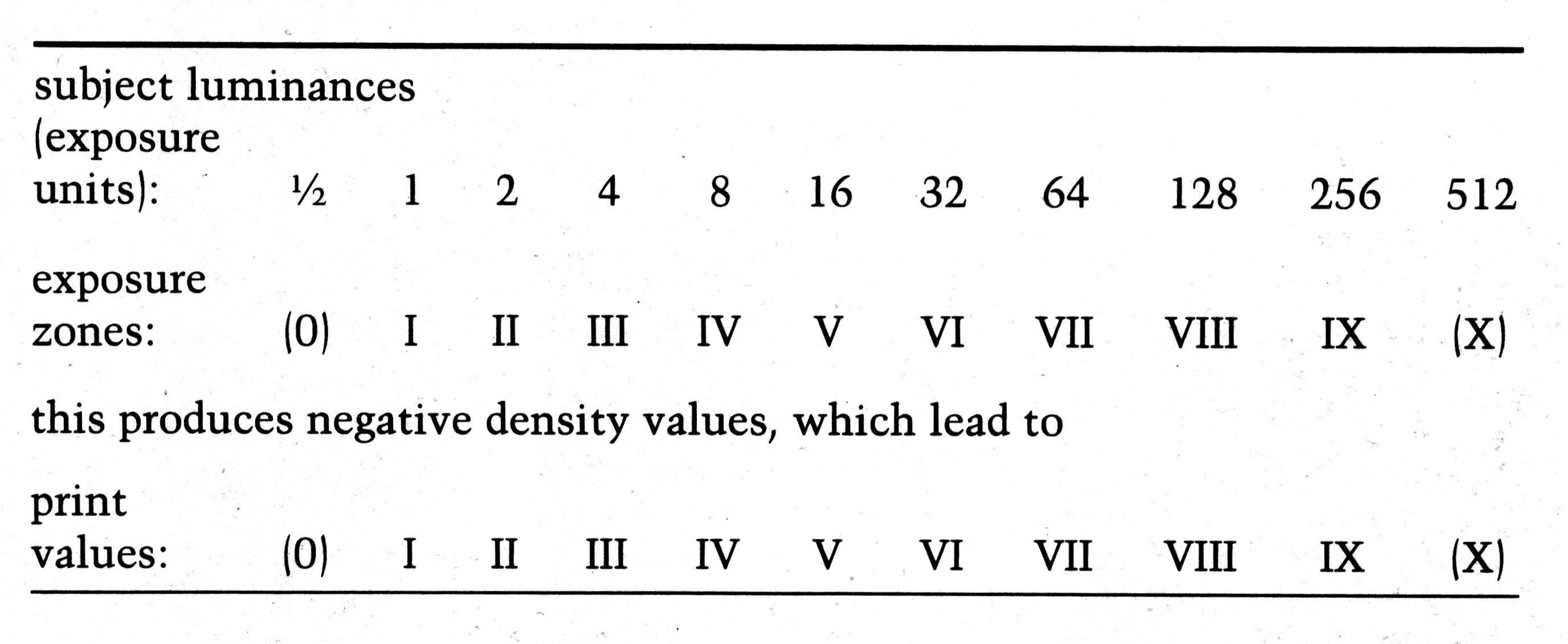

This is from page 55 of Adams' The Negative.
Bill Burk
Bill Burk
Feb 9, 2010
9,500
I think about Zone System (or any metering method including ISO/ASA) as an overlay to the film's sensitometric curves.
Once I draw up my curves, the drawing never needs to be changed (unless I change developer) because the graph reflects the characteristics of the film.
It's like a topographic map of the mountains. I might draw trails and parking lots on a topo map to update the map or draw where I've been or plan where I want to go. But I don't feel any need to change the contour lines. Those mountains are just there.
So I imagine, Drew Wiley, you have no problem envisioning where your pictures will fall on the film's characteristic curves, just as I bet you can tell exactly what lies ahead on the trail by looking at a topo map.
Stephen Benskin
Jan 7, 2005
2,745
Los Angeles
Exactly. Curves don't say much by themselves. The diagnostic strength of the tone reproduction diagram comes from its ability to overlay different exposure situations onto film and paper curves.
