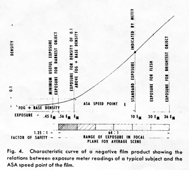

Here's a diagram of the speed determination taken from Current Exposure Meter Technology paper that Stephen gave me...
...showing the relations of the exposure meter reading to the ASA speed point.
Now reversal film is calibrated to highlights and brought down. And maybe that's what you keep thinking about.
But black and white negative film is calibrated to the 0.10 density speed point and brought up.
H sub-m is the speed point. For 100 speed film the exposure required to get the film up to 0.10 density is, in meter candle seconds, 0.0080 mcs (-2.1 log mcs)
The meter is set to desire 10 times that 0.08 mcs (-1.1 log mcs) at the film plane.
Now why might your meter be calibrated to put 0.010 mcs (-1.0 log mcs) there for 100 speed film when that's the amount of light an 80 speed film needs... Perhaps the K factor is being used to put more light at the front of the lens, because some of that light will suffer transmission loss...

I was thinking the problem of using an exposure meter to infer incident light... Because the light is falling on the subject in front of the lens and has some absolute value, while the meter is trying to compute what's behind the lens after some losses.
Reversal film speed point has been measured at the same point on the curve but the speed constant changed changing the film speed. For instance, exposure at the same point HR = 0.064 will produce a film speed of 8/0.064 = 125 for the old equation and 10/0.064 = 156 for the new. This will place the exposure on a different spot on the film curve without changing anything with the meter.
I expect this part happens behind the lens at the film plane. I'll try to figure out the difference 8 versus 10 as we go along... But I think it will help to know if we are talking about the film plane exposure.
You can determine the incident light value using a reflected light meter but the reflectance of the target value needs to be specific. I was talking about film plane exposure.

You can determine the incident light value using a reflected light meter but the reflectance of the target value needs to be known.
Probably would be difficult - I won't propose to do that since I have an incident meter.
But then incident meter applies C to give the film plane exposure recommendation.
When using an incident exposure meter to try to evaluate incident light... Do published charts that convert EV[100] to incident light values... back out C? If they back out C I think they would have a better chance of correctly telling how much light is falling on the scene.
Or is EV[100] a film plane exposure that incorporates C... making those published charts slightly wrong?
