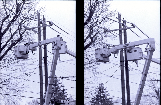

FV w/ 50mm(?) nikkor, Kentmere 100 in Pyrocat-HD 1+1+100

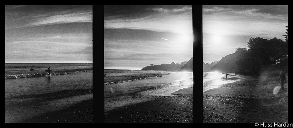

Finally got the Olympus Pen F squared away. First one I bought had serious shutter issues, so it was returned. The second one from Japan, looks beautiful and the shutter was very good, unfortunately the FFD was off by .005" so getting accurate focus was a guessing game. Took the camera apart last week and shimmed the FFD so now it is spot on. Experimenting with different films to see how little grain I can get in an image. Also experimenting with diptych's.
Ilford Delta 100, HC-110, 119:1 @ 68ºF, 24 min

Might check Ultrafine Online, aka PhotoWarehouse, under Kodak. They've got a couple slow Kodak duplicating films that should have exceptionally fine grain. Other options are Adox CMS 20 II (which requires a special developer -- it's effectively a microfilm) or Agfa Copex Rapid (another microfilm, needs low contrast developer). I've used Copex Rapid and the original CMS 20, I liked the latter better but the Copex Rapid is 2/3 stop faster.
Or you can go for good old XP2 Super in HC-110 or Diafine, and have grainless mini-negatives. My best FV has arrived in Québec City, and is working its way through the four week backlog. The second best FV is currently my only camera as everything else is packed up to move house. Not much good having a camera when you have no developing tanks and chemicals!

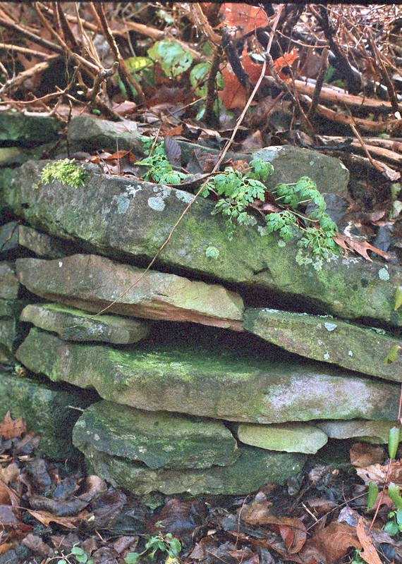

Fuji C200 with 100% crop of 72dpi. With lenses this good on the PenF (40mm 1.4 here) you don't need to go to super slow low grain films.
