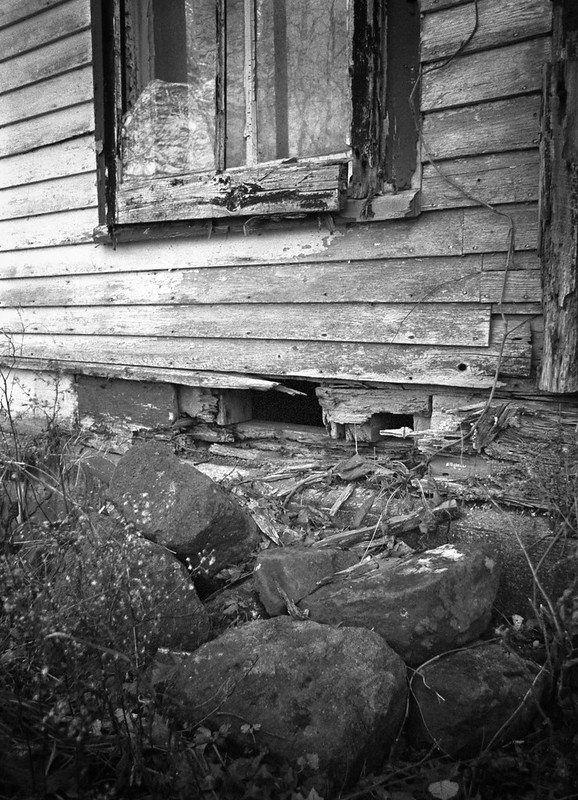

I have a 72 year friend who is wondering whether to take on this place as a project, to save what was one of the province's beautiful farmhouses. I am trying to save her from herself!
I’m 72 and it’s hard enough to keep up on the maintenance of my own home that was built in 1992! To figure the difficulty of a job I estimate the time and money it will take and then multiple by 4 for both the time and money.

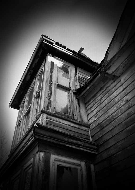

I was quite happy with my first roll of Kentmere 400, so I guess I should start on the bulk roll of Kentmere 100 soon. Shamefully I haven't been able to get out to take more photos on the old Acros 100 I currently have loaded through a combination of shingles and bad weather. But I've a few more of the desirable residence next door to show you first!
