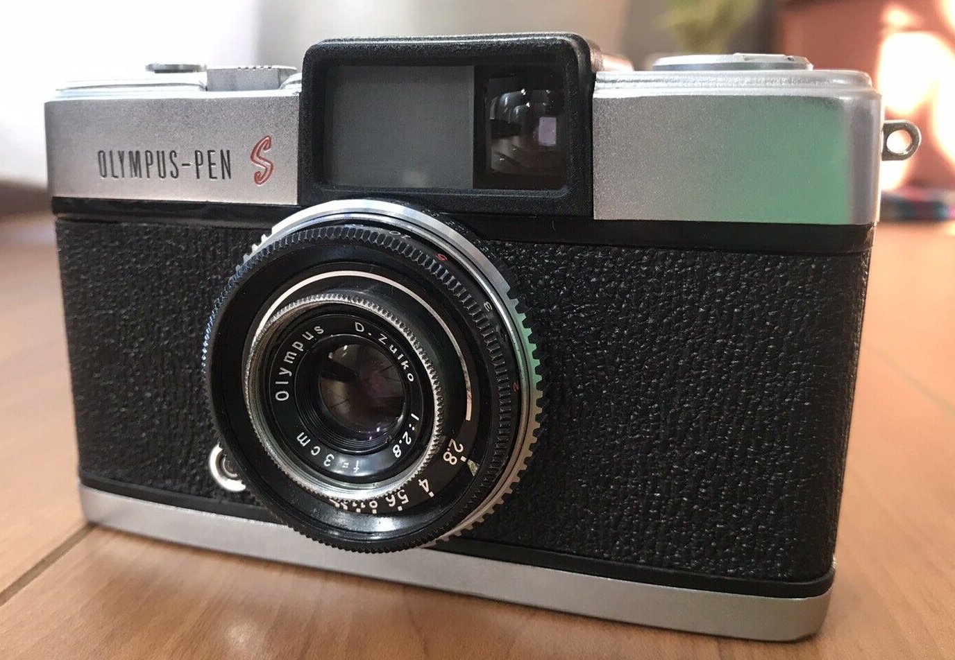

Not an SLR, but...
I recently got a near-mint Olympus Pen S, the second Pen model that was made from 1960 to 1964. It's a gorgeous, tiny little thing, completely manual, and in perfect working conditon. (And it wasn't expensive: $100 including shipping from Japan, via a BIN on eBay.)
It's got a 30mm/f2.8 lens (Tessar-style, equivalent to 45mm on a full-frame camera), speeds 1/8 to 1/250, f-stops down to f/22, and close focus to 2 feet.
Some images from my short test roll. Tri-X developed in D-76 1:1, 2400dpi scans.
Note that any softness is from the scans, all the negs are dead sharp under a loupe. I sometimes have difficulty getting negatives positioned at the exact focus plane, which is a tiny fraction above the scanner glass - correct for mounted slides - and hard to hit precisely, though I've made a bunch of different-thickness cardboard masks attempting to reach that exact position.
Anyway, this camera is a great little casual shooter if you can estimate exposure and focus (in metric). It would be perfect as a "glovebox camera"... though I drive so little these days that keeping a camera in my car is pointless. It won't replace my Pen F, though it's smaller/lighter/simpler and won't need to be handled as carefully - it's more of a knockaround camera, just throw it in a pocket or bag and go.
