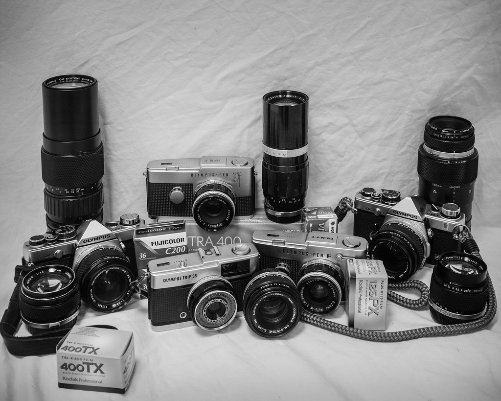

So what am I to do with this now? There is a meterless Pen F with a bright viewfinder and a microprism focusing screen, and it's the Pen FV. One is coming. There is also a shockingly expensive portrait lens of 60mm/f1.5. One is coming. Madness is a real thing, and maybe some of that is coming too. We shall see. Maybe the madness has been a long time coming: here is a 4x5 photo of some of the Olympus cameras I owned:
