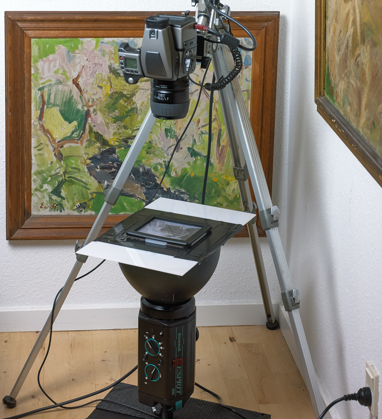

Here is my test rig for digitizing 4x5 black and white negatives with Bowens Esprit 500 flashhead and tethered Hasselblad H3DII 39 in Phocus software. I use a frosted white piece of glass on top of the flash head where I changed the modelling ligt to a small LED, because the heat from the original halogen bulb made the negatives curl rather quickly. As negative holder I use the Pixl-later https://www.pixl-latr.com/
Set-up by Michael G, on Flickr

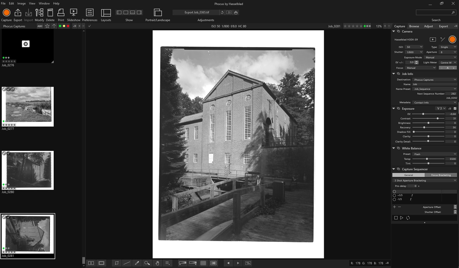

Phocus screendump showing tethered use of Hasselblad as digitizer. by Michael G, on Flickr
I found that the flashhead had to be on minimum and the best settings would be f8 and 1/800 sec to avoid shake, diffraction and influence from room light.

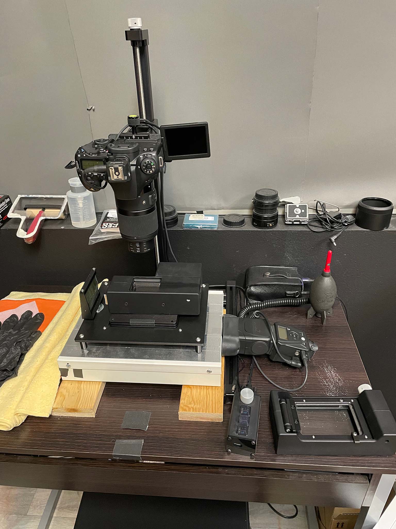

My current setup. I scan anywhere's from a couple hundred to a couple thousand plus rolls a month with this setup, depending on how busy it is.

That is exactly the kind of photo I was hoping to see! Thanks for posting!
So, the flash is aimed at the interior of the box - white paint inside, I assume?
What do you use for a focusing light?
The interior is chrome with a set of custom baffles and diffusion material to distribute the light as much as possible for even illumination out of the top. I spent a fair amount of time working out the best configuration and materials that go inside the box (this is a planned future product, you're basically looking at the prototype).
For focusing, I just turn the flashlight on my phone on and slide it under the carrier so it's pointing down through the top diffuser into the box. It works. I'm in the early design phase of putting a focusing light in the box that can be turned on and off via a switch on the side.

Did you add an extra 35 masking plate so the film can feed straight through the brushes and into the carrier? So far that is one of my annoyances with the Negative Supply setup.
No. It's so I can rapidly switch between the 35mm carrier and the 120 carrier without switching the underlying plate that has the tabs sticking up for the 120 carrier. That and it gives enough clearance for the motorized transport so it sits flat. Without that small amount of extra space, the motor collides with one of the screws in the base plate and it doesn't sit flat, which makes aligning that much more difficult.
Thanks. Saxons' pretty sharp but there are occassional glitches. I modified the riser by adding longer screws and nuts so I could lock the feet in place. I have an extra 35 mask and know where to get longer screws, I might give it a try. Good looking setup, BTW.

I think this is pretty genius. I'm not sure I have the native coordination to use a setup like this without tripping on it :smile:

Yeah, it could be optimized a little for rapid switching between film formats. For home users, it's not so bad, but for a relatively high volume lab, speed wins the day. Ideally, I'd like to see a plate that I can just drop a 4x5 holder on, then lift it up and drop the 120 carrier in, then lift that up and drop the 35mm carrier in and have all those aligned with a slot and tab system so the 35mm frame is exactly in the middle of the 120 frame, which is exactly in the middle of the 4x5 frame. That way, using their stands, I only have to line the framing up once for the 35mm frame and going to a bigger frame size is nothing more than picking up the 35mm frame and putting either the 120 or 4x5 frame into place and raising the camera and/or changing the lens. Tool-less and minimal adjusting or shifting stuff around is key, again, time is money. When it's really busy, I need to average 1 roll of film every 3 minutes for hours on end.
