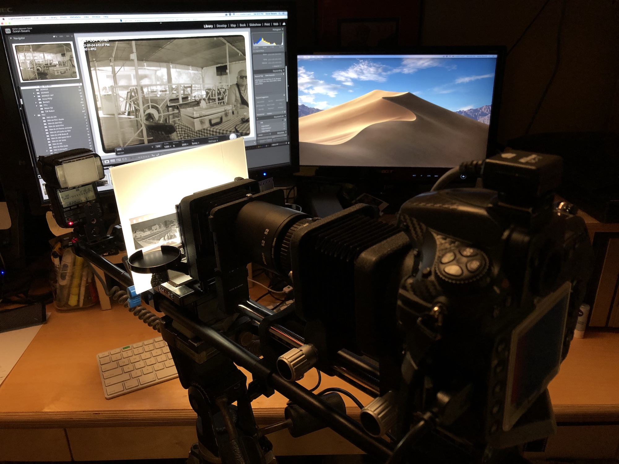

This is my current DSLR rig with Nikon D810, SB-28, PB-5 & PS-4 and APO Rodagon D 4.5/75. Six or more years ago when I started this journey I used Rosco LED panel. Focusing and framing light is 6 heads strip of LED. Even 3 heads will be just fine.
The best solution for one flash to provide even coverage and without added bulk is distance.
Thanks for posting. I think I have the same lens (?) - or similar; mine is f/4.0.
Because I am working vertically, on a copy stand, I was hoping to reflect the flash to keep my working height from getting awkward. I may have to re-evaluate the whole setup - or just be satisfied with what I have. I expect any improvements I might gain from the flash will be fairly small (if any). Did you notice any improvement in either color accuracy or sharpness when you switched from the LED panel to flash?

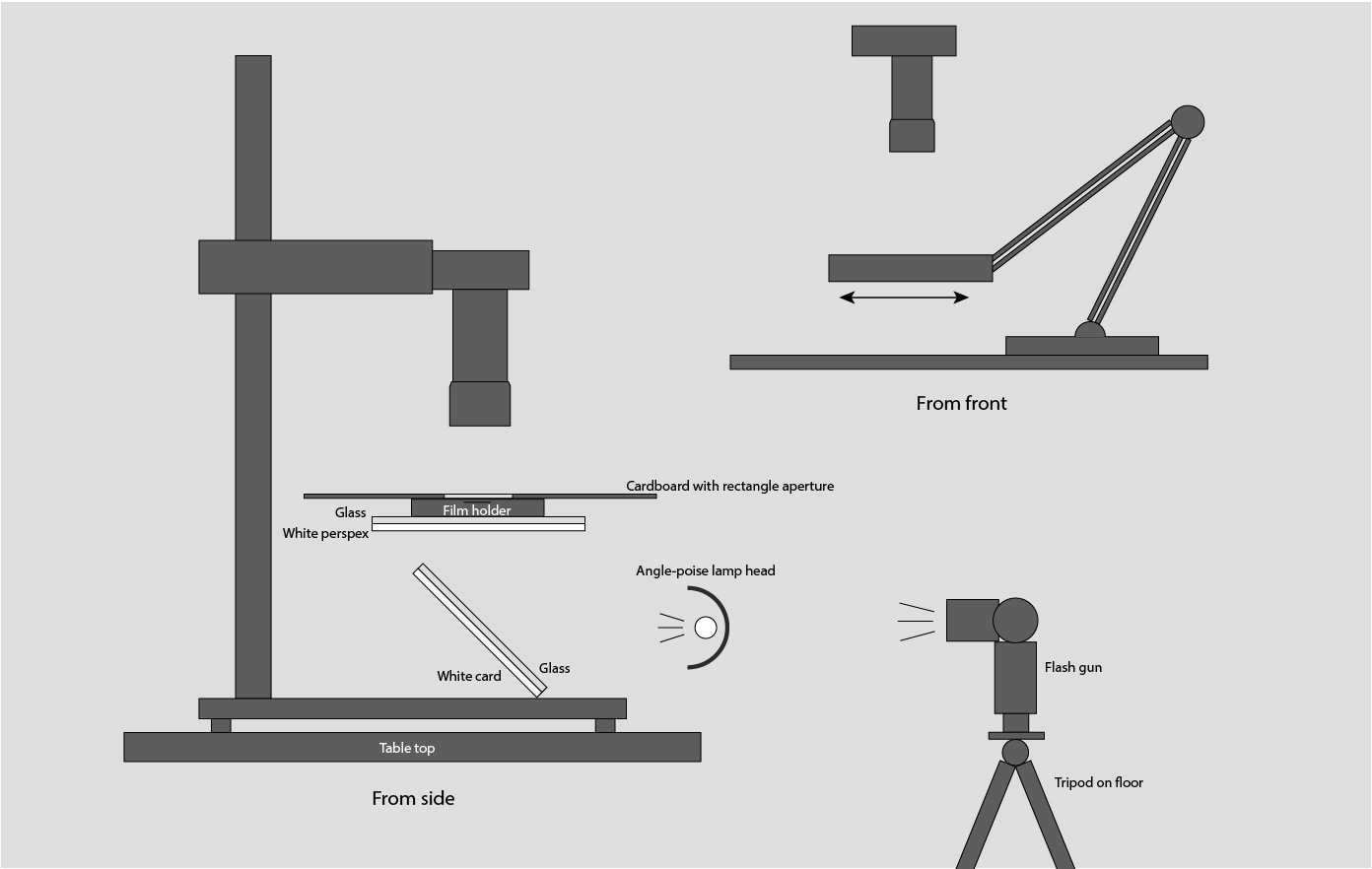

In response to the opening post:
When I have digitized film at home, I used a flash setup. It was just a test setup to see how well it worked, so it was fairly make-shift and unstable, but it certainly proved that it could work successfully if I took the time to develop it further. I include a diagram above to give you a rough idea of the setup.
A basic description:-
Kaiser copy stand with Canon 5DS R and Sigma 105mm OS macro lens and hood.
The camera was connected to a laptop using a USB cable to enable live view and camera control via Canon Utilities software.
The film was held with enlarger negative carriers of various types, supported on a sheet of glass, with white perspex diffuser underneath. The glass was used to provide a more stable support than the perspex.
Beneath these, I used some white card with glass from a small picture frame resting on it, both at 45 degree angle.
The flash was on a stand/tripod pointing horizontally at the 45 degree glass. The distance was varied somewhat to control exposure (it was an old flash with rudimentary power control), but it was never less than around 40cm from the glass.
The continuous light source was an angle-poise lamp with a daylight-balanced fluorescent tube. This was positioned on the table in such a way that it could be moved into the light path easily at any point for focusing.
The room was a garage with very low light levels.
Resting on the film holder, I used a piece of card with a rectangular aperture in the centre. This blocked stray light from around the film holder, as well as shading the lens from a direct view of the flash.
How well did it work?
In terms of getting even illumination for the images, it worked extremely well. Almost no variation across the frame on all formats (I tested carefully) up to 6x7cm. No reflections or stray light of any significance.
The continuous light setup worked 'well enough'. Moving it in and out of position was a minor inconvenience. It was 'bright enough', but more light would have been better.
In terms of colour accuracy of the flash light, the jury is out. I had some concerns that I was getting some colour distortions in the images. I think that these were more likely due to the camera profiles used in raw conversion, but I can't be sure.
Overall, my actual setup was far from perfect, but by far the biggest problems were with keeping the film in focus across the frame, because nothing was 'locked down' properly, plus the (fairly minor) colour issues I mentioned. Evenness of illumination was, as far as I was concerned, fully resolved.
Hope that is of some use to the OP. Happy to answer any questions about it.

Very interesting! Thanks for posting that! Similar to what I had in mind, but yours has some additional intriguing details. It never would have occurred to me to use both paper and clear glass for the reflector. Is there some rationale behind that? Did you test it, paper-only vs. glass only?
One question, in the Front View, what is that parallel-dog-leg-looking object that seems to be acting as stage for holding the film?
The 45 degree glass and card combo - this was partly just what I had available, but it worked well. Using a specular-reflecting surface like glass or a mirror should mean that 1) there is no fall-off of light due to distance across the film frame area, 2) that light is transmitted more efficiently to the film compared to a diffusing surface (less light is lost).
In this case, it's a combination of specular and diffuse, because the light which passes through the glass reaches the card, at which point it is reflected in a diffuse manner. I thought that this would work well because most flashes don't have a completely even spread of light, and thought the diffusing portion would help to mitigate any variations. However, my choice was partly due to not having a mirror of suitable size! I suspect a mirror would have worked pretty well also.
I'm not 100% sure whether I tested it with card-only or glass-only, but I'm pretty sure the combination is better.
Sorry I should have labelled it! The dog-leg-looking object is an angle-poise desk lamp. It's just something I had available which allows the lamp to be moved in and out of position easily. It has a base which I had sitting on the front edge of the table to one side. The horizontal part is the head containing a daylight fluorescent tube, which when in position, points towards the 45 degree glass. To be honest, I could probably have positioned this slightly above or below the light path from the flash and just left it in place, but I was worried that it may cause some unevenness of illumination from the flash.
One alternative would be to replace the 45 degree card with a diffusing material and have the continuous light source behind that. That way it could be left in place without any chance of it interfering with the flash light path.
