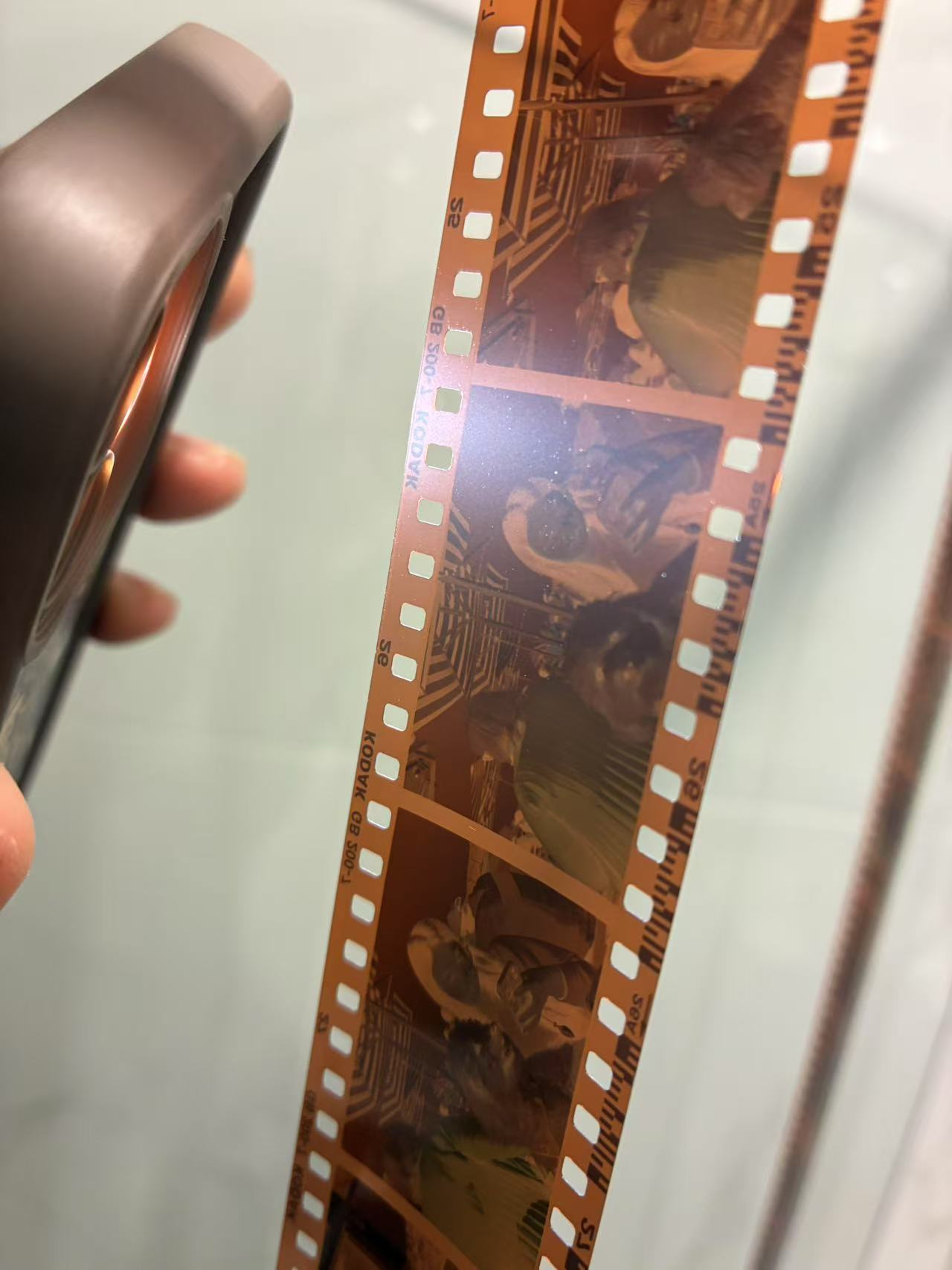

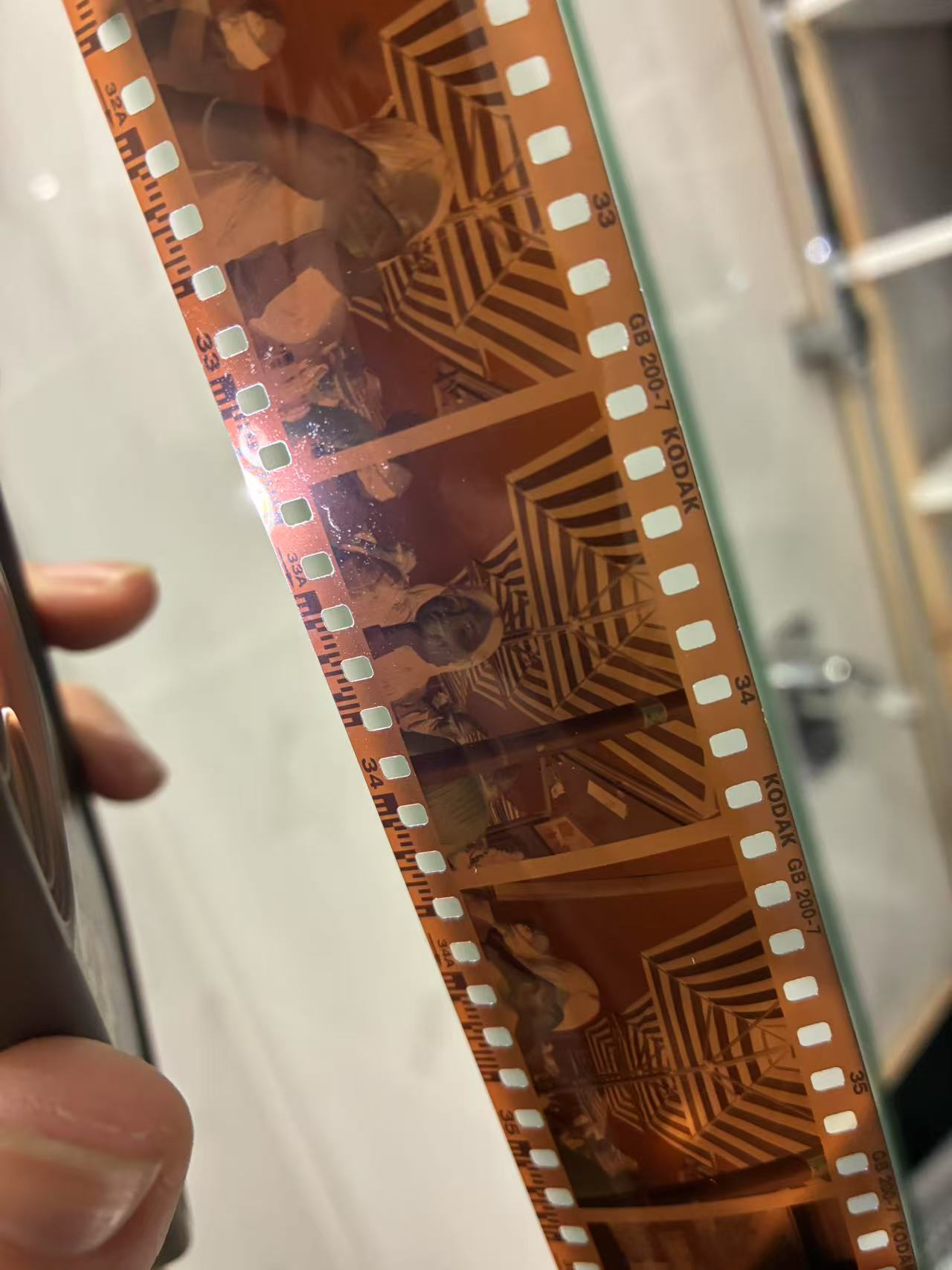

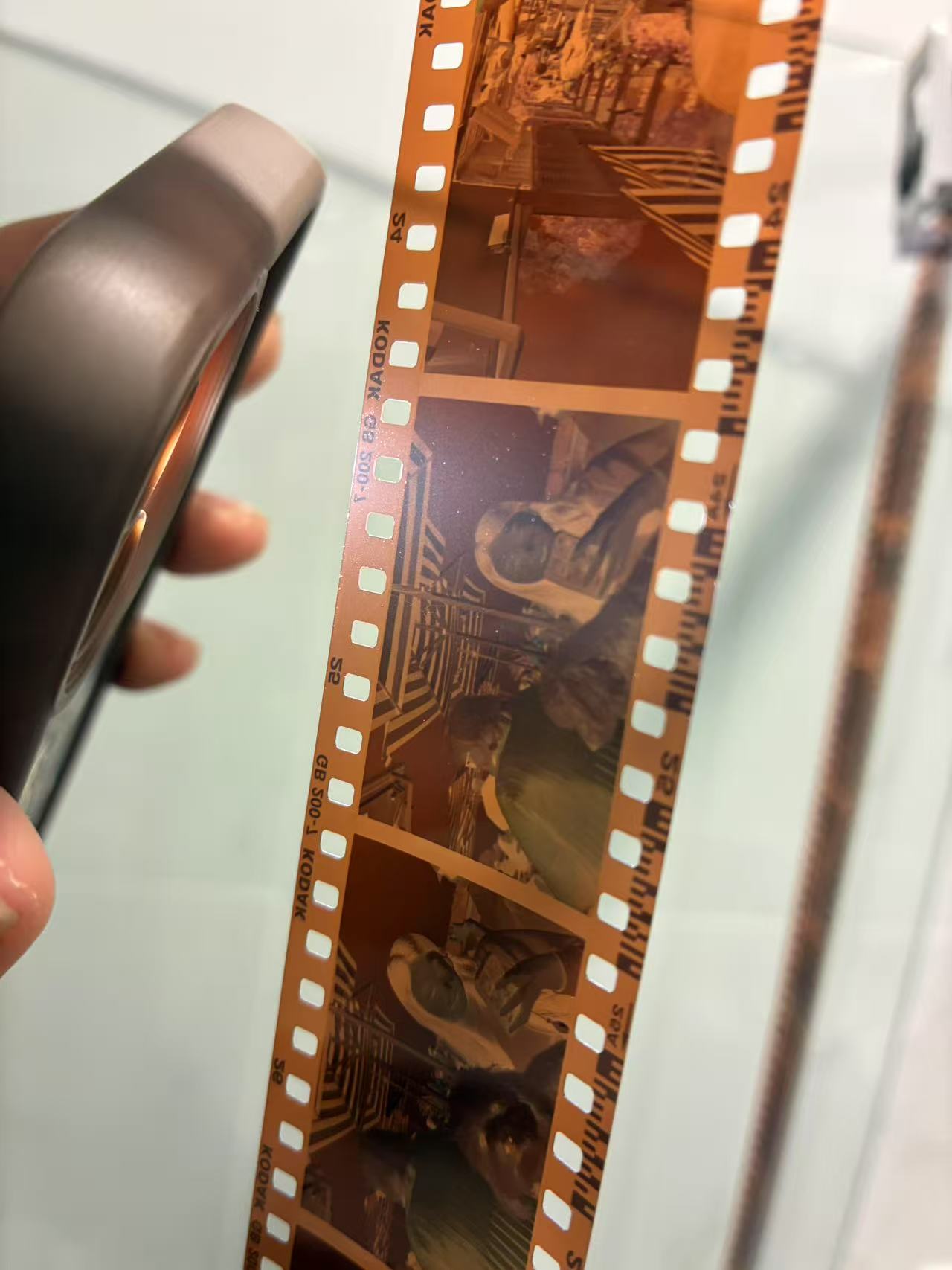

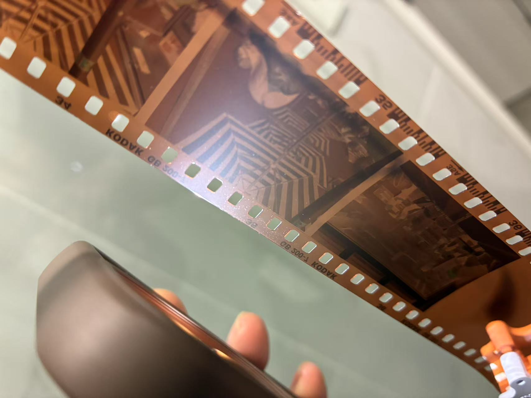

I used the same method again, with fresh chemicals and unexpired Kodak Gold 200 for a quick test. I processed it using a Nikor stainless steel tank following the Ilfcolor instructions: 3 minutes 15 seconds for development, 6 minutes 30 seconds for bleaching, and 4 minutes 20 seconds for fixing. After pouring in the bleach, I accidentally dropped the cap, which caused a delay of a few seconds before I started agitation. For the final wash, I used filtered water at 30°C with the Ilford wash method, extending it to 8 cycles. I finished with Photo Flo and distilled water for the final rinse. However, some speckle-like spots still appeared and could not be washed off, even after trying to clean them with ethanol. There are some of these speckle-like spots on both the emulsion side and the base side, with the base side being more obvious and severe.

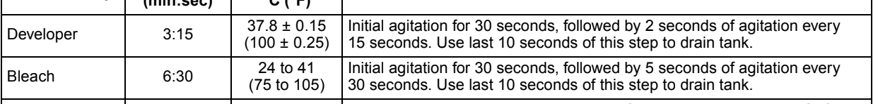

The agitation method I used was Kodak’s C-41 manual processing method.

I noticed that after development, these spots tend to cluster around the edges of the frame throughout the entire roll. I tried wiping them off with alcohol but it had no effect. After re-bleaching and re-fixing, these spots became evenly distributed across the entire image area. I suspect this issue might be related to the quality of the bleach or fixer.
Well, if that's the case, I'd put my money on the fixer rather than the bleach. But in the first try you mentioned you used fresh bleach that wasn't used before. I don't see how that would throw down this precipitate.
Did you try soaking a strip of film in a weak acid solution and then wash it again?
Under reflected light, these marks look more like indentations or signs of corrosion. I could try using Ilford stop bath, but I don’t think it would help much.
It would be the first time I'd see something resembling corrosion or pits on C41 film. It's most likely little bumps that look differently due to a trick of the light.
Try the acid soak, see if they disappear.

Looking back, I think the only possible issue was that I didn’t stir the chemicals long enough during mixing. Also, during the bleaching stage where I was supposed to agitate for 5 seconds every 30 seconds, I probably only agitated twice within 5 seconds.
I don't think either of these factors explains it, really. The mixing issue would only be an issue if you started with powdered chemistry and it somehow wouldn't dissolve. But C41 chemistry typically comes as liquid concentrates, so it's already dissolved. Agitation certainly isnt' a cause for this.
