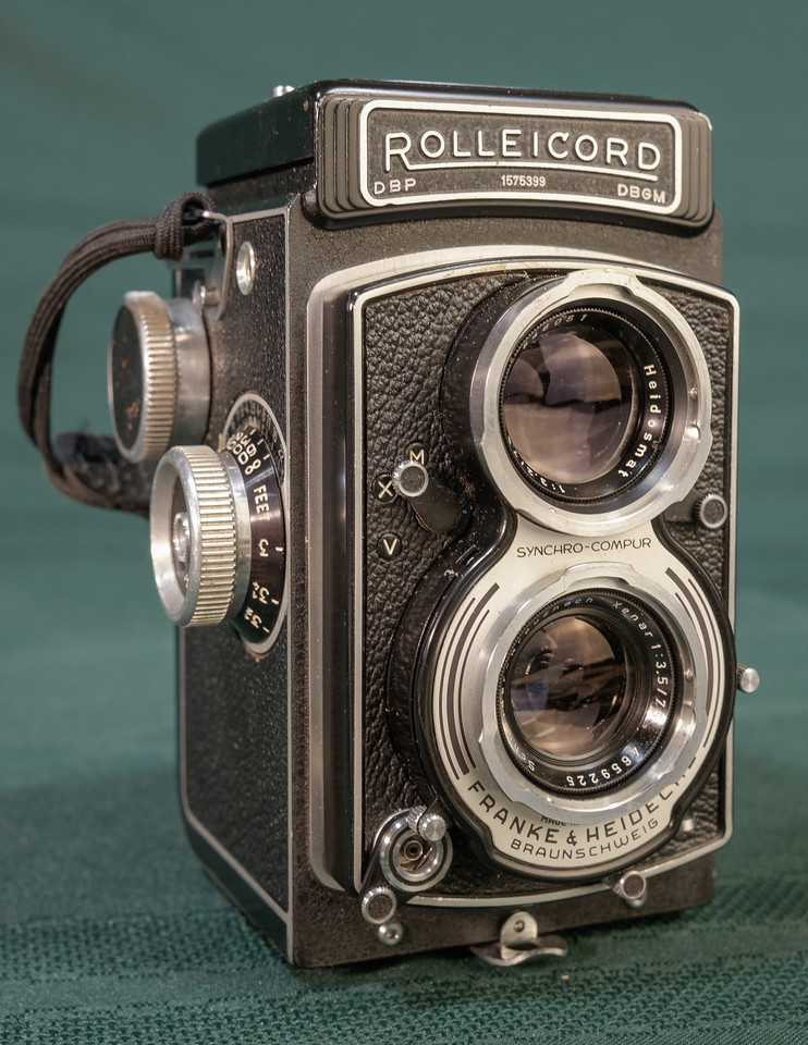

I was able to use my new Rolleicord V to take a few shots today. (click on the photo above if you want to see more)

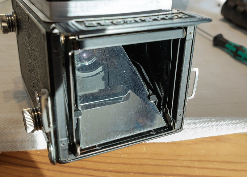

Below is a photo of the mirror. The streaks on the mirror glass were made by a soft hair brush I use to dust off negatives. Not sure what kind of haze it is, but seems to be slightly oily(?) After I finish the test roll, I think I will try to clean the mirror. If I screw it up, hopefully a replacement mirror will not be too expensive(?)

I removed the viewfinder from my Rolleicord again today and cleaned some film / haze off of the mirror. I don't know what it was, but it cleaned off pretty good. I will shoot another roll before I decide if cleaning the mirror made it any easier to focus, or if I still want to get a third-party focusing screen.

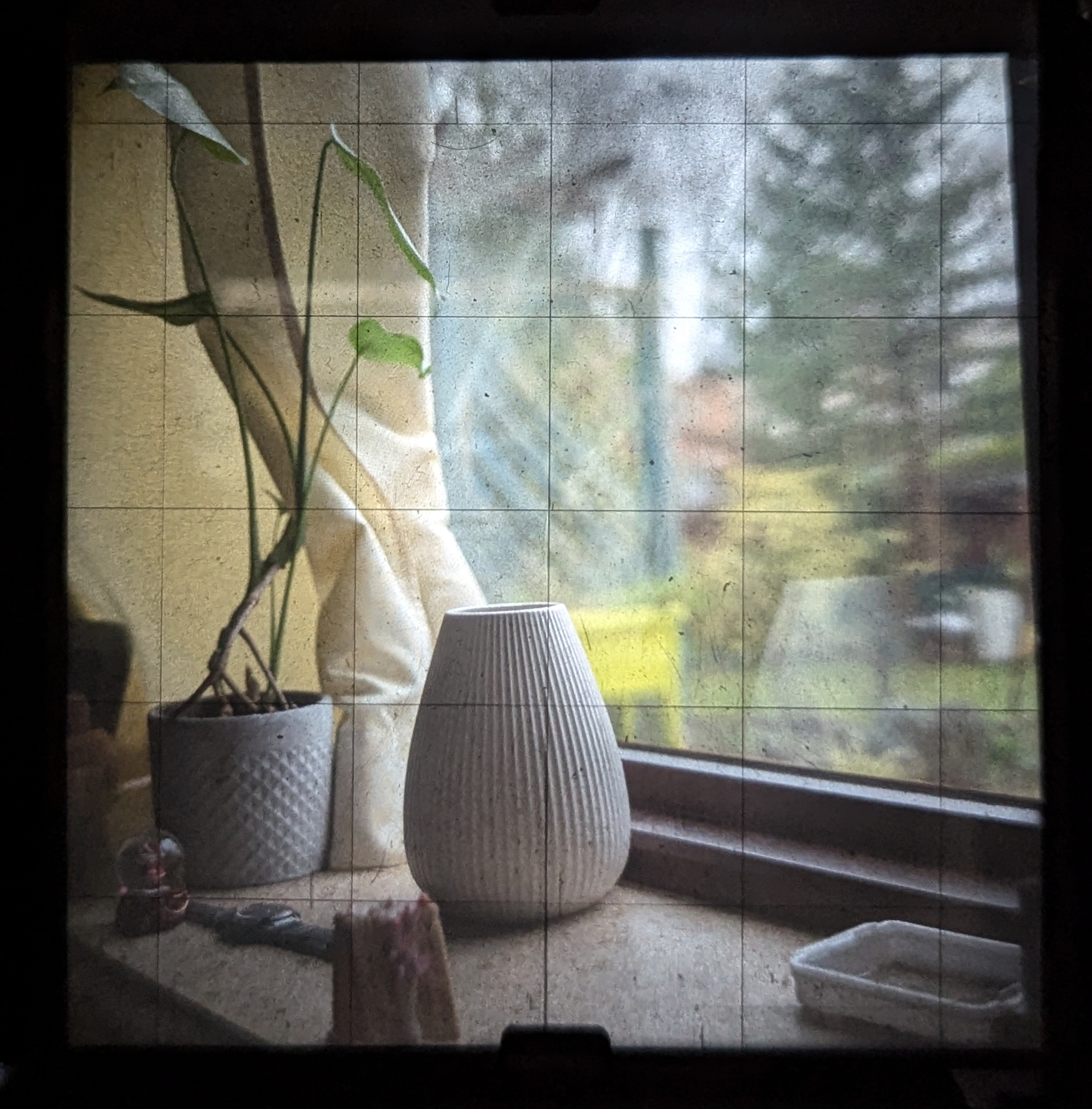

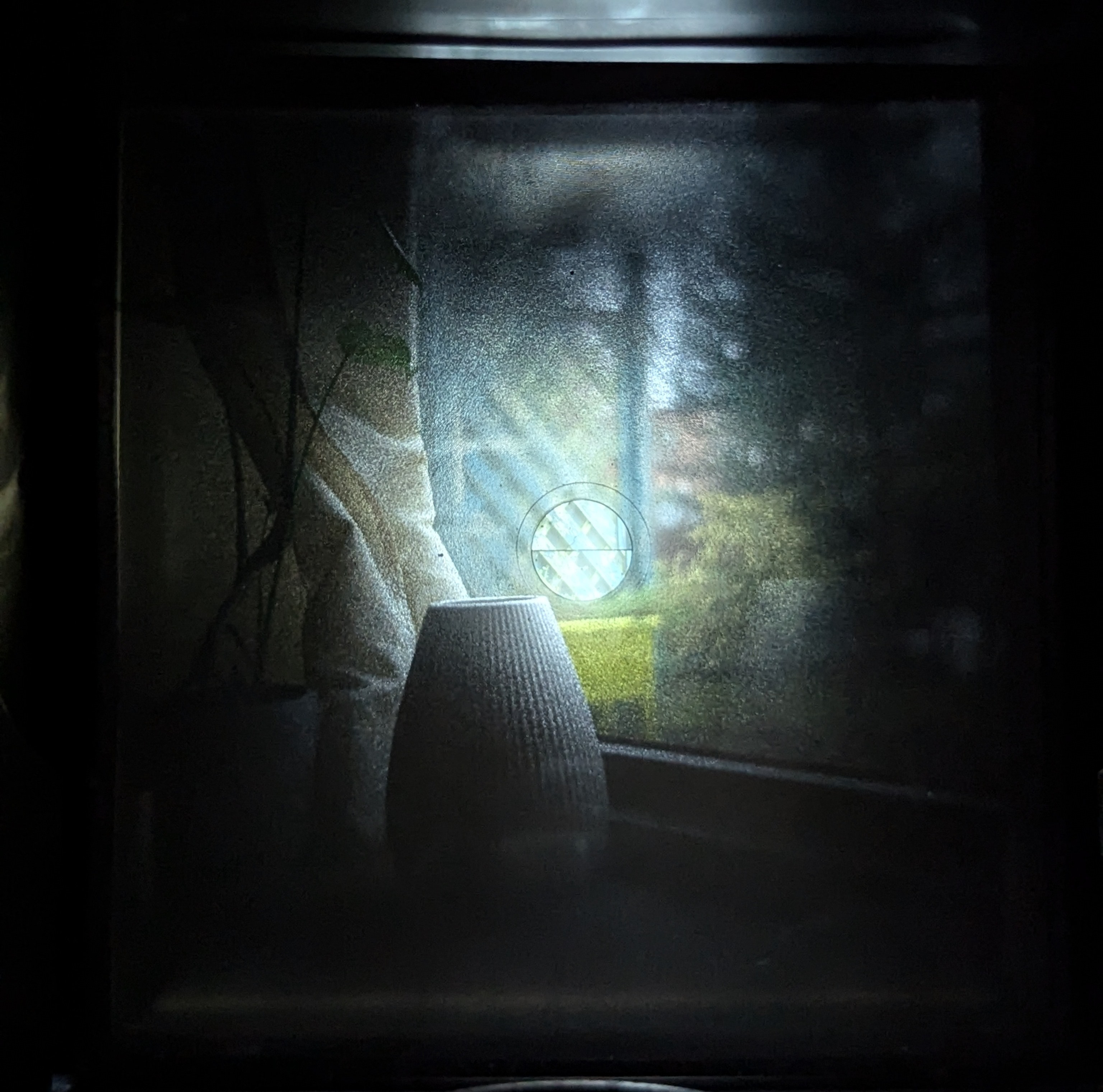

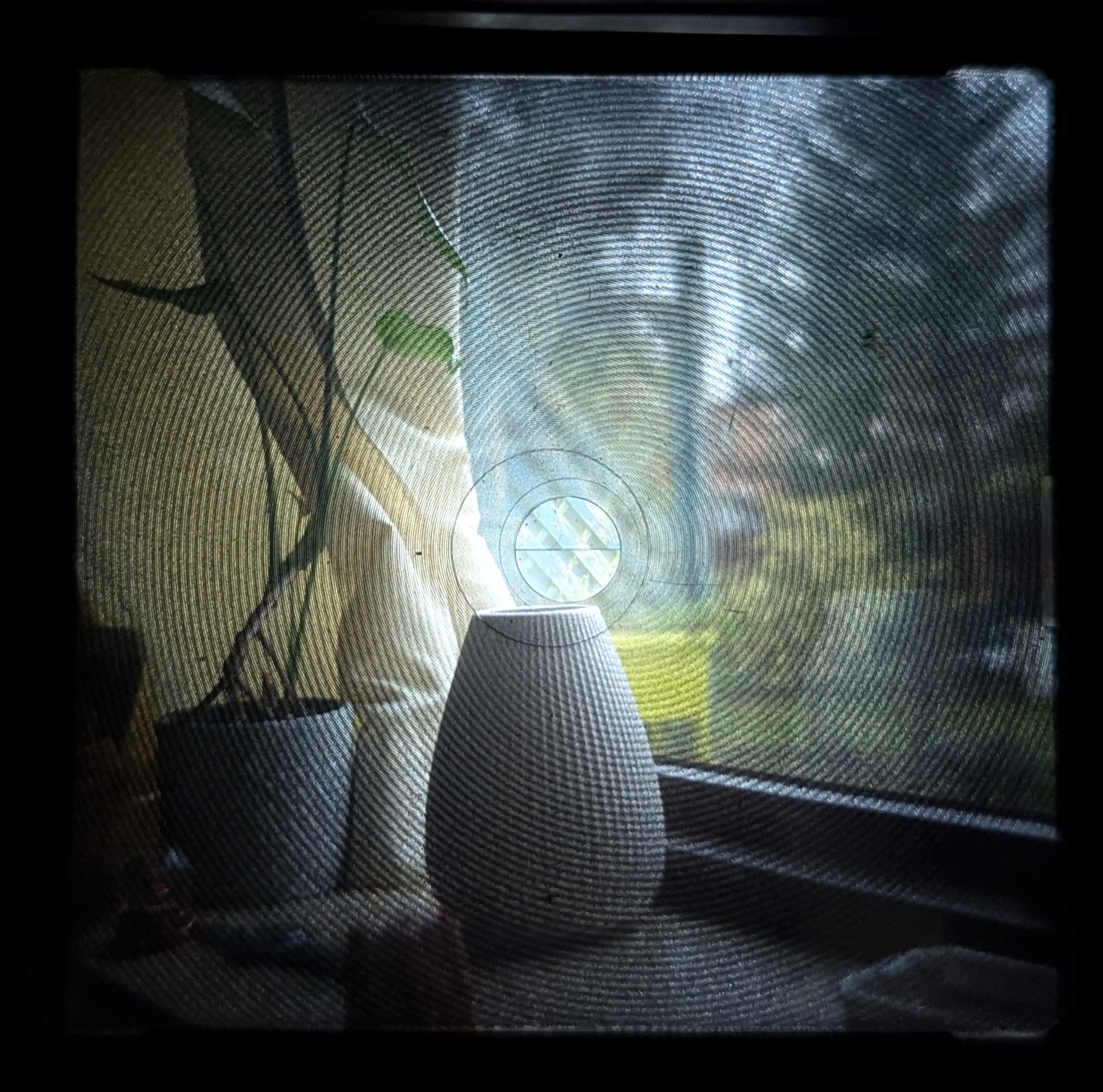

Rough comparison between after market screen with and without Rolleigrid vs Original Rolleicord Va (I presume it's original)
1st is original Rolleicord Va, 2nd after market with Rolleigrid and the 3rd without Rolleigrid.
I have removed the original ground glass and I presume it will be even darker.
Very cloudy day here...just for info.

I just want to show the difference between the usage of Rolleigrid with the after market screen. Many years ago I bought this screen and it is equally bad as original ground glass of Rolleicord II. That said, I have Rolleicord Va and Rolleicord II.
Now I have no idea whether those after market screens have improved in the meantime.
Atleast in the screen in my Rolleicord Va is brighter and uniform and lets see what other owners of Va can say about that...
My second question: Your photos seem to show the aftermarket screen resulted in a dimmer viewfinder (compared to the original), which is the opposite of what I would expect. Has it been your experience that the aftermarket screen is not as bright as the original screen in your Va? And if so, which brand of aftermarket screen?
yes, my after market screen is terrible. I left it because of split-image and use occasionally rolleigrid to see what's across the frame and its not so pleasant to shoot that way.
