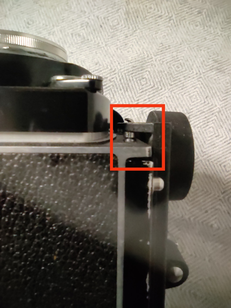

Found a Rolleicord Model V on eBay for an affordable price (I guess). Looks like a typical eBay seller who dabbles in a few cameras in addition to the regular eBay junk -- so not a camera specialist. He does not say if it works or not, and probably does not know.
There is one possible pecularity with the camera, so I wanted an expert opinion. Here is a screen shot from one of the sellers photos. Look at the top of the pressure plate (below the "VPS 120" sticker), where it says "24 x 36mm" and "1 x 1 1/2" Is that writing normally visible on all Rolleicord V cameras -- perhaps a setting to be used with a 35mm accessory?

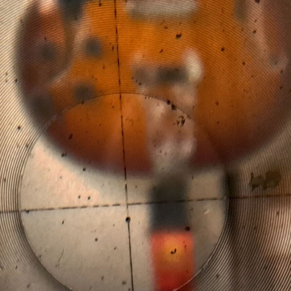

Another photo shows the dirty viewfinder, and what appears to be a focusing screen that is different from the original, right?

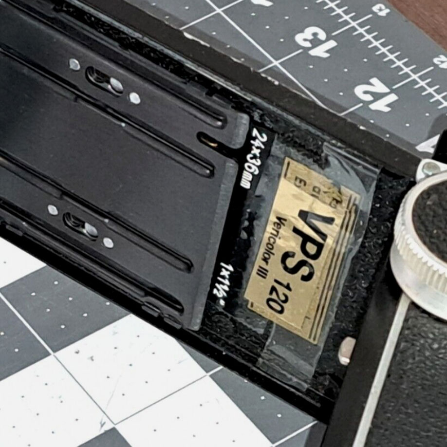

The pressure plate can be moved up and down for 120 film, 6x6, or 35mm film using a Rolleikin adapter. The pressure plate is in position for 35mm film. Press it down and slide it up and you'll see the 6x6 label at the bottom.
Looks like it might have a Rolleigrid Fresnel screen dropped in. This went on top of the ground glass screen. The Rolleicord ground glass has two lines that meet in the center, so I bet this is the original screen, with a screen on top. This will brighten the screen and even out the light. Not as good as a screen like an Oleson, but certainly an improvement over plain ground glass.

@Dan Daniel - thanks for your information about the Rolleicord V screen.
@baachitraka - good to know. I doubt I will ever use a flash, but you never know.
There is another seller on eBay with Rolleicord V that is a little cleaner than the one above, and he has film tested his camera and he shows photos of the test roll negatives. It was only $30 more than the first one, so I bought it.
Good move IMO....that $30 is quickly forgotten w a cleaner camera that works as advertised.

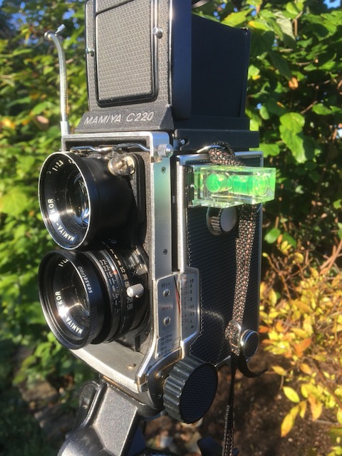

There is one accessory I got for the Mamiya which I really liked. It is a little plastic spirit level that helped me get the camera level. But the level attached to the Mamiya's flash shoe, which the Rolleicord does not have :-(

Please do not modify the Kamera to accommodate this spirit level or cold shoes.
Rather use tripod for levelling.

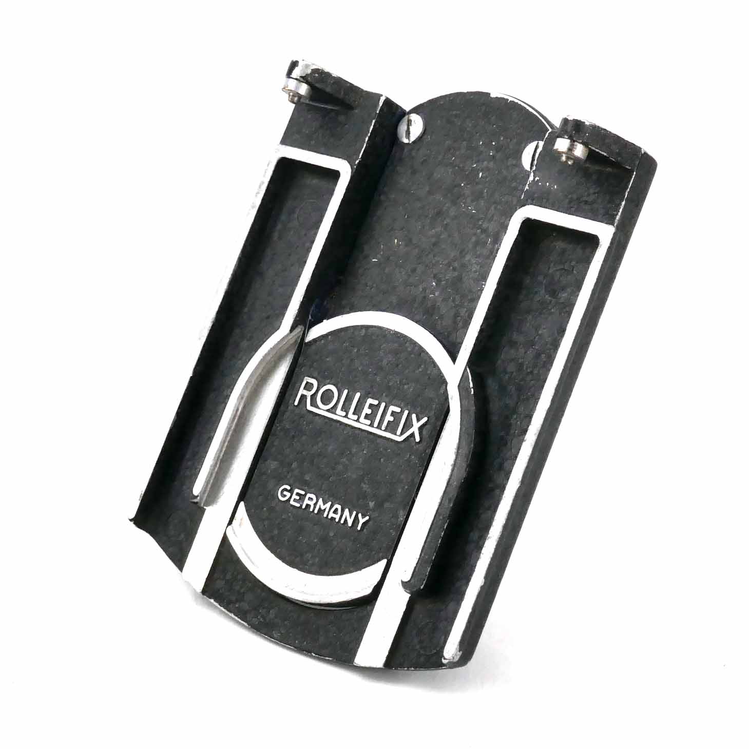

One accessory that is handy to mount the Kamera on tripid is Rolleifix.

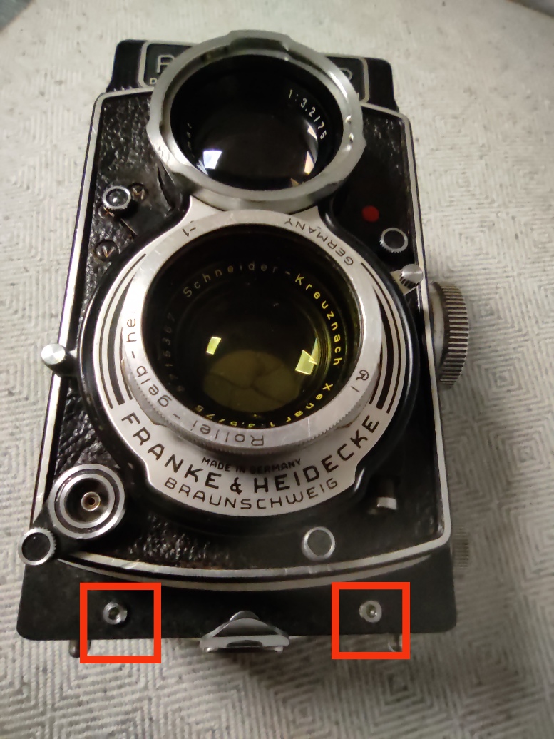

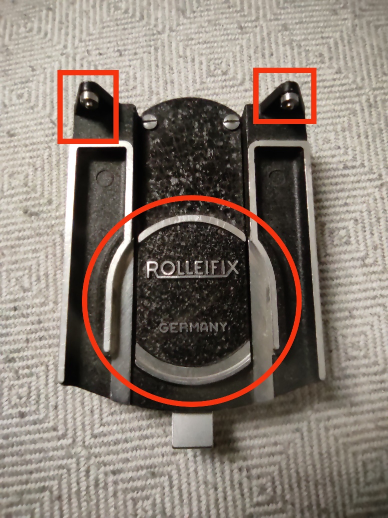

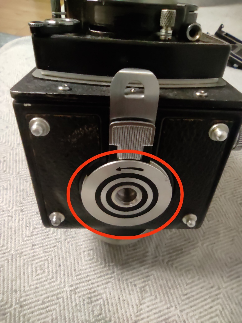

I don't get it. What is it? Apparently to attach the camera to a tripod (?). But why would I need this as opposed to simply using the camera's built-in tripod mount?
I have one of those gadgets too. I think the idea is that too much torque into the camera's built-in tripod mount might, in the long run, end up warping the bottom portion of the back door. At least this is what I remember, happy to be corrected of course.
I never use mine though, as I very rarely use a tripod and the Rolleifix' thread hole is not compatible with my tripod's head screw (the hole is much larger).
Thanks. With the Mamiya C220, I did use the tripod -- a lot. Sometimes it was very annoying to set up the tripod, but once setup, I was able to control my framing and focus more precisely; especially so when using the level. Then again, sometimes it was a relief to leave the tripod in the car and shoot unanchored.
I believe I did read somewhere that Rollei uses a 3/8-inch threaded hole for their tripod mount, which is less common than the 1/4-inch size. There are threaded bushings available that reduce the 3/8 bore to 1/4-inch, which I already have.
@runswithsizzers I see you're leaning back into the TLR territory and this makes sense, due to Mamiya's weight. However, if you ever think again about a perfect folder I suggest looking at Agfa Super Isolette. I have a Soviet clone of it (Iskra) and the viewfinder is gorgeous. Solid build. No red window. Easy framing and focus. The only problem with Super Isolettes is that they are rare and serviced copies are closer to $1k. :-(
The Mamiyas come with the same 3/8-inch tripod mount - except they tended to be sold in many markets with the removable adapter already installed.
I actually prefer using the quick release mounting plates with 3/8-inch connection screws - I just take out the adapter - but you always have a choice.
I feel always safe with Rolleifix when mounted on a tripod.
There is an adapter 3/8 -> 1/4
Any of the quick mount accessories - whether specific to a particular camera or generic and usable with many cameras - make tripod mounting a camera quicker. They can also improve the mounting process in certain ways - for example they might help prevent the camera from twisting on the mount, or make it easy to use multiple cameras with the same tripod setup, or swap a camera quickly from tripod to various grips. They are very useful when you work in a fast changing environment, like a wedding.
The Rollei aficionados will probably chime in, but I seem to recall as well that the Rolleifix also helps protect some of the cameras from being damaged in heavy use - the camera backs (IIRC) can be vulnerable to damage if abused, and the Rolleifix helps prevent that.
I use Manfrotto quick release plates with all my cameras and all my tripods and my monopod have heads that accept them. They make switching from camera in hand use, to camera on grip use, to camera on tripod use much quicker and easier.
The Rolleifix does something similar.
Rolleifix is a bit better and together with QR plate things are much easier.
How secure is the camera with Rolleifix (a well known story) with photos...
