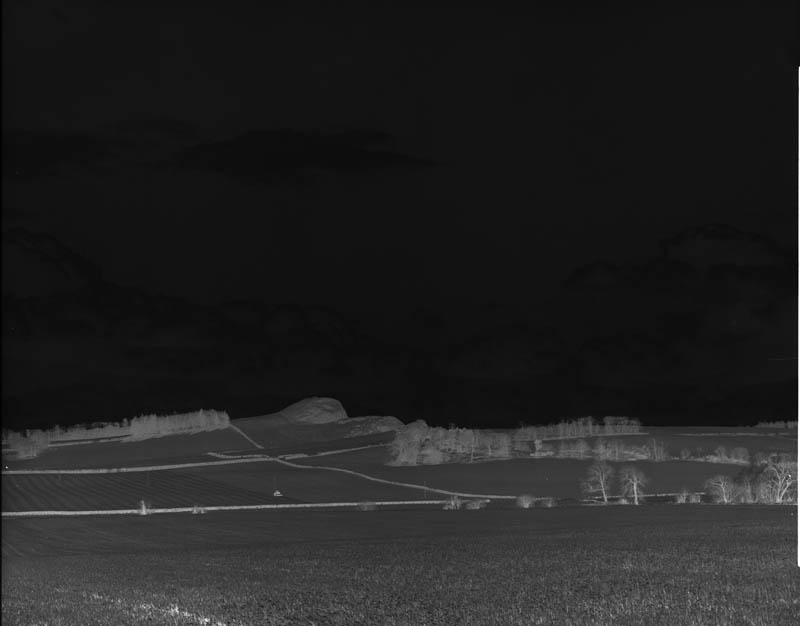

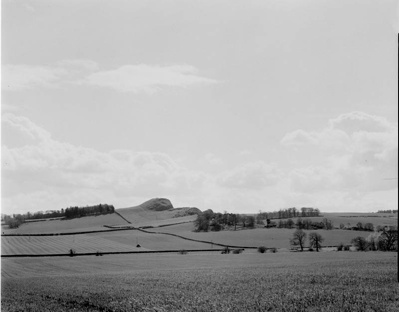

Here's a scan of the negative...
And the image inverted...

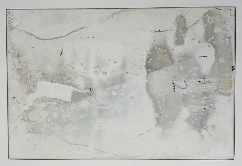

And here's the plate that resulted...
The negative was placed towards the right-hand side, so the dark stuff to the left is fogging from the lamp, through one layer of glass. This was a latent image. As with the wet test after making the albumen mix, the bits looked quite dark under the UV lamp, but still had the pale yellow colour when the room light was switched on for a moment after the UV exposure. Definitely no printing out.
The plate was developed in the Gallic Acid for about half an hour, with not much agitation (I got bored swishing it about after 10 minutes or so, and saw that the fogged area was starting to darken, so went for a break).
The photo of the plate was done using an LED lightbox and a cellphone. The only tweak was to adjust the colour balance (the white areas came out quite blue in the phone). Nothing else other than resizing.

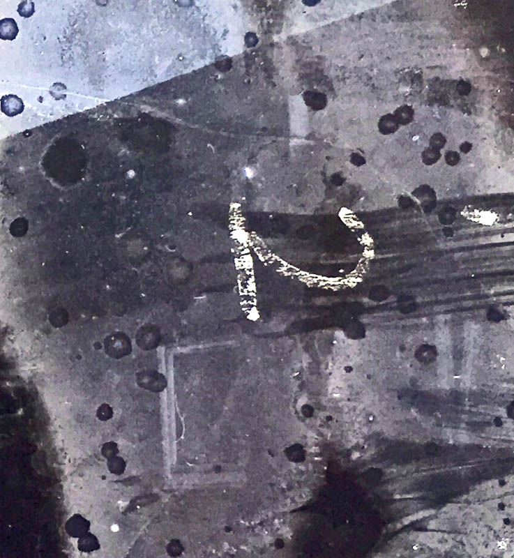

...and a 100% crop with no tweaking of the cellphone image to get a better look at the blotches...
Opinions on the blotches would be appreciated. Dust?

Did you filter all materials using a fine mesh gold coffee filter? If not, dust and "bubbles" of material may remain in the material when coated.
Then too, you have discovered how difficult it is to coat these materials and get a uniform coating.
PE
No, I don't have one of those - I'll look out for one. The blotches were evident on the albumen before sensitising. I did try filtering it through a filter paper, but it was desperately slow, so I ended up using a couple of layers of muslin, which was probably too open (went through very quickly), and may well have added some particles of its own. Just after coating, while they were still wet, I noticed some dust had landed on them. When I coat another plate, I'll cover it while it dries to see if there's anything in the liquid.
They were sensitised by immersing in a bath for about one minute. Gentle rocking motion, then lifted out a put into a bath of plain water (tap water). As I mentioned earlier, the blotches were visible on the albumen before sensitising (although I dare say more could might have been added later).
Very cool that you got ANYTHING on your first try. That's excellent!
This kind of latent image development usually needs some aceto-nitrate of silver added to the gallic acid, like mentioned in the instructions you linked to.
If you have an eyedropper, you can add a little at a time ( like 1/2 ml or even less ), then let the plate develop for 5 or 10 minutes, see if the image is intensifying, then add a little more if it's going too slowly. I think the only way to know for sure what a good plate looks like will be when you try to print them, but I think with some experience you will figure out how fast the image should appear and how dense it needs to be at the end to produce a plate that will print well.
Can't wait to see more!
So you did end up doing "dunk" sensitization. I was trying to figure out why almost all of the botches are darker - meaning they probably had higher level of silver halide - than the rest of the area.
Not bad for a first try on a brand new process, by the way.

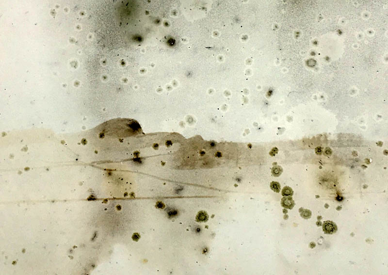

Just developed plate 2. This was exposed in the camera for 45 minutes at the fixed stop of f/22. Early evening, quite sunny, weather web site said UV index was 1, which is pretty low. Here's the plate on the lightbox...
Not much to see, and I thought I had nothing while peering at it under safelight, until I saw the diagonal delineating a difference in density which wasn't related to my uneven coating. That's a roof line. (The perspective is receding to the left.) Positive image...
It's probably difficult to see what's going on here, although easier for me because I know what the subject looks like. If you look in the area where the digit 2 is written, there's a lighter feature down and left of it. This is a window frame. Here's a crop of this area with some enhancement...
The window frame is quite clear, now. Also, in the dark roof occupying most of the upper half, it's possible to make out some horizontal linear features which are the lines of tiles on the roof.
The development process for this was the same as before - half an hour, with some swishing about for 10 minutes or so before being left. This plate is a bit thinner than the contact printed one, which suggests that I would perhaps need more exposure in that particular light to match that achieved using the UV lamp. (I'm hoping to be able to use the lamp as a way of characterising the sensitivity such that I have a guide for my exposure estimates with the camera.)
I clearly need to work on the coating technique - it's very uneven. Next time, I think I'll pour more albumen on and try tilting the plate to let it drain. I'm still not sure if the stuff is viscous enough. The better-exposed parts of both plates were where the albumen was thickest, and I'm wondering if letting the plates drain will result in an overall thin coating. I'll try it and see how it goes.
The other thing to do is try to track down what's causing the blotches. Since I suspect it's dust that's settling on the albumen before it's sensitised, I'll see what I can do to mitigate that, perhaps with some sort of cover.
On the plus side, the basic proportions in the mixtures seem to work, and my guesses for exposure weren't too far off (close enough to have an empirical reference to work from). Both plates are very thin, so I need to gradually work towards getting better density. I think the first step with this is to see if the coating is also thicker as well as more even. If it is, then I should get an improvement in density, or at least get the better density that I have so far over more of the plate.
These are probably technically the worst photos I've ever made, but they are rather satisfying nonetheless. :smile:
