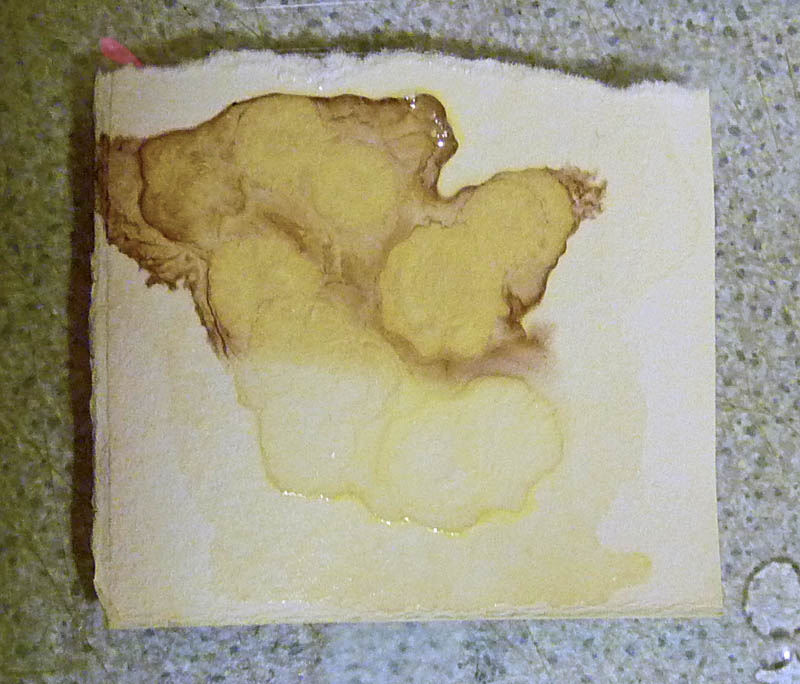

I took the dregs of the albumen mix that was left in the beaker, and smeared some on a scrap of 100% cotton paper. While it was still wet, I put a few drops of my existing sensitiser (100ml 10% solution Silver Nitrate with a drop of 7% solution Potassium Dichromate) onto this to see what would happen. Almost immediately, there was a pale yellow precipitate. Some reading indicates that this is Silver Iodide, which I believe is a good thing.
I then darkened the room and switched on a UV lamp (one of those Black Light Blue 11W fluorescents). The area wetted with the sensitiser showed up dark - a very dark violet colour was how it looked. I then covered half of the sensitised area and left the UV lamp next to it. After about 10 minutes, it had started to darken, albeit somewhat unevenly. The colour of this in the room light looks to be brownish.
A couple of photos...
This is the test piece after about 15 minutes or so under the UV lamp. The bottom half has been covered with a little bridge of the paper so that I have a comparison. The pale yellow precipitate can be clearly seen. It's interesting that the darkening seems to be around the periphery of where the drops of Silver Nitrate landed - the middle parts are still yellow (and a stronger yellow than the middles of the shaded drops).
Here it is under the UV light...
The whole area that was wetted with the Silver Nitrate shows dark. This was the case as soon as it was wetted, before there was any visible darkening as seen in the first photo.

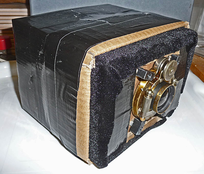

The main thing this weekend was to make the test camera. After some mooching around, I managed to find two cardboard boxes that were just about the right size, both to fit a plate, and because they slid into each other (they were for something that was delivered double-boxed, I think).
Here's the front...

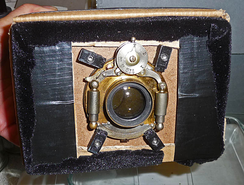

The lens is an old Bausch & Lomb thing I picked up years ago (patented 1891, apparently). Pneumatic-damped shutter with a T setting. I reckon it's about 5" focal length. The iris blades aren't much use - they were loose in a separate bag, one is missing, one is bent, and one has lost one of the little pins that make it move when the aperture is adjusted. The elements unscrew, so I made a stop for it...

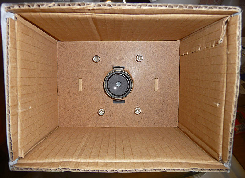

It's about 5.7mm diameter, so about f/22. The length of the inner box is about right for hyperfocal distance at this aperture. It slides into the outer box and presses against a plate at the back...

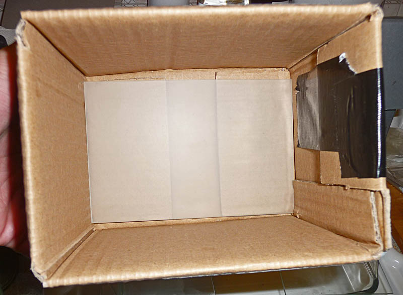

That's a ground glass that was made for practice, and to check that the fixed focus was about right before fitting the stop. Here it is in all its glory...
The velvet around the inner box is a light seal. Before I fitted the bit of board holding the lens, I looked through the square hole in the front of the box and could see leaks coming in between the two boxes, and the velvet removed them. I might paint the inside black if the inclination takes me.
The main purpose of the camera is to try and replicate what might happen with the eventual 10x8 setup. I'm not too bothered about image quality (the plate is probably not terribly perpendicular to the lens axis), but I will need to characterise, and possibly adjust, the process in terms of sensitivity, and that will be done better if the light is passing through a lens (or being attenuated by the glass in the lens if it's UV). This should give more relevant results than something like contact printing a 5x4 negative onto a plate using a UV lamp.
