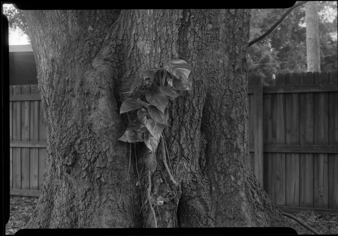

I seem to have dialed in the exposure and developing time for my Foma 100. I exposed at ISO 50 and developed for 7min at 76F (room temperature).
Now that I got the exposure down, I'm really impressed with this film. The tonality is great, dries flat, emulsion seems pretty durable.
The biggest downside is, in my opinion, its reciprocity characteristics. If your meter is recommending 5s, you're going to be giving it 30s.
I'll take that tradeoff though for its low price!

saman13 that’s a very satisfying picture. I think you could have developed longer not as a criticism but just saying “right” is right... because I think you have nominally developed correctly... But some low contrast scenes can look like there was more light when developed longer. And that’s the kind of experiment you can try with scenes like this.

I'll gladly take any advice on how to improve my photography!
So, correct me if I'm wrong, but you're saying increase the development time because that will increase the contrast in the image? I thought that the way to do that would be to reduce exposure, then maybe also increase development time. But you're right, this scene is a little dark. Could probably be a little brighter with higher contrast.
Bill Burk
Feb 9, 2010
9,461
Yes developing more will directly increase contrast. But with the proper exposure the result can be a full and rich image.
Underexposure and developing more and using high contrast paper also increases contrast - a proper esthetic for street, night clubs and concert photography, but without satisfying detail in shadows that helps nature photography.
saman13
saman13
Mar 28, 2017
365
Sarasota, Florida
Good to know. So, say for a scene like this, expose "normally", then develop ~10% longer?
Will that not just give me a denser negative? Raise both shadow and highlight values?
Bill Burk
Feb 9, 2010
9,461
About 10% longer sounds fine. Shadows are not much affected by longer development, and the rest of the scale increases - think of a straight line that gets steeper.
I really think a lot of people develop less than they need. It technically makes better negatives in terms of grain and resolution. But if your photography doesn't depend on the absolute pinnacle of resolution and fine grain... developing longer gives you a richer range of tones to work with.
Don't take my word for it though. Your negative is perfectly fine and you can print on higher contrast paper if you believe it will help.
But experiment and find out what you really prefer.
