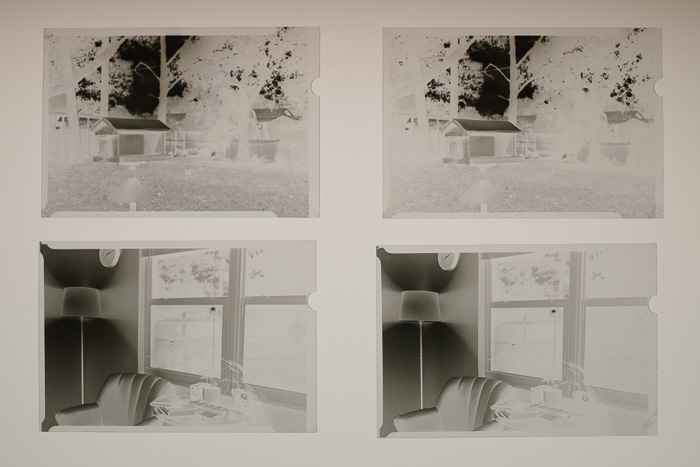

I just developed four sheets of 2x3 Arista EDU 100 film that I shot to test what EI I should shoot the film at and get an idea of development times. Well, I got some thin negatives. Usable, but definitely thin. So, how do I know what I need to change: Exposure, or developing times?
I shot two scenes, one metering as ISO 50, the other metering as ISO 100. 50 is on the left and 100 is on the right.
50 definitely has more shadow detail. Both still have highlight detail (can see the clouds in the sky in the negatives). Don't know If that shows up too well in the scans or picture.

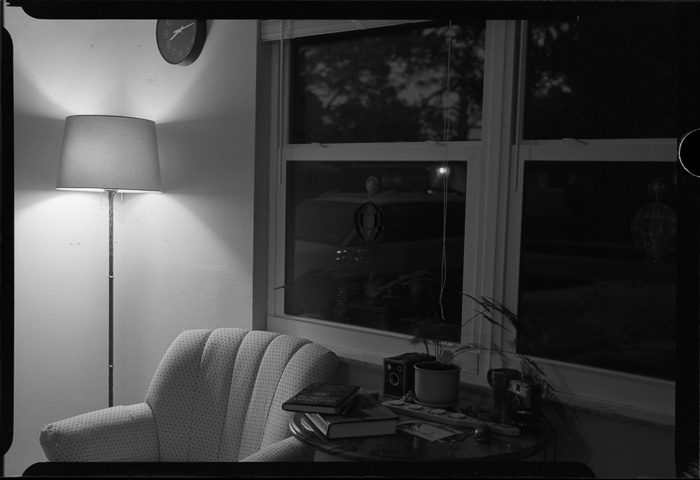

Here are the scans of the negatives shot at 50 with minimal post. Just adjusted curves slightly and didn't adjust the brightness (exposure).
They actually scanned pretty well (not sure if that means they'll print well, I'm new to scanning), and I could probably make them look decent with some time. But, they're thinner negatives than any of my others (FP4 and HP5 mostly) so I want to get them to a similar density because I have my printing of those pretty dialed in.
I'm thinking I just need to increase development time by a minute or two because ISO 50 seems like a pretty standard sensitivity to rate this film. I can't see needing to go much lower than that. But, is there a general rule of thumb for which to increase? Exposure or developing time?
We should probably strat with how you measured. Both of these look like hard ligting conditions to me, with very high contrast (especially if you want to have shadow detail and details in the sky in first image and say lamp details and outside the window details in the second).
I metered using a Gossen luna pro with spot meter attachment (old but effective!). I also shot higher contrast scenes on purpose to see If the film can handle it at ISO 100 or if it should be shot at 50.
Now, I know these numbers won't mean anything empirically, but they're good for relative stops.
Lamp: 11 1/3
Back of the chair: 8 1/3
Table and top of the window: between 6-6 2/3
So, basically there are 5 stops of difference between the table and the lamp. So, I set the back of the chair for middle grey.
If you want to go by the zone system then (as long as I understand it correctly) the chair is V, the lamp is VIII, the table is III.
After I took the shot, I realized I should have accounted for reciprocity failure of this film a little better than I did. The meter said 1 second when I was shooting at 100, so when I took the next shot at 50, I doubled the exposure (2s) then added a second (3s). When really, looking at the reciprocity characteristics, it should have been 7(!) seconds.
In all, not a great exposure test. Too many variables!
There are slightly different effects from over/underexposure vs. over/underdevelopment: Changes in exposure typically maintain negative contrast, whereas changes in development do not. If you keep going to grade 4 or 5, you need to increase development, likewise if you find yourself printing at grade 0 or 1 all the time, try reducing development. Once this is dialed in, adjust your exposure until you have the desired level of shadow detail.
Lamp: 11 1/3

What was your exposure based on? You say what the highs and lows were but not what you exposed for and why. This is pretty important information. It helps us understand what you were thinking.
I am not familiar with the film, but since I have some coming in a few days I will be leaning quite a bit about it.
"I set the back of the chair for middle grey", so I metered for the back of the chair because it was in the middle of the two light values.
It's my first time shooting with this film too! I was considering buying a 100ft roll of it for bulk loading a few months back so I did a lot of research into its characteristics, but never got around to it.
Then, when I got this camera, my options for sheet film were Ilford FP4 (which I love in MF) and HP5 or Arista 100 or 400. The Ilford was $35 for 25 sheets while the Arista was $39 for 50 sheets. I don't have any grand delusions of submitting to a fine art gallery, so the cheap stuff is good enough for me!
Now, just need to dial in the development time.
One thing to keep in mind - the larger the piece of film, the less you need to think about grain, go for the tonality you want.
That chair back looks to be reasonably well exposed and developed. I don't think your negatives are thin (given the light and the subject).
Those are not the subjects and lighting conditions that I would use to "dial in" my metering and development with a new film!
You're right, of course. But I really wanted to get some shots in!
I probably should have had a negative that I've processed previously next to the others on the light table because you can't see the relative difference. But, when comparing a previous negative that was shot in similar light to the outdoor shot, the difference in density is significant. And with these previous negatives, I am pretty happy with the prints I get on a condenser enlarger at grade 2, so the densities of those seem to be in the right ballpark.
I think I'll try increasing my development by 20%. If that ends up being too much, I'll split the difference the next time.
