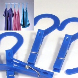

Here is what I use (courtesy of the $1.00 store):
