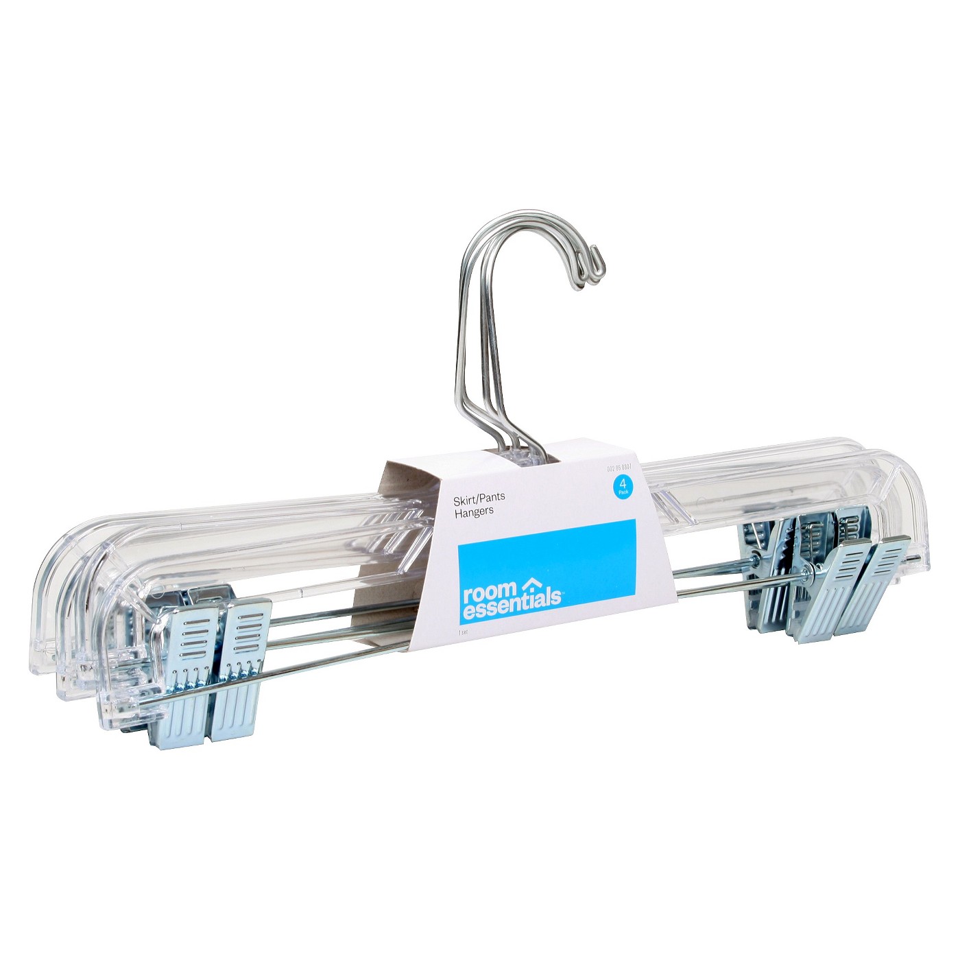

I'm fascinated by the fact that anyone would be using something heavier than a wooden/spring clothespin to weight a film at the bottom, unless you are in some ultra-dry environment that causes film to curl like spring steel. If you feel you need to go super heavy duty, just go in your closet, pull out 2 trouser hangers (the kind with the rod and spring clips that slide along it - I am attaching a picture of the cheapo ones Target sells), and hang two films from one and use the other (hanger with clips) to weight the films. Your films have to be the same length, but with 120, that's very easy.
