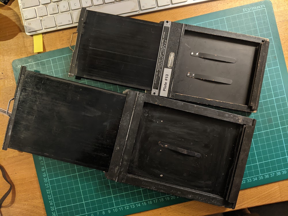

I hacked up my worst film holder so it would back load a 1/4 plate size piece of glass. Like this. The piece of aluminium acts as a loose spring but you can use some sponge. The corners are off cuts from the septum held on to what remains of the septum with CS (super) glue. Note the corrosion. This is probably the easiest/quickest way to get up and running.

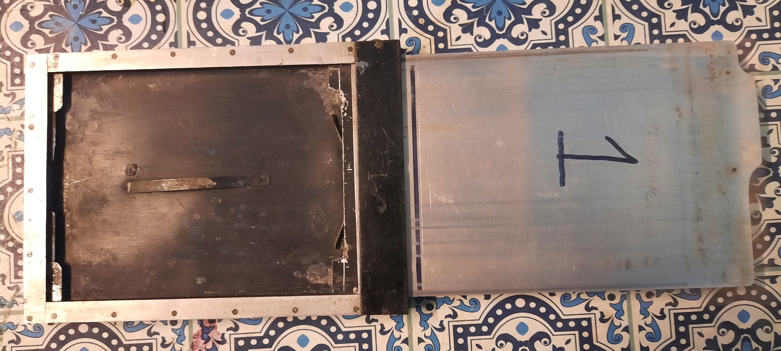

I did the a similar thing with a sketchy 8x10 holder. This plate holder cost me about £30 rather than nearly £300 for a Chamonix wet-plate holder which would do essentially the same job. I've only used it for dry plate though.

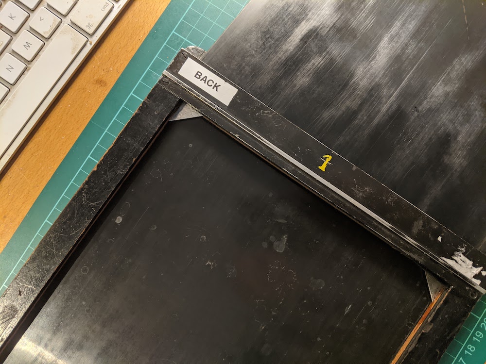

Note that I've written "Back" on the back of both the hacked holders. Before I did this I had that lovely sensation of hearing the plate fall forward into the camera when I removed the dark slide because I'd put the holder in the wrong way around. On both occasions the sitter said "Is something wrong?" The look on my face must have said it all!

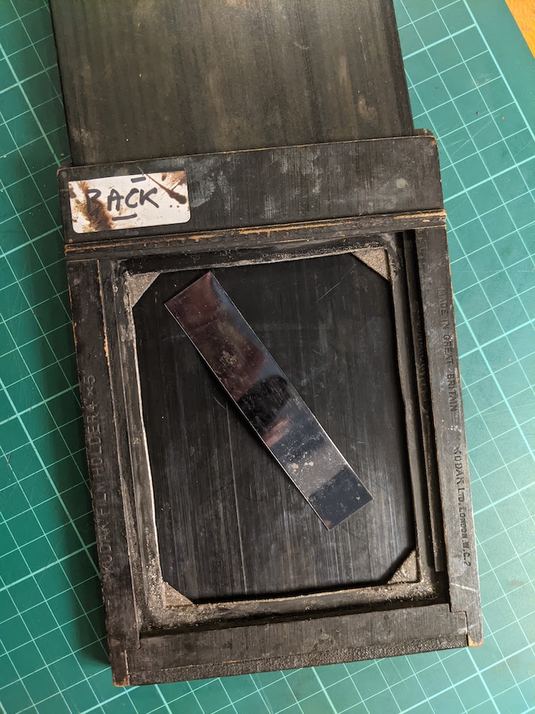

My modified 4x5 plate holders are the sprung type and work both with glass and tin. I use a screw driver to lever into place and remove.
