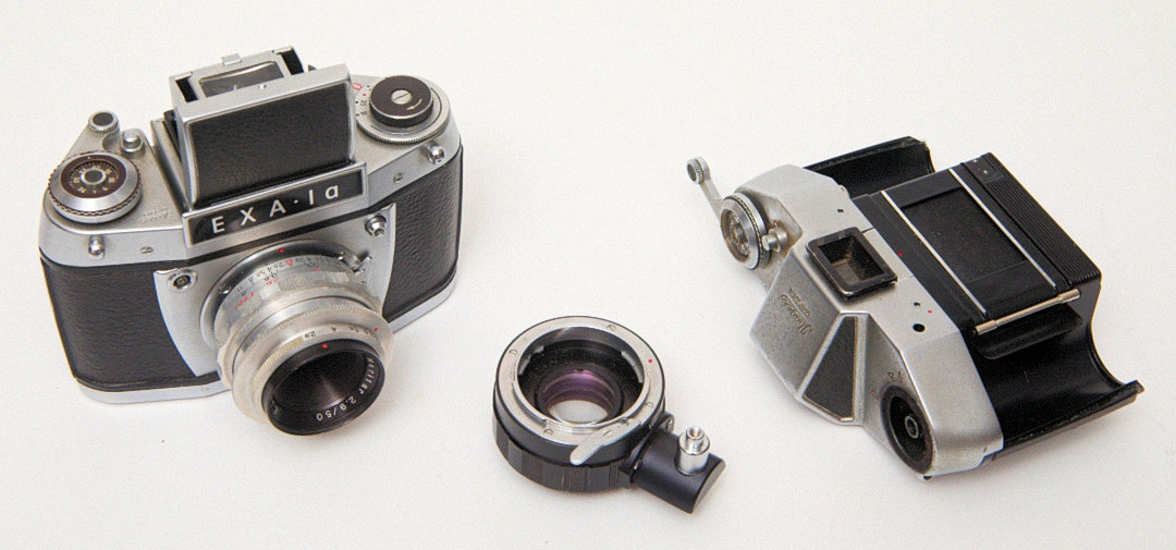

I bought the Exa 500 on the right for £1, it came with the 2x converter (middle) attached, which is in excellent condition. I removed and swapped the rewind lever as the lever on the IA (on the left) was missing.
I am trying to downsize and sell, but it helps if nothing is missing and everything works well :D
