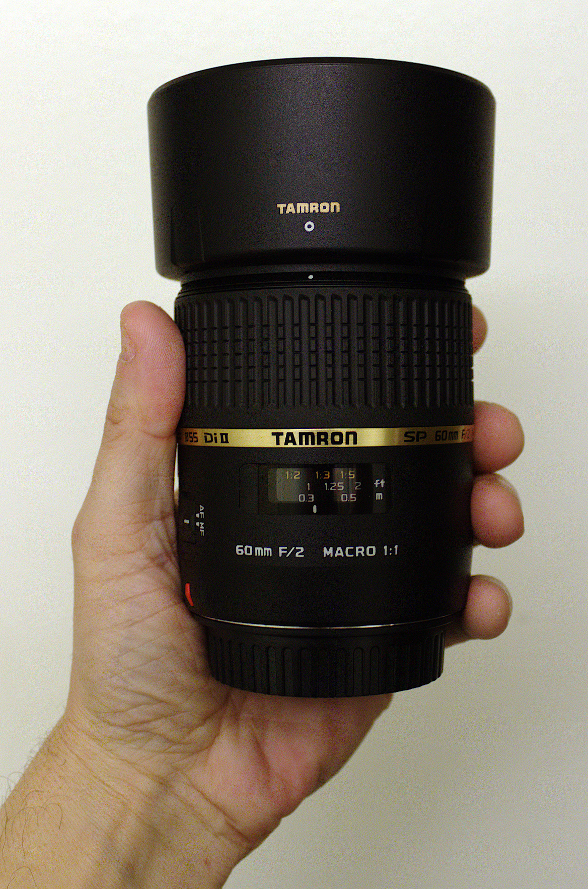

Just came in: Tamron 60mm f/2 macro lens.

Tamron make some great lenses. The only autofocus lens I ever bought was a Tamron, and it takes some very good pictures at about half the cost of a first-party equivalent.
I've used Tamron lenses for many years, usually SP. I've just worn pour my EOS mount 28mm-75mm f2.8, it is still a great performer but hunts at the 70-75m end, and there is wear, it's wobbly at those FLs. However, to be fair it has had very heavy use particularly in its early years, it's about 22 years d and paid for itself in well under a month.
I decided to replace it with a 24mm-70mm f2.8 Canon lens, should last me quite a few years.

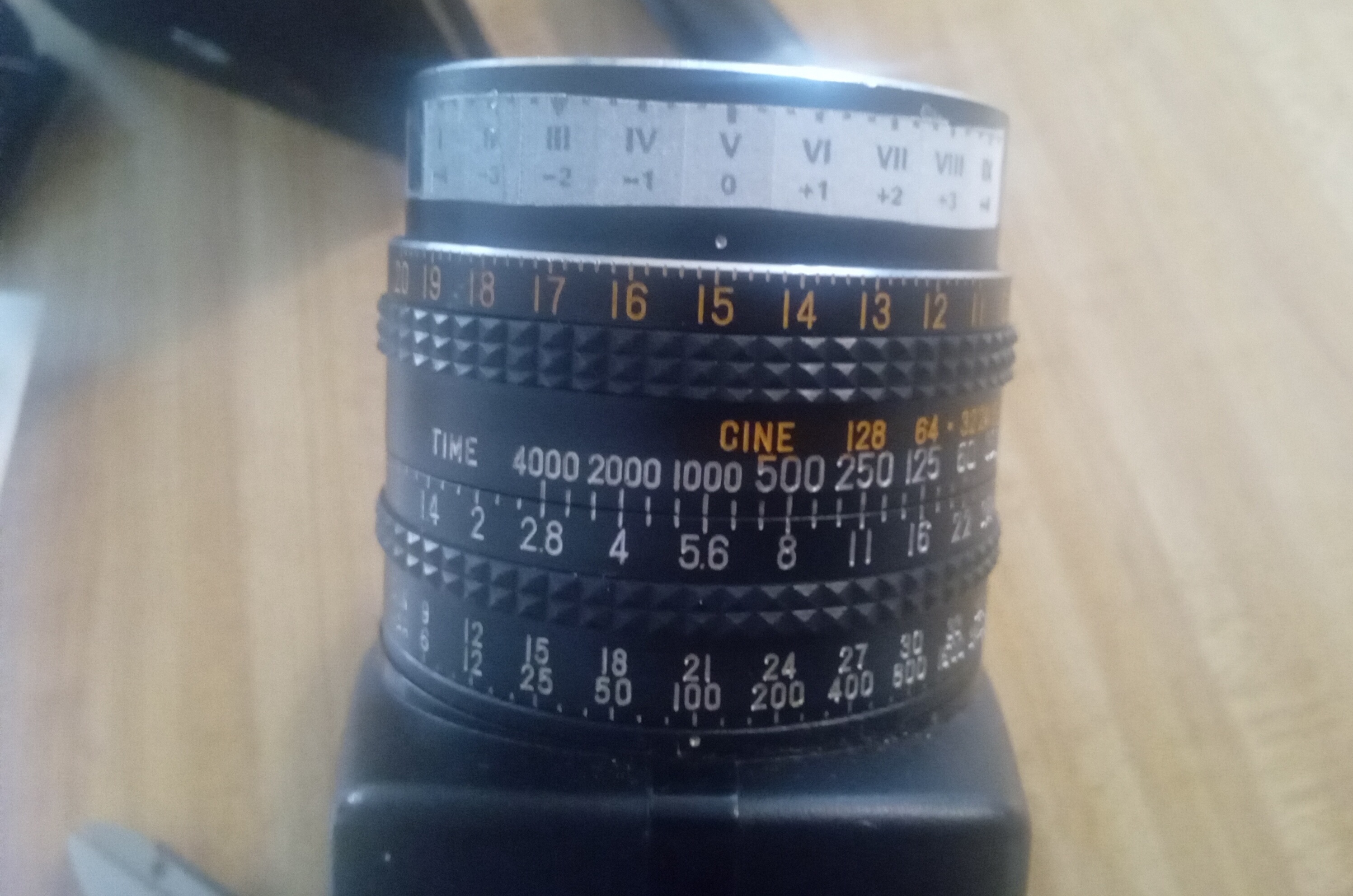

Technically not a "purchase", but printed out a couple "zone system scales" to put my Soligor spot meters. Not a 100% match (since the scale was made for the Pentax digital spot meter), but its close/good enough.

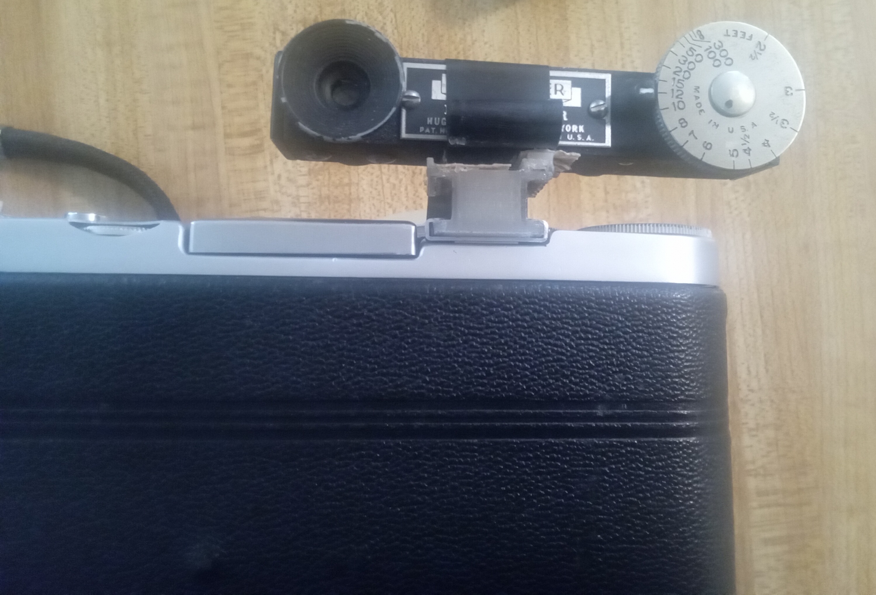

And from my local library for 50 cents, 3d printed a "camera hotshoe extension" to put the Hugo Meyer Rangefinder ontop of my Kodak Monitor 620 so I dont have to always take the rangefinder in & out my pocket all the time when using it. Had to do a a minor mod (cut/round out the edges to it) for it to fit & used some tape on it to make sure it doesnt fall off when in use, but it works.

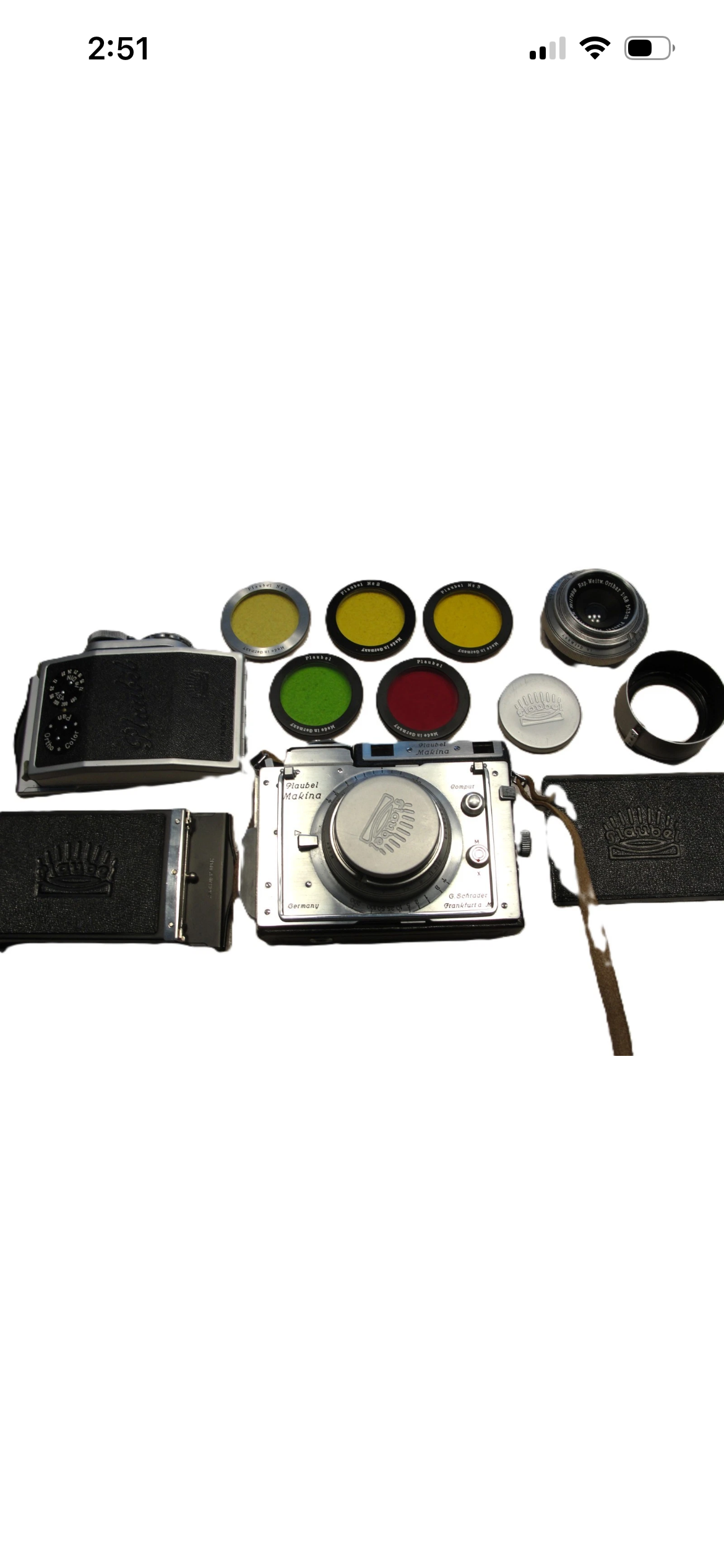

This Plaubel Makina 111 with 10 and 7.3cm lenses, hoods, lens caps, filters, roll film, and sheet film back. No other bidders and feels like o got a decent buy on it. Condition looks really clean.
