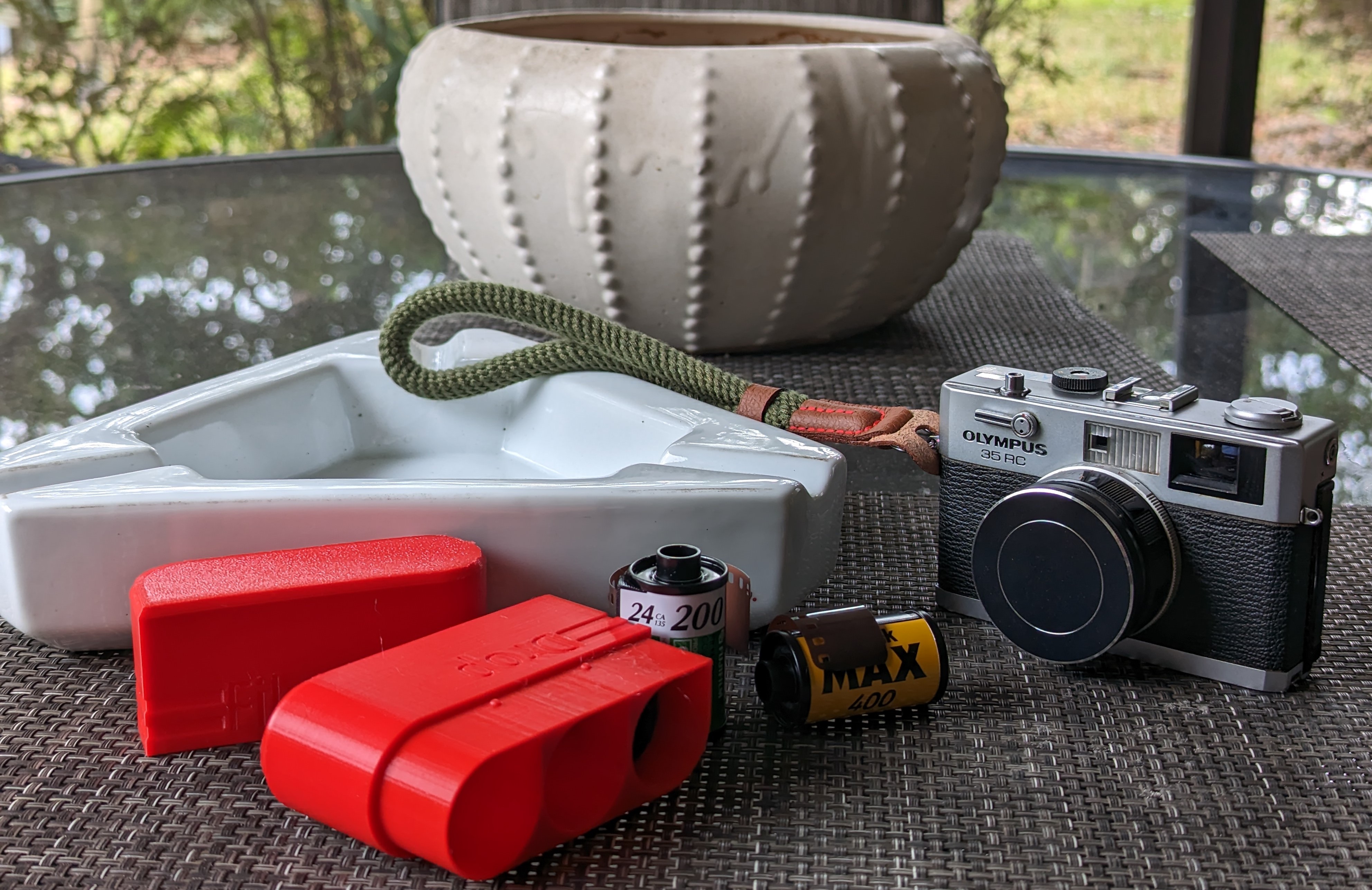

(2) 35mm Drop Cases for b&w and color cassettes.

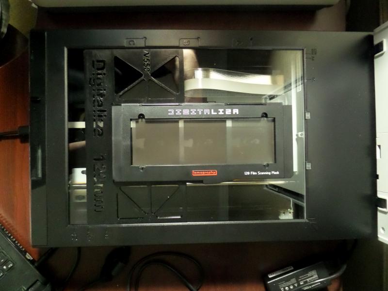

For Christmas I received a Lomography Digitaliza 120 scanning mask to use with my Epson V-600. But it's so hard to get it aligned properly, it bugged me. So I had a Digitaliza film holder guide (both 120 & 35mm) 3D printed and after a dry run it seems I found a solution for my scanning. I also ordered a Digitaliza 35mm mask yesterday.
