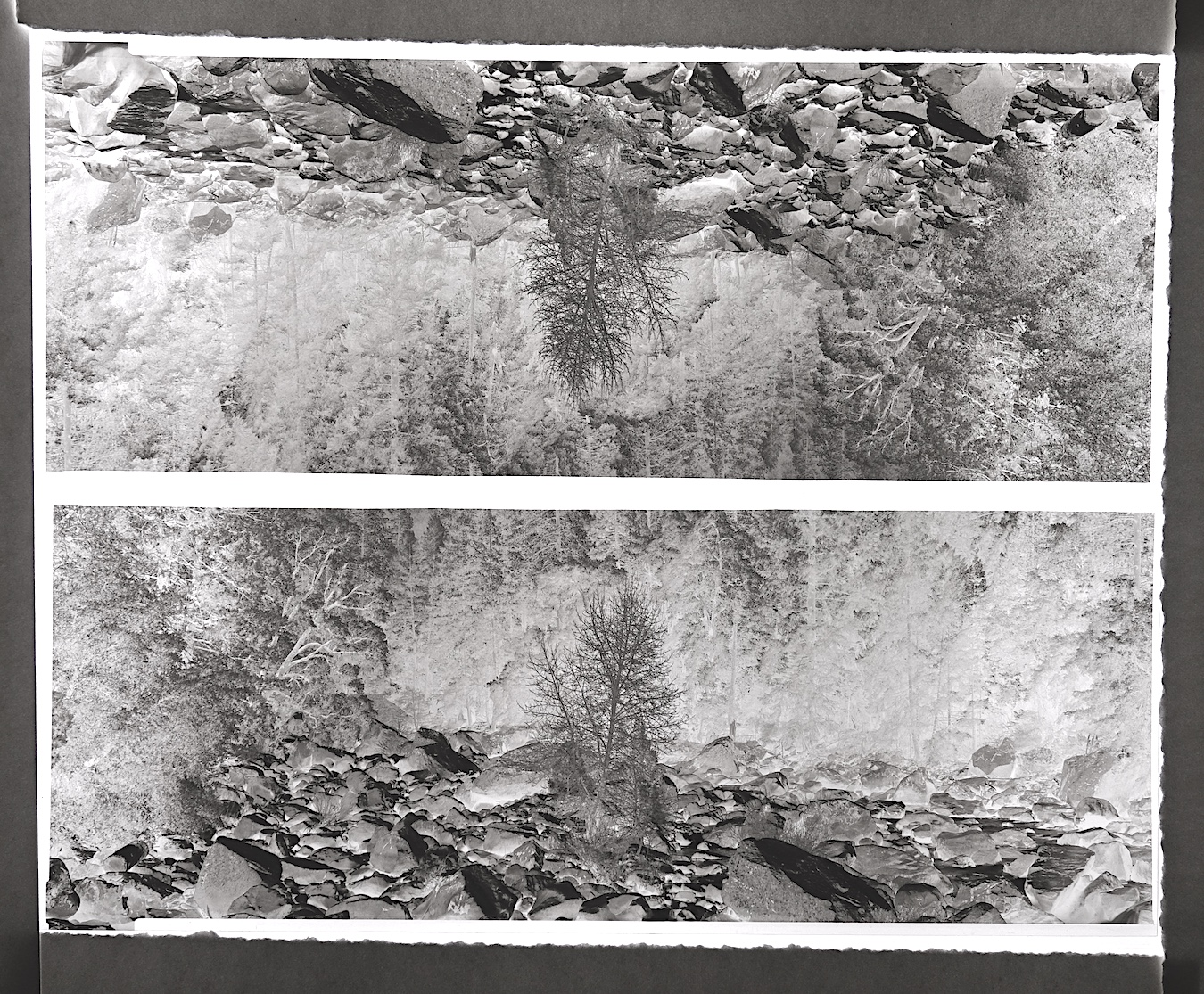

Old sheet of 11x14 finally processed a couple days ago (survived a year in a film holder quite nicely, amazingly enough). Digitally photographed on light table.
Merced River Canyon, Yosemite National Park, 2020
Chamonix 11x14, Fuji W 360mm. Modified darkslide to get two 5.5x14 images. FP4+ in PyrocatHD (2:2:100 ratio, 74F, 10 minutes in tray).
Light meter read from 9 to 14, exposures were at 11 and 11.5 (about)
One image at f16 at 1/8 sec and the other f22/32 at 1/4 second. The center tree of the less exposed image (1/4 sec) is sharper...a breeze must have moved the center tree on the f/16 exposure.
Will be trying the neg with platinum/palladium printing soon. The negative is not as dense in the highlights as this reproduction suggests.

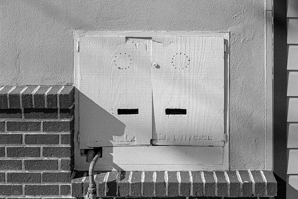

500cm 80 2.8 and 150 f4
Tmy-2 at 250iso
Pf130 1-10 68f 5:30 (could possibly use a little more developing time, prints were good at grade 3 under a diffusion enlarger, I prefer to get good straight prints under grade 2, the midtones were not quite to my liking yet)
pf130 1-1 ilford mgv 5x7 pearl
full frame print thats about 4.5x4.5

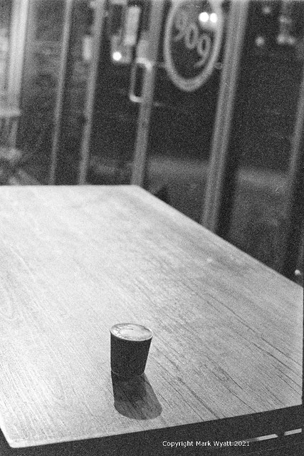

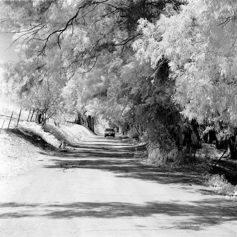

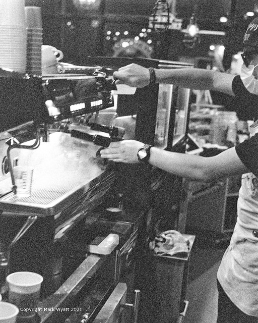

I shot a couple of rolls of expired (2015) Rollei IR 400 in 120 with my Mamiya C330f. It has been a while since I shot any IR, and the last was Kodak HIE. I developed it in HC110. A couple of shots from the second roll.
Surreal Country Road, Car
by Mark Wyatt, on Flickr
bench, surreal

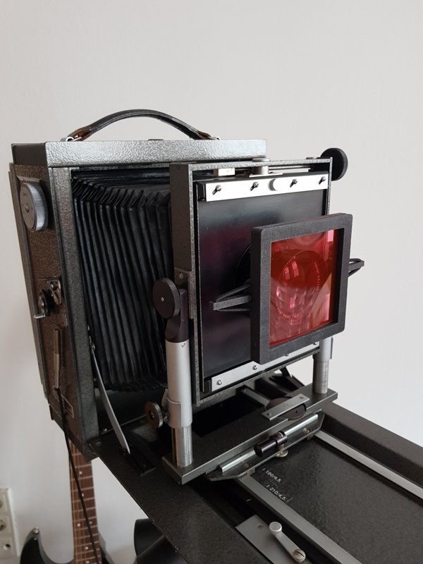

5x7 Mentor Studio with Tessar 180/4.5 @ 4.5, grade 1 MG-fliter

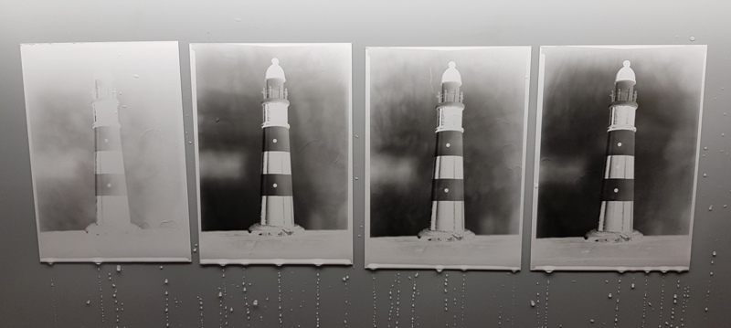

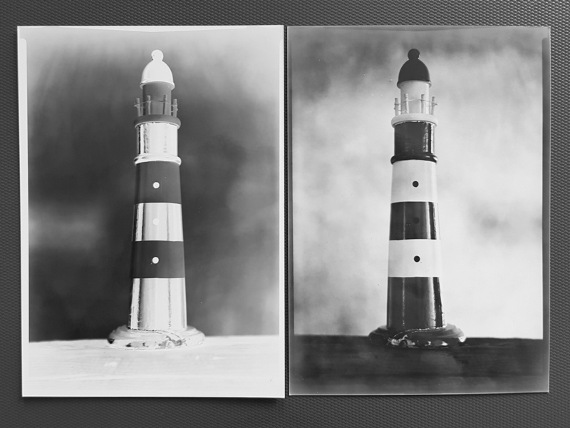

Ilford MG IV RC paper negatives exposed 30s, 60s, 90s, 120s,
contact print
all developed in Eukobrom 1+9
