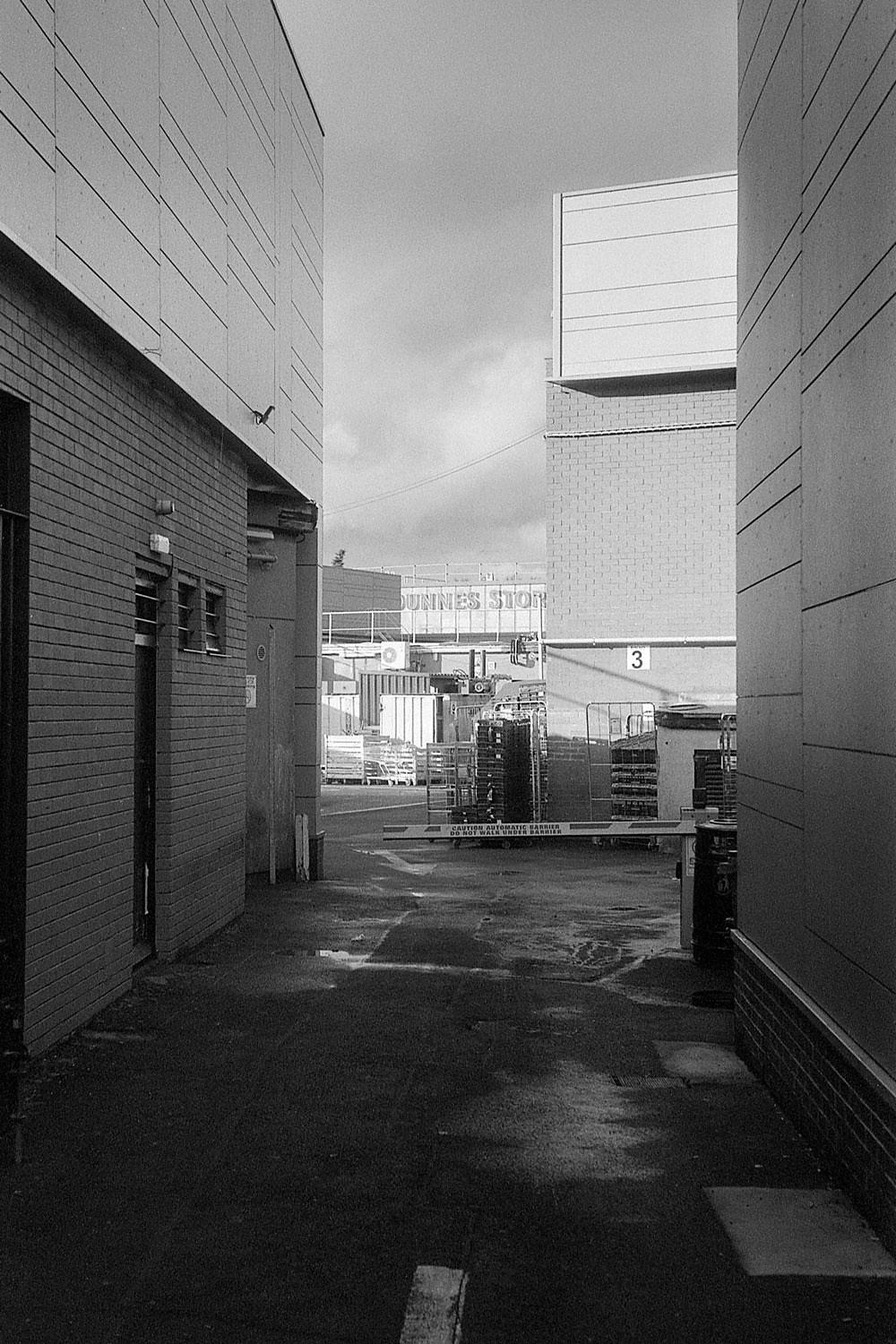

This is with a Kiev-4a, Jupiter-8M lens, Fomapan 400 at 200 in PC-Glycol as described above.

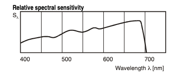

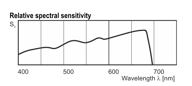

Looking at the spectral sensitivity chart from Foma, this film seem to have extended red sensitivity, more than, say, HP5.
That's an older technical sheet. The current one shows a full drop off before 700nm.
The reformulation may also be why my experience with Arista EDU 400 Ultra (which is supposed to be repackaged Foma Action 400) is very different from what Juan reports in post #4.
Sterioma's chart appears to show the sensitivity ending at about 695 and grat's in #24 appears to be ending about 705 nm Would that be (a) enough to make any appreciable difference in sensitivity? Could it be basically the same chart that when redrawn was done in a slightly different way
If it represents a genuine change then why only about 10nm? What might Foma have done to deliberately bring about what appears to be a very marginal change. Of course I am extrapolating here as there are no marks between 650 and 700 but each graph's end suggests only a minus and plus of about 5nm around the 700 mark, doesn't it?
