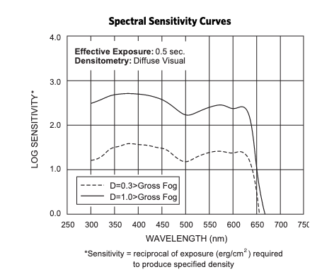

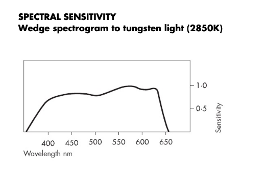

That's an older technical sheet. The current one shows a full drop off before 700nm..
It's possible that my chart was not the most recent.
However, Foma 400 is certainly not less red sensitive than Tri-X or HP5 (just to pick two very common 400 films), which both seem to drop off much closer to 650nm.
Tri-X
HP5
