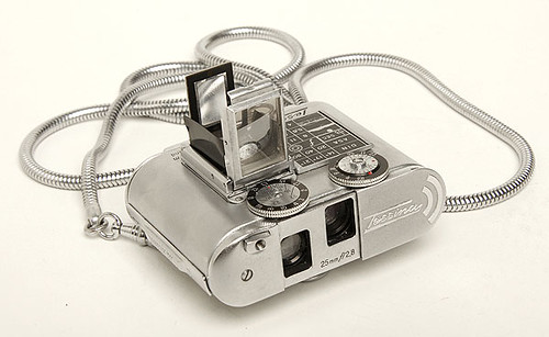

-) Siegrist Tessina

I was go ing to say the Olympus OM1 or OM3 but had forgotten about the PenF,again from Olympus. I have just had a look at the Tessina and with a quick search can find little information about it apart from it did have a seperate viewfinder so is it an SLR?

I have to correct myself, the Tessina is not a SLR, but a TLR.
Sorry...
