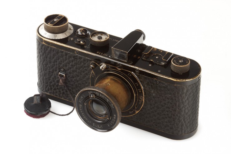

PS : most expensive camera ? Phase One (~48.000,-) ? No see :
= 2.160.000,- (2014 Austria)
