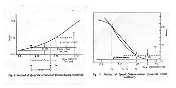

In a paper by D. Connelly, he writes, “It is evident that the relationship between the sensitometric measurement of exposure (film speed) and the photographic exposure (camera exposure) requirement must be determine.” There needs to be a way of connecting the various photographic elements together. You determine the film speed and that value somehow has to relate to the exposure meter and camera exposure in order to achieve good repeatable negatives.
Here are the questions to consider, and please keep in mind it's the sensitometric measurement of exposure.
What is the relationship that Connelly writes about?
How can it be determined?
How does the film speed work with the exposure meter to determine the exposure placement of whatever the meter is pointing at?
Also keeping in mind that exposure meters are designed to produce one data value for the scene, what should that exposure be for a given film speed?
I know it seems pretty straight forward, but it involves some fundamental underlying principles. I've uploaded Connelly's paper for a reference. The above quote comes from the section on Film Speed on page 187.
  • Calibration Levels of Films and Exposure Devices, Connelly.pdf

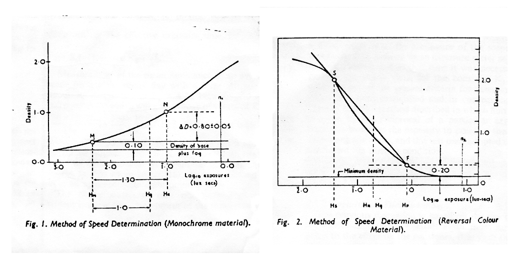

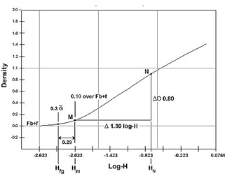

For B&W negative films, arithmetic ISO speed is determined by:
ISO Speed = 0.8 / (Exposure st speed point)
The speed index result is rounded off to the nearest 1/3rd f-stop.
For color reversal films, the the exposure needed to get to the shoulder point (S), which is about 90% maximum density is determined. Then the exposure needed to get to the toe (T) which is 0.2 density above the minumum density is measured. These two exposures are averaged, that is: ((S+T)/2), and this value is the Speed Point. The reciprocal of the exposure at the Speed Point is then multiplied by 10 and the result is the arithmetic Speed Number.
The preceeding was taken from "Sensitometry for Photographers" by Jack Eggleston. Stephen recommended this book to me many years ago, and it is certainly worth getting if you are at all interested in the subjects at hand.
Thanks Kirk,
For B&W it's 0.8 / Hm
For Color Reversal it's 10 / Hm
Connelly uses HR for color reversal films to avoid confusion. I’ll be doing the same.
Hm and HR is the exposure in meter candle seconds at the measured point for the respective film speeds. The reason why it needs to be a sensitometric exposure is to produce known values to work with. Few people have this capability, but it’s possible to determine the necessary values for Hm and HR for any film speed by dividing the aim film speed into the constant.
100 speed - .8/100 = 0.0080 mcs 10/100 = 0.10 mcs
125 speed - .8/125 = 0.0064 mcs 10/125 = 0.80 mcs
200 speed - .8/200 = 0.0040 mcs 10/200 = 0.05 mcs
400 speed - .8/400 = 0.0020 mcs 10/400 = 0.025 mcs
For a black and white negative with a speed of 125, an exposure of 0.0064 mcs at the film plane will produce a negative density of 0.10 over Fb+f when all the other conditions of the standard are met. With a transparency an exposure of 0.80 mcs with a 125 speed film will fall half way between the points HS and HT.
But how can the same film speed produce two different exposure values? As you can see from the examples of the two graphs from the speed standards, the speed points for black and white negative films and color reversal films fall at very different points on the characteristic curve. This is accomplished by having different values for the film speed constants. For black and white negative film it’s 0.80 and for color reversal film, it’s 10.0.
Sometime in the 70s or 80s, the constant for color reversal film changed from 8.0 to 10.0 while the method of determining the speed point didn’t. The film speed determined from the same point on the film curve went from 8/0.064 = 125 to 10/0.064 = 156. Changing the value of the film speed constant changed the resulting film speed value. In the case of color reversal film, the film speed increased by 1/3 stop which decreases the film exposure by 1/3 stop.
Why change the constant and not the speed point? Why not just shift the speed point to the right by 0.10 logs? One of the purposes in film speed testing is to define the limiting points on the film curve that are critical to the perception of quality in the finished image. For color reversal film, it is the two defined end points on the curve (S and T). For black and white negative film, it is the point where the minimum gradient it .3x the average gradient of the film curve. By adhering to the contrast parameters of the black and white film standard, this point will always fall 0.29 log-H units to the left of the speed point (attachment - B W film speed standard and Fractional Gradient point.jpg). Knowing the position of these points is important toward producing a film speed that has any relevance to the film and to quality results. By adjusting the exposure placement through a change in the constant and not a change in the speed point maintains this relevance.
Now that the critical points with each of the film types are known, the next step is to determine where to place the point of exposure averaged from the scene being photographed where all the values from the scene will fall within the tested limits.
The luminance range of the statistically average scene is 2.20 logs (7 1/3 stops). The average luminance of the scene will fall where there are just a little over three stops above the average luminance (0.92) and just a little under 4 1/3 stops below (1.28).
I hope that I was able to begin to convey how the film speed is important to exposure placement. Now, we need to determine the placement of the exposure. This involves understanding something about meter calibration and camera exposure.
The speed point is a function of the characteristics of the film - as you say, "the limiting points".
For reversal films, going from the 60s to the 70s, reversal films were able to capture a much large range of exposure. That is, the distance between S and T would have increased over films of a few years earlier.
That means the film speed number could be determined with a differenent equation to better account for this increased range.
For B&W neg films, the the standard printing paper LER did not change, so the speed point calcs would have remained the same.
