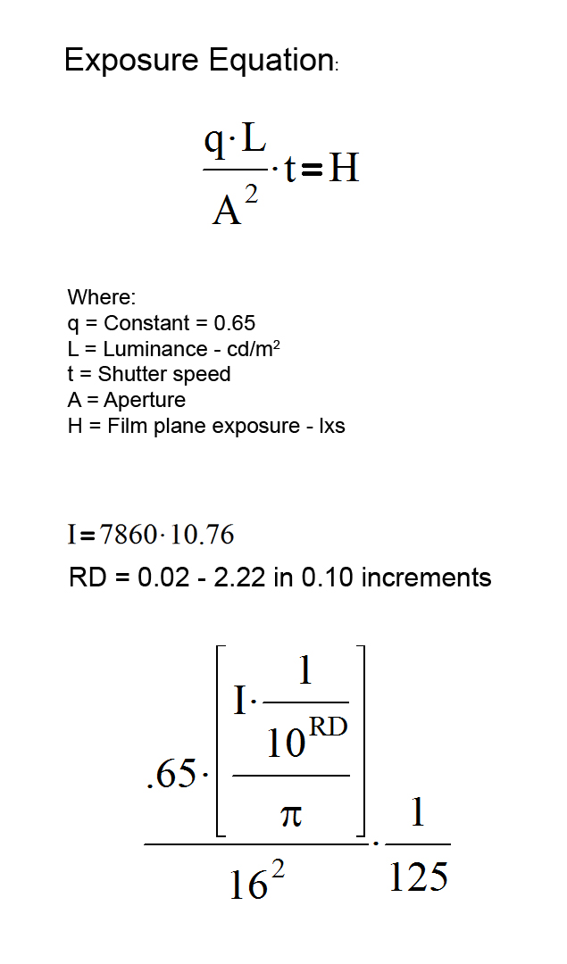

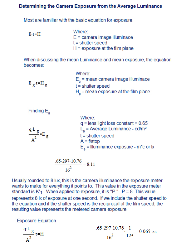

According to the exposure meter's calibration equation, the mean scene Luminance is 297 cd/ft^2 or 3196 cd/m^2. Whatever the meter points at, the f/stop and shutter speed half of the equation wants to adjust itself to balance the equation to equal the same output as with the 297 cd/ft^2 at the Sunny 16 rule - f/16 and the shutter speed as the reciprocal of the film speed - 1/film speed.
If you remove the shutter speed out of the picture, the exposure meter wants to produce a single value that, according to Connelly, "can be considered either the average image illumination required for light sensitive material having unity film speed when exposed for a time of one second, or a constant reference exposure (P)." This value is what makes exposure meters work for all materials. It wants to produce a single exposure value.
It is the film speed of the photographic material determines where the average point of exposure or the metered exposure point will fall. As we've seen, it's not just a value representing the sensitivity of the photographic material, but also includes information about the limits of useful exposure of the film type, and most importantly an adjustment by the speed constant to place the metered exposure point at the point on the film's characteristic curve so that the entire scene's exposure range will fall on the curve where it will be most advantageous.
Now that we know the average Luminance or Lg, we can determine the constant P and then calculate the exposure value for all the different film speeds.
There's a short cut to determine the metered exposure value for different film speeds. Simply divided the film speed into the constant P.

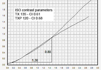

Bill,
Excellent question. It all has to do with the ISO contrast parameters. The log-H range of 1.30 is designed to measure the lower portion of the film curve. Long toed curves with their slow upsweep require a higher CI to fit the the ISO conditions than a short toed film. When people refer to the ISO contrast parameters producing an gamma, contrast index, or even an average gradient of 0.61 because of the .80 / 1.30 = 0.615, they are in error as those measurement methods include a greater portion of the film curve. While this usually won't make much of a difference with the primarily straight lined short toed curves, it will with the longer toed curves.

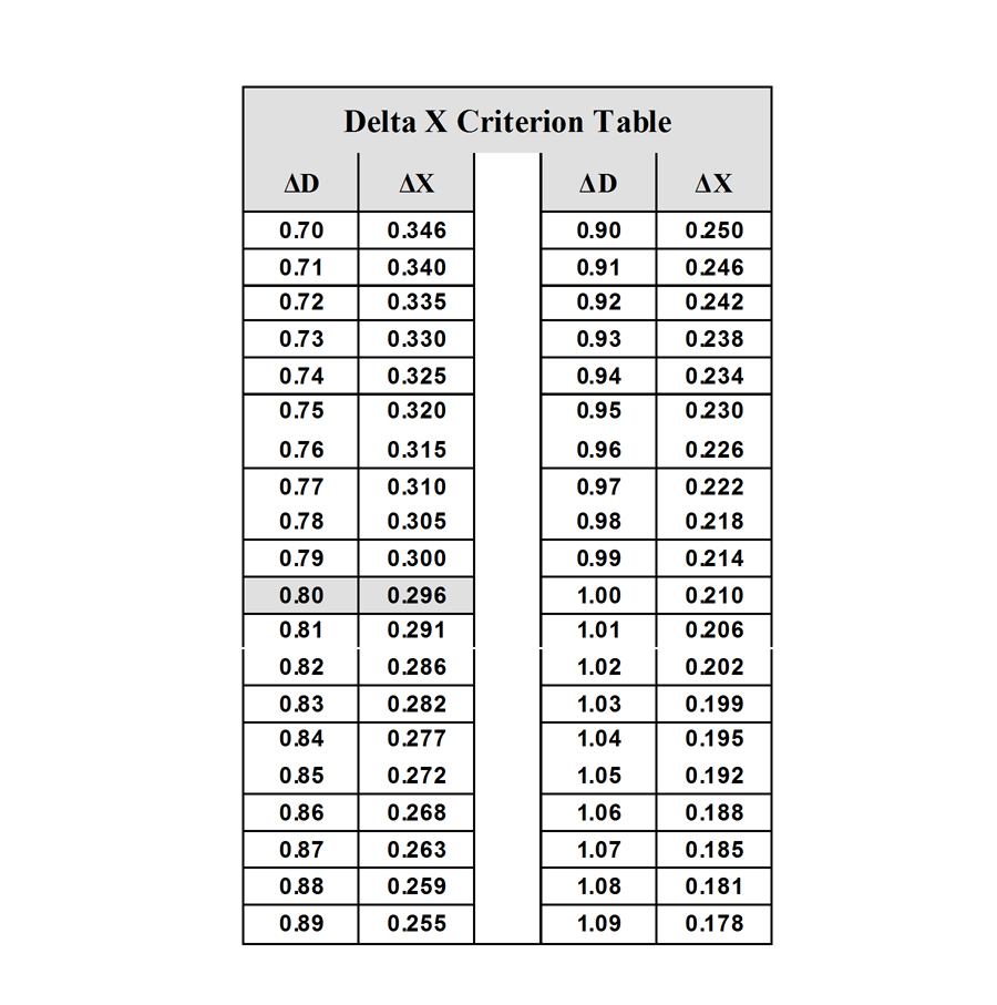

Delta-X Criterion is a method that uses a mathematical adjustment which allows the use of 0.10 as the speed point for any processing condition while still retaining the accuracy of the fractional gradient speeds.
I hope this explanation also helps clarify how the speed constant works and how the speed point isn't necessarily associated with the placement of the camera exposure. It's for testing purposes to determine the placement of the exposure.
So ... the .3G speed point falls ~1 stop to the left of the ISO speed point...
... under certain contrast conditions, the 0.10 speed point fell at a uniform distance from the .3G speed point...
Great, that makes sense.
The .3G and .1 speed points correlate to each other... by being a certain distance apart.
Yes, but I would like to emphasize the 0.29 only applies when the ISO contrast parameters are met, otherwise the relationship is different. Although it's not random. You can determine the Delta X value by the Delta D value while maintaining the 1.30 log-H range.

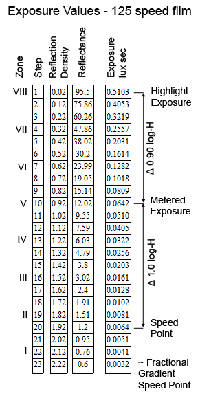

Now that we have determined the ratio between the speed point and the metered exposure, we can illustrate how an average 2.20 log scene luminance range falls onto the film curve.
I’ve generated the exposure values using the camera exposure equation in order to confirm all the exposure values for the luminance range.
To help simplify things a little, I’ve made a small adjustment to the ranges above and below the metered exposure. Instead of a range of 0.92 log-H above and 1.28 log-H below, I’ve made them 0.90 above and 1.30 below. The illuminance comes from the incident exposure meter’s value for I = 7680 footcandles. It is then converted to nits (cd/m^2). The exposure is for a 125 speed film which is reflected in the shutter speed of 1/125.
I believe this example confirms some of the concepts so far discussed. The metered exposure falls at an equivalent 12% Reflectance (RD 0.92) (step 10). We know this because for a 125 speed film, the metered exposure will be 8/125 = 0.064 lxs. The speed point exposure for a 125 speed film is 0.8 / 125 = 0.0064 and that falls at a point 1.0 log-H units below the metered exposure (step 20). This confirms the 10x ratio discussed in the last post. The shadow exposure at 0.0032 lxs falls on step 23.

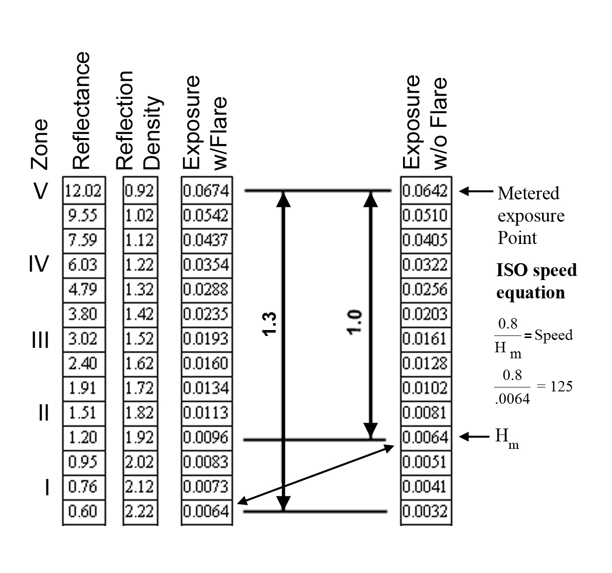

Well, I place my shadows on Zone II which is one third-stop above the speed point in your illustrations. And it is interesting that there "is" image information (that we don't expect to be able to print) all the way down to the 0.3G point (which is pretty close to Zone I).
Take another look at it. Zone I falls at 1.20 log-H units below the metered exposure, but that's 0.20 log-H units below the speed point which also happens to be at 0.10 over Fb+f. The two don't seem to match up. What affect do you think this has on comparable film speed values?
The purpose of the speed point – metered exposure ratio is to link the sensitometric exposure of the film speed testing with the camera exposure. As film speed is derived from a sensitometric exposure, it is determined from non-flare testing conditions. As a certain amount of flare exists in shooting conditions, adding a flare value to the camera exposure equation will produce more realistic film plane exposure values.
Veiling flare has the greatest influence on the deep shadows and it’s influence progressively tappers off as the exposure increase. Because of this, I’m going to focus on the exposure below the metered exposure. The example here has a flare value of one stop. The flare value is determined using the last shadow exposure value. A one stop flare factor doubles this value and then adds it to each of the other exposure values. This will double the shadow exposure but will only add around 2-3% to the metered exposure.

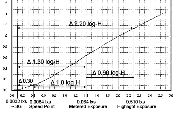

Flare has effectively taken the scene’s luminance range of 2.20 and reduced it to an exposure range of 1.90. This change is down almost exclusively below the metered exposure. The exposure range has gone from a scene luminance range of 1.30 to a film plane exposure range of 1.0.
It’s done this by increasing the shadow exposure by one stop, which moves it to the right on the film curve. In the case of a one stop flare factor, it brings the exposure up to the speed point. In this situation, the metered exposure falls at a 10x ratio to the shadow exposure.
Flare isn’t consistent from scene to scene. It varies depending on a number of factors including luminance range and the distribution of the luminance values within that range. And flare is virtually impossible to measure in the field. It’s a variable that can’t be controlled. Let me repeat the Jack Holm quote from post #31, ‘The trick is to select a speed point which allows for the maximum variation in the actual speed-point-exposure /mean-exposure ratio with the minimum variation in image quality.”

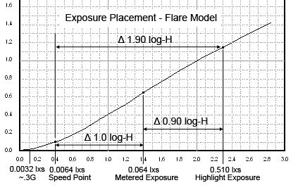

This is a question of exposure placement and variance. Keep in mind that the film speed – meter exposure ratio is not intrinsic, nor is it arbitrary. It was chosen for a reason. With a flare factor of 2 (one stop) representing average flare, the shadow exposure for an average scene falls approximately one stop above the fractional gradient point. This point is the minimum point of exposure that can still insure a quality print. Even in a non-flare shooting situation, which is impossible, the shadow exposure will still fall at a usable point. This potential “safety factor” also allows for some accidental underexposure or scenes with slightly deeper shadows than the average.
As has been frequently discussed, overexposure within a certain range, doesn’t diminish image quality.
The following example uses the same film curve as post #33 with the exposure overlay incorporating the one stop flare factor.

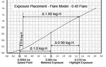

There’s a argument to be made for a slightly higher flare factor in shooting conditions, especially with smaller formats. A 1 1/3 stop flare factor moves the shadow exposure to the right an addition 0.10 log-H units.
What happens when the film speed constant changes, effectively changing the film speed – metered exposure ratio?

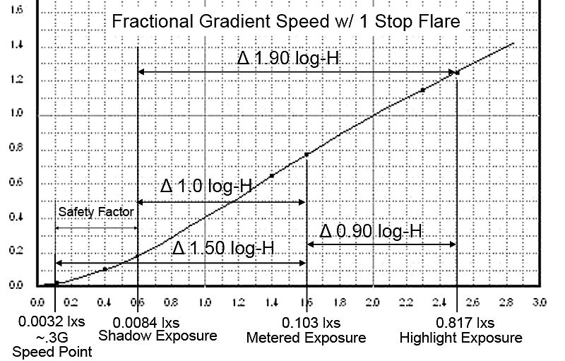

The Fractional Gradient method is a good example of this. It’s speed point is located where the slope of the toe of the curve is equal to .3 times the average gradient of the curve. Because of this, it jumps around some, but under the current ISO standard’s parameters for film contrast, the fractional gradient (0.3G) speed point falls approximately one stop below the fixed density point of 0.10 over Fb+f.
As we’ve seen, the current ISO speed equation is 0.8/Hm. The exposure value for a 125 speed film would be .8/125 = 0.0064 lxs. If the .3G speed point falls one stop down, the exposure value there would be half of 0.0064 or 0.0032. If we apply that value to the ISO speed equation, we get .08/0.0032 = 250, but that’s not how 0.3G worked.
They wanted to give the exposure a bit of a safety factor. Meters weren’t too common, and many were bad. Many people tended to use either rule of thumb or exposure guides. So, the exposure placement needed to be elsewhere on the curve. Changing the location of the speed point was out of the question because the use of it’s location had best correlation with the psychophysical first excellent print test.
All that is required to shift the exposure placement while keeping the speed point location stable is to change the speed constant which will then change the speed point – metered exposure ratio. For 0.3G, they used 0.25 for the speed constant producing 0.25/Hm for the equation (I’m using current nomenclature to help avoid confusion). This would make the film speed for the same exposure values that resulted in a 125 speed value using the current speed stand: 0.25 / 0.0032 = 78.
The metered exposure is then 8 / 78 = 0.103 lxs. The ratio between the speed point and the metered exposure then becomes 0.103 / 0.0032 = 32 or 1.50 log-H units. So instead of having the metered exposure fall 1.0 log-H above the speed point as with the current ISO standard. The Fractional Gradient Method had the metered exposure fall 1.50 log-H above it’s speed point. That’s a difference of 1 2/3 stops (0.50 log-H).
The below graph illustrates the exposure placement resulting from the Fractional Gradient Method. The exposure range has been adjusted to represent one stop of flare.
The speed between the 0.3G speed point and where the shadow exposure falls is considered the safety factor. In addition to the shadow exposure falling 1 2/3 stops above the 0.3G speed point, it also falls 2/3 of a stop above the density of 0.10 over Fb+f. A key point to remember about speed points is that the shadow exposure doesn’t necessarily have to fall on them (for black and white negative film).

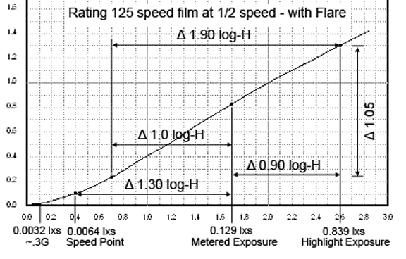

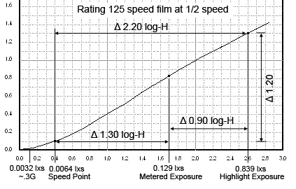

Next. How does changing the EI of the film effect the film speed – metered exposure ratio? Also, how to adjust the speed constant to create the desired change in the ratio.
Now let’s take a look at the changes caused by adjusting the film’s EI away from the ISO value. Most general purpose developers, when used correctly, tend to produce speeds in accordance with the ISO film speed, but it is often desirable to want a little extra exposure when shooting. So the photographer under rates the speed of the film. This might be done for a variety of reasons like for a larger safety factor, better shadow separation, or even personal taste. What does changing the EI on the exposure meter do to the film speed – metered exposure ratio?
First of all, changing the film speed setting on the exposure meter does nothing to the actual speed of the film or how the film responses to exposure. For a 125 speed film, the speed point will continue to produce a density of 0.10 over Fb+f when Hm is 0.0064 lxs no matter what the speed setting on the exposure meter. Setting a lower EI on the exposure meter will only shift the exposure placement to the right on the curve.
It’s common practice to under rate a film by half the ISO speed. With our 125 speed film example this would mean rating the film at 64. Because this isn’t exactly ½ of 125, I’m going to use 62.5 to keep the results simple. The metered exposure becomes 8 / 62.5 = 0.129 lxs. The ratio then becomes 0.128 / 0.0064 = 20 or a 1.30 log-H range. The two graphs below are examples of the exposure placement of the 125 speed example that has been under rated by 1 stop. One without a flare adjustment and the other with a one stop flare factor.
Speed Point - Metered Exposure Ratio - EI Change.jpg Speed Point - Metered Exposure Ratio - EI Change w flare.jpg

Interesting that your second diagram showing half film speed with flare...
Counting down stops/Zones from V.
Metered/placed Zone I falls only one-third stop to the right of the 0.1 speed point (a sane match for Zone I). And metered/placed Zone 0 falls one-third stop to the right of the 0.3G speed point (a sane match for Zone 0).
So I prefer a placement that is one-third stop to the left (faster) of the placement in your second diagram. My EI is two-third stops under rated film speed. I expect this to land my Zone I placements on 0.1 density on the film. Anything that would meter Zone 0 I would expect no density (threshold only).
It seems better to maintain the sensitometry to standard, so that it looks right in comparison to documentation. Then to shift EI at the last minute to accommodate preference/taste.
No?
