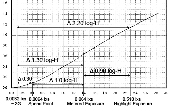

So, how do we know the speed point – metered exposure ratio is 1.20 log-H or 16x (15.8) for Zone System testing? It’s right there in the Zone System testing instructions. Meter a card and stop down four stops. Zone I is the speed point and it is at 0.10 over Fb+f. Four stops of exposure is 1.20 log-H.
It should be obvious at this point that for a 125 speed film where the speed point has an exposure value of 0.0064 for Hm has to have an EI lower than 125 for the 1.20 log-H range to fit between the metered exposure and the speed point. What would that EI need to be?
Exposure constant / (Hm * ratio) = EI
or
8 / (0.0064 * 15.8) = 79.2
or
EI 80
A film with an ISO of 125 and a speed point – metered exposure ratio of 16 (1.20 log-H) will have an EI of 80. Of course, Zone System testing gets to this same conclusion differently.

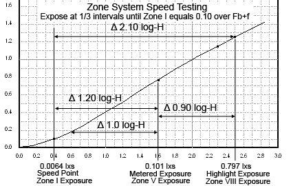

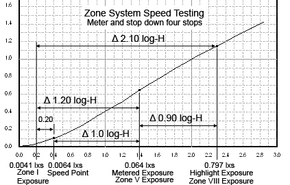

Traditional Zone System testing is done in camera which means people are far more limited in the exposure information available to them than if they used a sensitometric approach. A card is metered and the camera is stopped down four stops. (While the Zone System test uses only a single tone, the graphs illustrate how the the full exposure range would fall.) Below is an example of how the exposure will fall with a 125 speed film metered using an EI of 125.

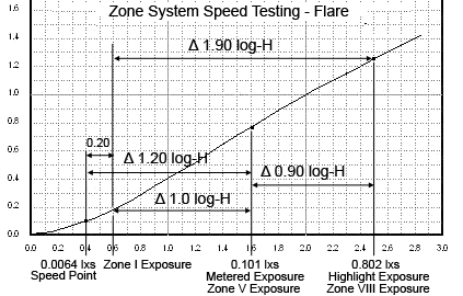

Zone I exposure will fall 0.20 log-H units below the 0.10 speed point. Exposure needs to be increased by 0.20 log-H in order to bring the Zone I exposure up from 0.0041 lxs to 0.0064 lxs. While the film speed remains at 125, the meter’s EI is now at 80. This is what creates the change from the speed point - metered exposure ratio of 10x (1.0 log-H) to 16X (1.20 log-H).
Doesn’t the first Zone System testing example look a lot like the sensitometric exposure example? The only difference is the choice of scene luminance ranges. The Zone System uses 2.10 and tone reproduction uses 2.20. So the only difference between the two is the sensitometric example has the shadow fall 1/3 stop further down on the curve.

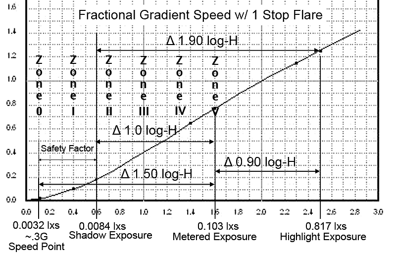

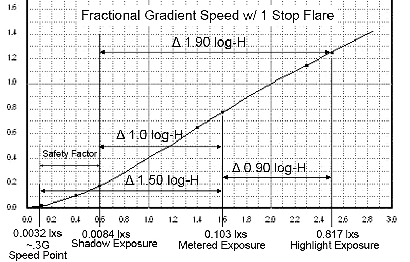

It’s interesting how similar this example is to the fractional gradient example, but it shouldn’t surprising. Both the Zone System and 0.3G were developed in the early 1940s. At that time they had a good correlation between the two results. Take a look at their speed point – metered exposure ratios. While at first the fractional gradient’s 1.50 might not seem to match the Zone System’s 1.20, if you adjust for the 0.3G having a speed point approximately one stop (0.30 log-H) units to the left of the Zone System’s speed point, they are the same.
It wasn’t until the 1960 standard reduced the safety factor and changed the speed point – metered exposure ratio which then caused the resulting speeds from the Zone System and the ANSI/ISO method to diverge.

These are great diagrams, your final diagram fits exactly Zone System benchmarks - Zone 0 at 0.3G, Zone I at 0.1 speed point, Zone V at the metered point.
You say the safety factor was removed in 1960? Does that change the final diagram, moving everything one stop to the left?

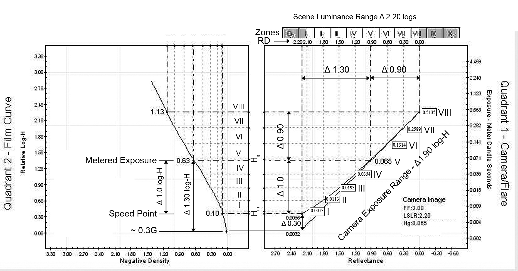

Below is basically the same as the current 10X ratio example except that I've added on the camera image curve. I don't know if this helps clear things up.

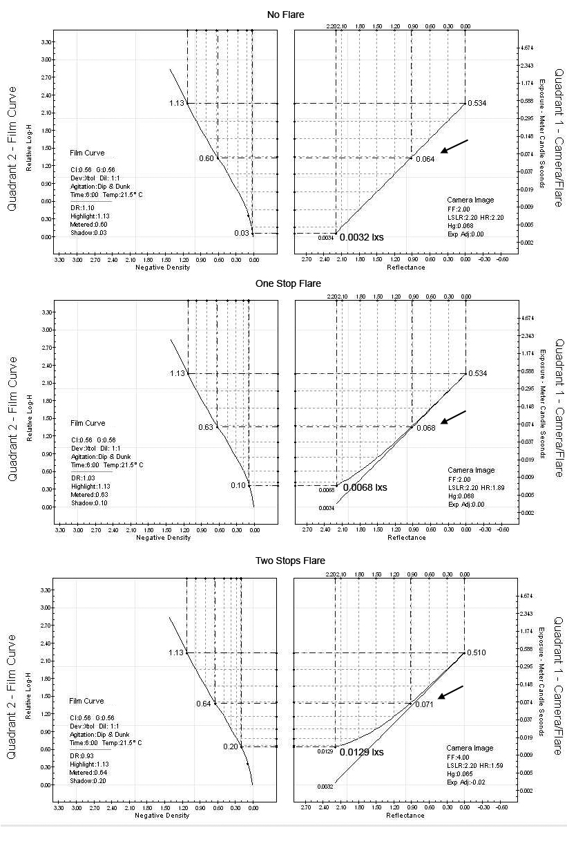

This model is wrong, because it shows what arrives at the film plane, including the one stop of flare in the shadow.
So for example a Scene Zone 0 came up to Film Plane Zone I.
But did a Scene Zone 0 come up to a Meter Zone I? The meter readings are not without flare. Whenever I aim a spotmeter at the darkness under a car for example, a lot of flare influences the meter reading.
Bill, I'm really curious as to what you see being wrong. We have to be getting our lines crossed somewhere. I'm interested to learn if there is any miscommunication with the way I'm explaining this. I've added Zone markings to the standard exposure model with one stop of flare so you can compare it with your version.

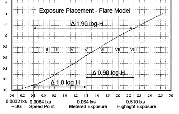

Flare does have an effect with the optics of spot meters, but just like with the camera, it's larger in the shadow areas than around the mid-tones. The exposure constant of 8 has already factored flare in. You're answered Mark's question about metering the shadows. Flare is too variable, hard to measure, and impossible to predict for the shadows to be a viable option. The next set of examples are three different flare models: no flare, one stop of flare, and two stops of flare. The exposure around the metered exposure point changes little while the shadow placement varies considerably.

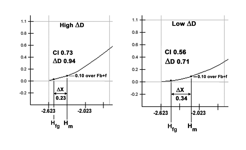

Mark,
That's exactly right. I was worried that nobody was going to appreciate the significance of the speed point-metered exposure ratio.
I also hope the idea that the speed point isn't an arbitrary target density didn't go unnoticed. That the process of determining the speed point also defines important aspects of the film curve. With b&w film it's the relationship with the minimum useful gradient point or 0.3G. Keeping that in mind, the 0.3G point tends to change in relation to the 0.10 speed point with changes in development. It's only has a exposure difference of around one stop when the ISO contrast parameters are followed. With increased or decreased development, the one stop relationship on longer exists which means the important connection between the 0.10 speed point and the lower useful end of the film curve is lost as well as the direct correlation connecting the exposure to the quality of the practical picture results of the first excellent print tests.
There is a fix which still enables the continued use of the 0.10 speed point. It just requires using an equation that is in the ISO standard but is built into the ISO contrast parameters. Because the 0.3G point has an inverse relation with the film gradient, it tends to shift to the right with extended development and to the left with decreased development.
This tends to mute the degree of speed change in regard to development comparied to just using the 0.10 speed point without the “fix.” This fix is known as the Delta-X Criterion.
Another concept that I hope came across was that if the photographer is doing sensitometric film testing, it’s better to test using well determined speed methods such as the ISO standard, fractional gradient, or Delta-X and to either adjust the meter’s EI or the speed constant, to change the speed point-metered exposure ratio, if more or less exposure is desired.

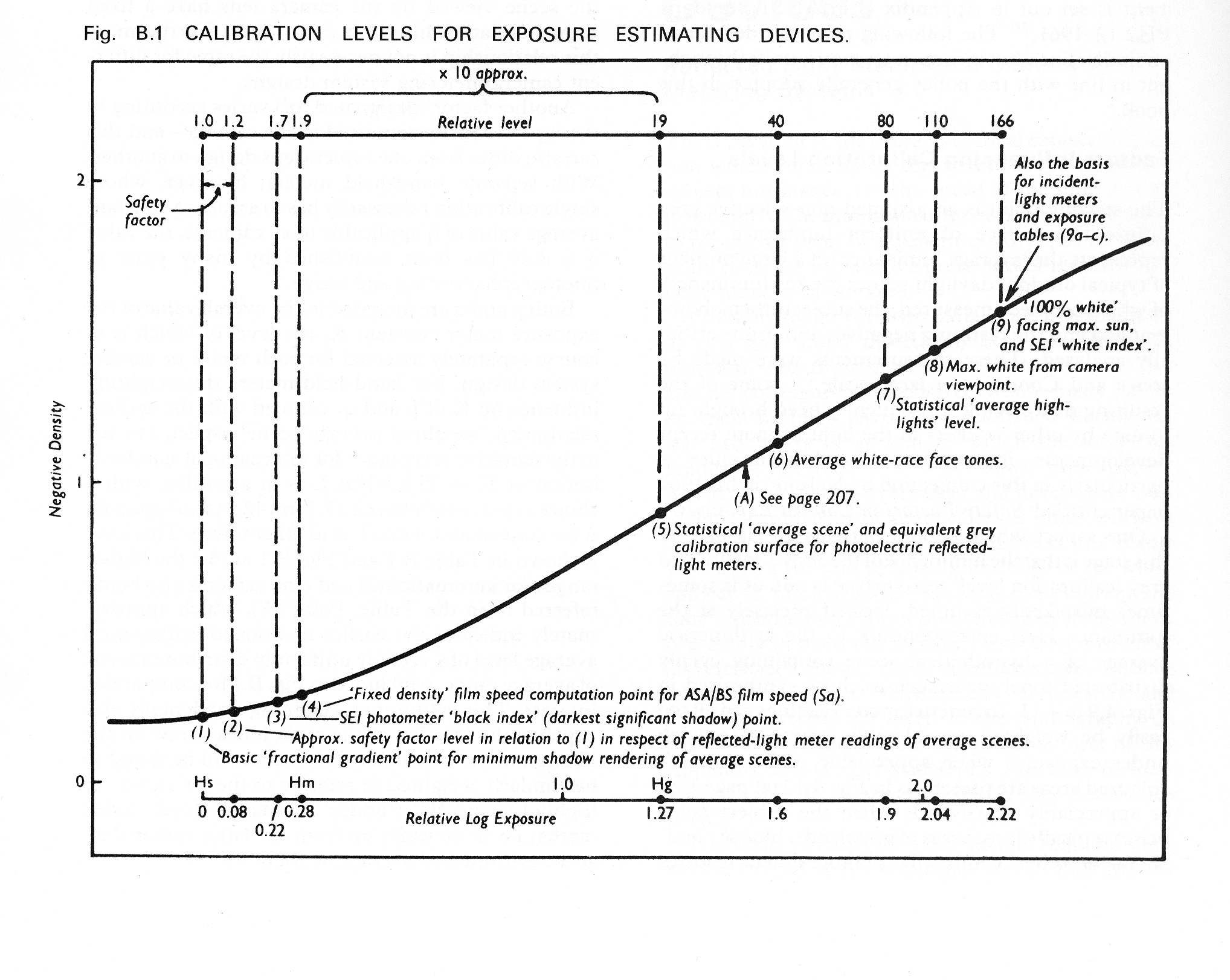

It's a point that I finally "got" when reading Dunn and Wakefield's, Exposure Manual, and that point has been reinforced by Stephen and others and in practice.
Finding or putting a "known" of some type into the scene is key to finding camera settings in a quick, reliable, and repeatable manner.
And it's not an incident vs spot meter thing. Dunn and Wakefield teach that they are fully interchangeable.
I suggest anyone who owns Exposure Manual to take another look at Appendix B. Much of it is exactly what has been discussed on this thread. Figure 8.1 shows the relationships between the fractional gradient speed point, the 0.10 density speed point, and the metered exposure among others.
Under the heading (i) Scene Luminance, Film Speed, and Camera Exposure Relationships, Dunn writes:
"Thus when an exposure meter which meets the quoted standard specifications is used to measure the reflected light from the simulated "average scene" gray test-surface in daylight, and the computer dial of the meter is used in conjunction with the rated speed of the film to determine the camera settings, the resulting exposure Hg, on the film for that scene element is expected to be 10 times greater than the exposure Hm involved in the sensitometric derivation of the film speed.
The ratio Hg/Hm is important because it indicates the level of exposure which will be obtained by the use of the rated speed with a calibrated exposure meter in normal daylight photography...This is the situation at the time of writing, and it may be regarded as wholely satisfactory as after the removal of the larger safety factor included in earlier days it is now left to the photographer himself to apply any safety factor he may consider desirable for the work he is doing. Using a large format camera he can, if he wishes, play safe and revert to a safety factor of 2 or even 4 without endangering print quality. If on the other hand he is working with a 35mm camera and is seeking negatives capable of big enlargement he can follow his exposure meter intelligently with only such modifications as may be suggested by unusual scene contrast or unbalanced luminance distribution."
