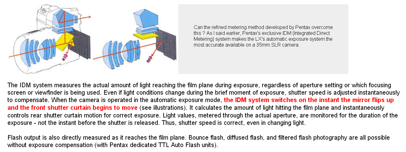

I understand that in A priority mode the LX integrates the light reflected in the film, so the exposure is not decided before shutter release, so it does not require an instant reading, so integrates the reading during all exposure time... it is a sound system, similar to the minolta at the time...
The drawback is that reading is not center-weighted...
https://www.mir.com.my/rb/photography/hardwares/classics/pentaxlx/metering/metering.htm
Instead the Photomic had a very well defined center-weighted reading, with only a 1.5 stop loss (1977) compared to the LX. Probably the Nikon system would be well preferred by a Pro of the era, a Pro is not shooting much in the dark, while the center-weighted metering was quite a desired feature.
IMO, at the end, the metering system of the LX was a principal factor for many Pros to not consider its usage. And in that scenary Pentax abandoned that market when large investements were necessary to compete in that segment in that late 80s and beyond, not having Pro customers you don't develop Pro glass...
So we cannot praise those LX 120s without telling it prevented having the desired feature of the time, the center-weighted metering, that pitfall contributed to a remarkable failure in the Pro market segment...

Les... the OTF of the LX was a total pitfall for most of the pros !!! it fails totally with backlighted subjects !
Imagine you are a wedding photographer, you have the couple there and background is a bright sky, you severely underexpose that people ! If you have all day long to take the shot then you meter the face nearing the subject and later you shot manual at right exposure, but if you have to shot several dozens of rolls in that wedding you don't have all day long to make a single shot...
The F2/F3/CanonF1 were smarter because the center-weighted metering delivers way more consistent Auto Exposures than average metering, specially when people is there, you don't want the background have too much weight. From the F2 (1971) to the F6 all Nikon cameras also included the center weighted mode, and none has the average mode.
Also center-weighted was to pave the way to advanced matricial metering, while OTF had no future. In fact F3 an beyond do include an OTF meter, but they use it only to control the flash, having to mount two meters because the OTF is a total pitfall in Auto mode, subjects are severely underexposed as background goes bright !!!
What happened with Olympus/Pentax with the OTF? No Pro wanted their meter, and they disapeared from the Pro segment. Instead Nikon, Canon and Minolta got that market.
Yes, as MIR tells the LX has the best meter, but I only agree this for night photography. If you are to shot people don't use those cameras, at least if you want to shot Auto and you are in a country with bright skies.
Why do you think the (for the rest) excellent LX was not sold? The meter was a pitfall for the Pros !!
