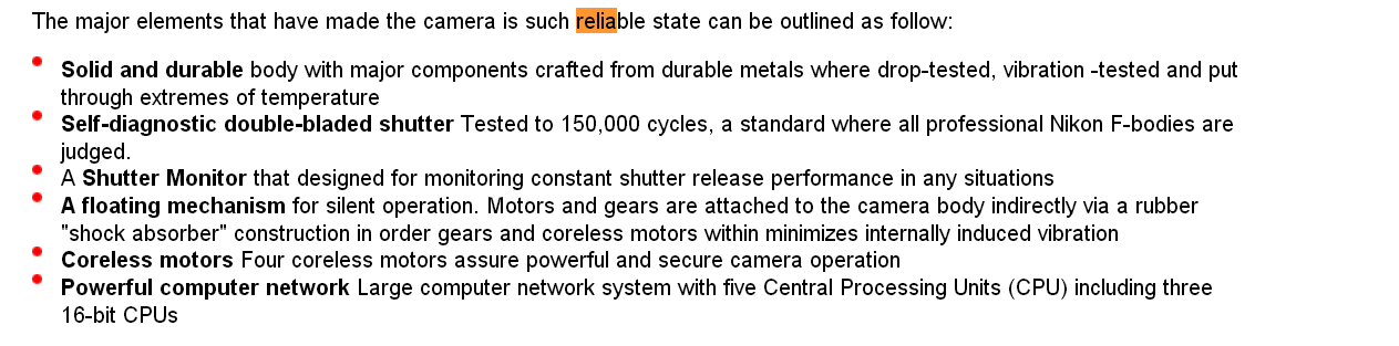

Here, well explained:
https://www.mir.com.my/rb/photography/hardwares/classics/NikonF5/reliability/
The F4, for example, has at least x2 more "for parts units vs OK" reletionship than the F5, still they are older in average.
Being the F5 filled with (5) computers the long term reliability it shows has some merit in the Nikon side... but what is most remarkable is the endurance of the precise and fast mechanics it sports, it is a miracle that those powerful motors cannot destroy the mechanics in the long term, pointing total quality in the design/manufacturing.

Well, D1 was the fist one figure D... so we should not crucify much Nikon for that... Still, what IMO is remarkable is that 1996 body concept for the F5 (jumping over the F6) remained until the today's D6. I feel there are design concepts reused from the F5 until the D6...
> true armored skin, isolated from the internals
> conterweigthed mirror mechanism
> enhanced resistance aganist vibrations, drops, impressively wheather sealed
> 1.5kg in the solid body, what a hard shooter Pro wants.
