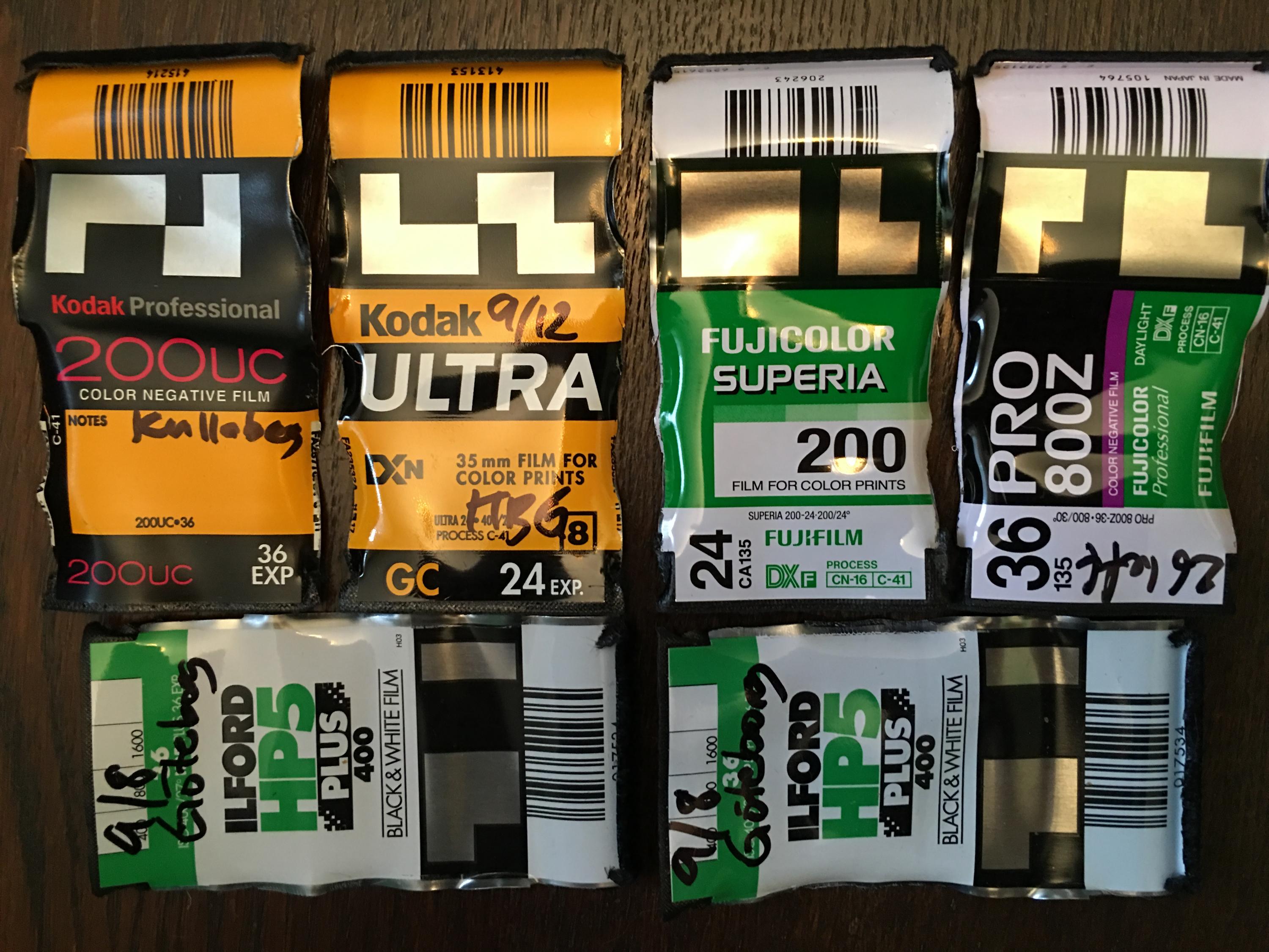

I developed a roll from my Pentax 6x7 today. Yesterday, I spent some hours in the darkroom printing and before that, developed some 4x5" film. I took a week off from work, so I can do a little more for my hobby than usual. Do I really have to get back to work next week? :confused: LOL!
In Ilfotec DD, which I was given ten liters concentrate of by a kind soul, and I finally started using and replenishing.
4 - 120 Tri-X
4 - 120 HP5
2 - 135-36 HP5
In C-41 color neg developer, a batch I mixed 9 months ago, and the film is coming out perfect.
1 - 120 Velvia 50 cross processed
1 - 120 Fuji NPC
1 - 135-24 Kodak Ultra 400
1 - 135-36 Kodak 200UC
1 - 135-36 Fuji 800 NPZ
1 - 135-24 Fuji Superia 200 - this one is an interesting roll of film, which I found in my deceased grandmother's old point and shoot Minolta.

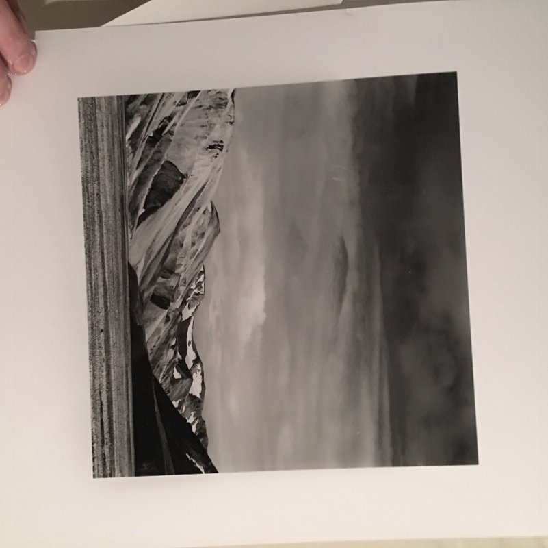

I made 40 contact sheets and about 15 actual prints over the weekend. All on 8x10 paper, contacts on RC, and prints on fiber.
I was given a ton of old RC paper that is still in decent shape, so I'm using them up for contact sheets.
I also made the print in the attachment, which is 8x8" on 11x14 paper. It's been a long time since I printed anything for real, so I ended up warming up with these prints in order to be more productive until the end of the year.
Gorgeous print! I find being in the darkroom very therapeutic. I haven't printed in months but I hope I'll get some darkroom time end of the year when my job at the university slows down a bit when the kids are away on holiday.
I really hope you get some time too! My problem was that I hadn't felt the joy of printing in a while, but it was more down to me just getting my printing pants on and doing it. Once into it I rediscovered how much fun it is. There's nothing quite like it, and it was so nice not to scan negs to look at the film.
Thanks Thomas! I felt the same thing when I was shooting professionally. Though I shot the photographs, printing for clients (production printing) gets old fast. Since it was for money, the game was to be efficient. Getting everything calibrated, dialed in so I'd spend as less time in the darkroom as possible to shoot more work. It was just mechanical and not creative at all. It took a while for me to recover the joy of printing. Now it's therapy time.
