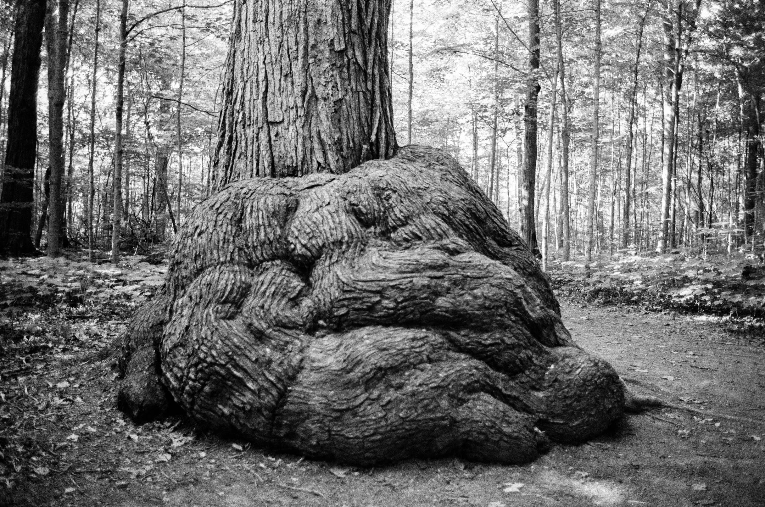

Unintentionally reticulated one of my vacation rolls (FPP emulsion x, xtol stock)
but the aesthetic fits
