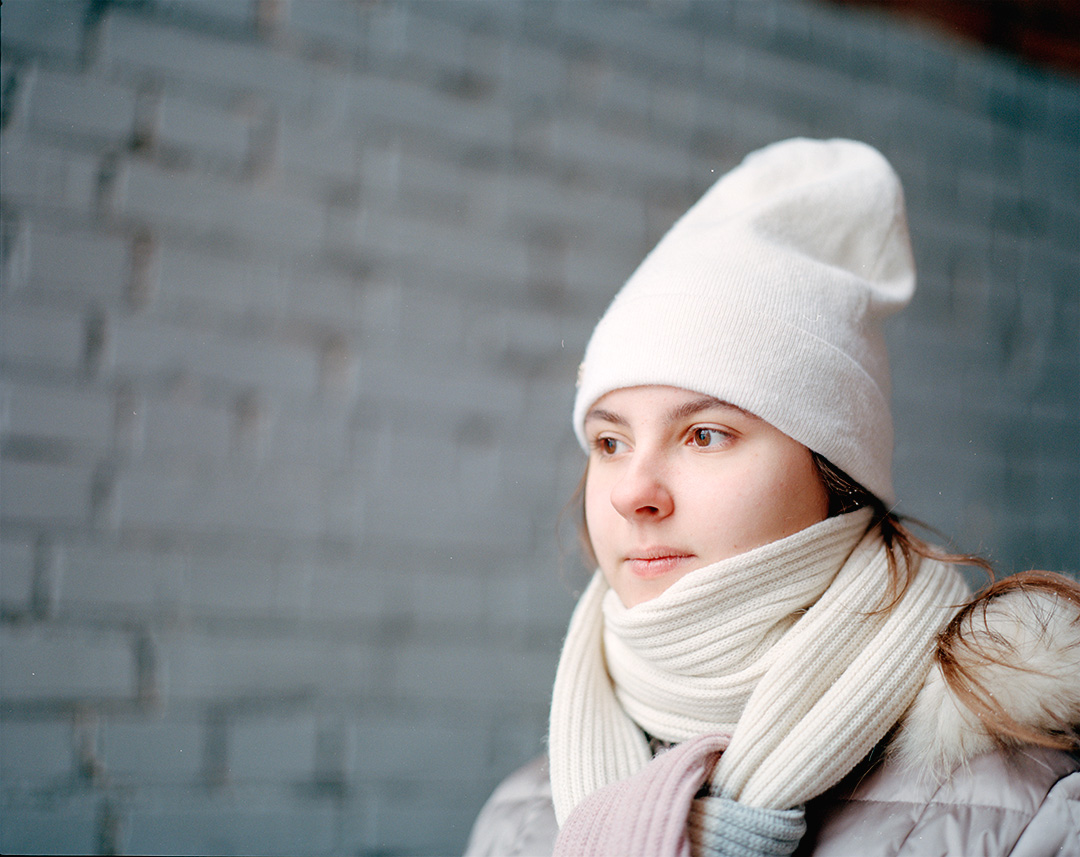

Here's the inverted image done with my PS Action and some slight adjustment by playing with the color balance layers.
You can see that there's more warmth, but I suppose it depends on personal preference. Also, light and atmospheric conditions are always more important than what film you are shooting on.
I like the result except the color spot on the wall. Can't understand where it is coming from. But still consider myself interested. Can you tell me what adjustments you made for this look after you've applied your custom action?
I'm not sure about the color spot on the wall, to me it looks maybe a bit too cyan but only you can know the true color and conditions on that day.

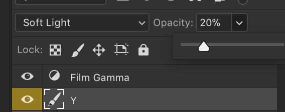

As far as my workflow, after applying the action I only reduced the Yellow layer by 20% and the Magenta layer by a couple % like so:
You can read about how it works in greater detail on my website.
