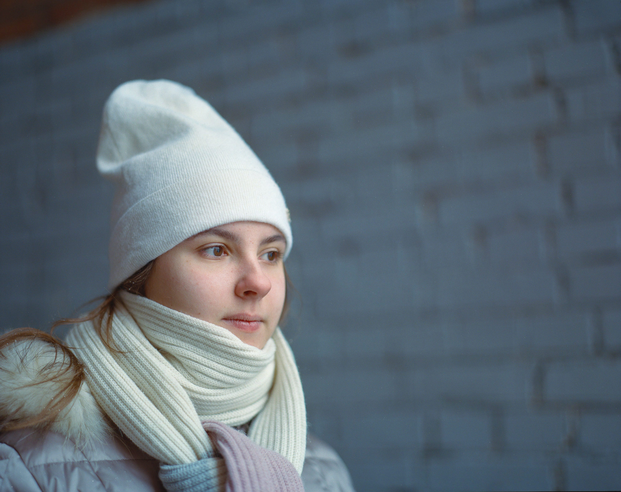

I have tried your action and here's my take with it. I used an additional LAB saturation channel.
And here's a comparison of Adrian's action with ColorPerfect. In ColorPerfect I made sure there is no clipping in the highlights or shadows, then applied levels layer to remove the cast. The process is described in this book, which is free if you have Kindle subscription. Then I used curves to give more contrast. I might've went overboard on this.
I really like your action. 15 Euros well spent, I say :smile:

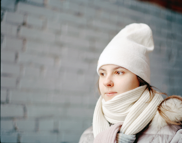

Something like this? I assume the light source is pretty cold?

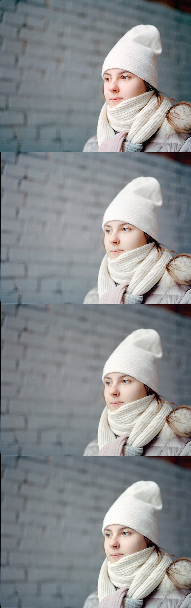

I did another comparison of your action with VueScan's output with a different photo. I was quite satisfied with this customized output from VueScan... until now: http://screenshotcomparison.com/comparison/131799
Yes! This example really highlights the strength of this method, it looks very nice!
As you see, what you do in the camera and the quality of the light is 90% of the work, the inversion then brings you the rest of 10% (if done right).
It was a winter overcast day, 2 PM. Yeah, the color temperature was quite cold. I think I was quite close in my initial rendering. The walls appeared that blue.
Your's a little dark for my taste. Doesn't look like overexposed Porta 400 to me.
I like the last one (with least saturation) the best. What is your approach?
The first one I posted was using the algorithm published by makers of colorperfect, It is easy enough to "reduce the exposure" digitally to make the print lighter.
I did it again using the algorithm used for DPX/cineon scanning (i.e. pretty much anything you saw at the cinema in the last twenty years that was shot on film). They are both similar in that they preserve the tonal relationships (the intensity ratios) that would normally result on a positive print. The DPX approach in particular works this way as it was originally designed create print film for traditional projector as its final product.
None of these have calibrated in any way to give colours, that would match a RA-4 print, a noritsu or fuji frontier. That's a later stage.
Do you have a shot that was taken at box speed of the same scene? and/or a one that was shot say 3 or 4 stops over?

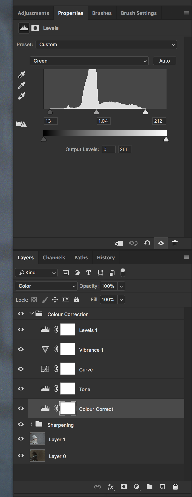

My method involves a photoshop action I've created that first runs the neg through colorperfect to do a basic inversion without any clipping to highs and lows, a one click colour balance in colorperfect which I preserve for each roll of film I convert. (I equally loathe and love colorperfect, it's layout and workflow is so obscure and unintuitive, but I've somehow managed to set the settings as I like, and I fear the day I have to try and figure out how I got there)
The action then creates a series of adjustment layers which I use to manually set the colour balance for black point, white point, then midtones. Set the black point, add a standard S curve and bump the saturation to a preset level which I feel compensates for the flat scan.
Sharpening is non destructive and adjustable Surface Blur method.
The process takes me less than a minute per image for a quick pass and fire it back over to my Lightroom catalog. I preserve the base layer as the original negative so I can alway reprocess or adjust if necessary.
