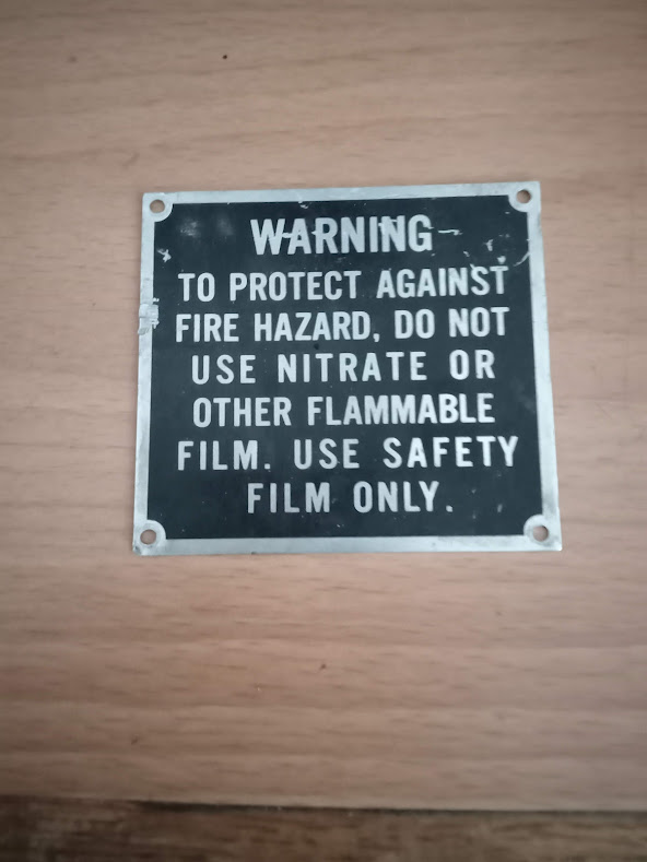

Found on an old Simplex projector, probably 1920s vintage:
I worked for a company who recycled silver from old film stock, mostly X-ray films but some motion picture. We would get Nitrate films occasionally and they were treated with extreme care. The company had acquired a small competitor who had gone bust after a factory fire caused by Nitrate film spontaneously combusting, burning the wooden roof of the building. The Insurance company had refused to pay out.
The Nitrate films were stored and transported in metal chests, they had come from film archives after careful duplication, after the silver was recovered they were incinerated.
