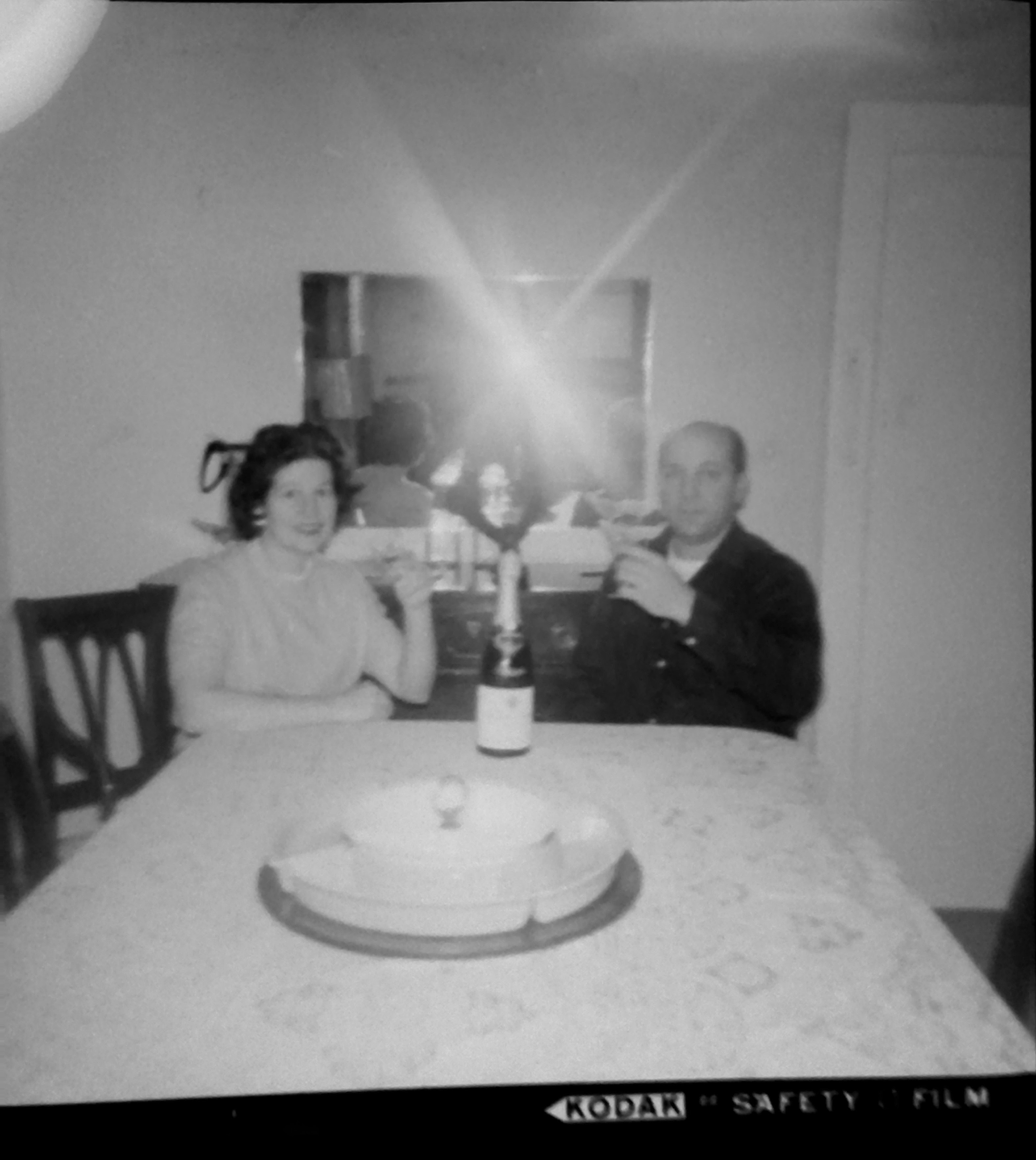

It's amazing that I just joined this community a day or so ago, did a google search for "Kodak Safety Film" after scanning a very old negative of my grandparents and saw the name of the film on the scan and it brought me to this post.
Just for giggles and reference here is that scan with the Kodak Safety Film logo.
Prior to safety film, there was nitrate film which was inflammable and could be unstable. Others can provide more information, but I never handled any nitrate films so listen to them or fill in the details from the internet. Welcome to APUG Photrio!!

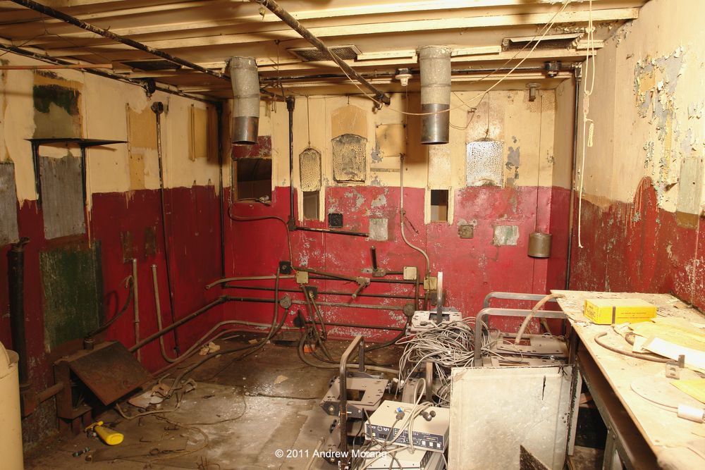

Here is a long-unused cinema projection booth in Vicksburg, Mississippi. The cinema was installed in a brick commercial building in the early 1930s, so the film stock would have been nitrate. The trap doors that Photo Engineer (Ron) referred to in an earlier message cover the openings to the booth where the projector shone the film. If a fire broke out on the nitrate film, a lead plug (or maybe wax plug?) on the steel cables melted and the little guillotine-style doors slipped down to seal out fresh air. This is a digital photo from the APS-size Sony R1 camera, which I really liked. The Strand Theatre has been restored and is regularly used. Here are more unrestored pictures:
https://worldofdecay.blogspot.com/2011/04/strand-theatre-vicksburg-mississippi.html
