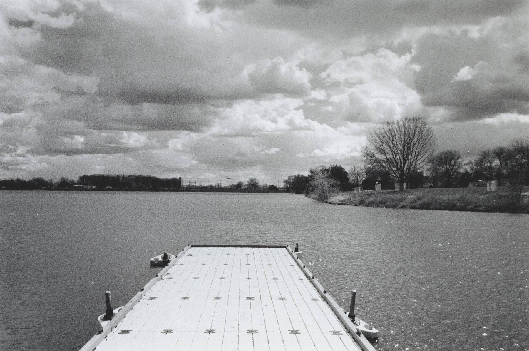

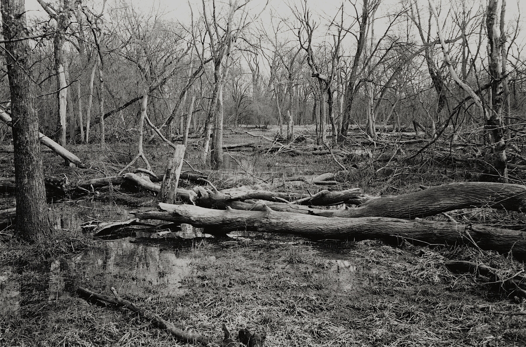

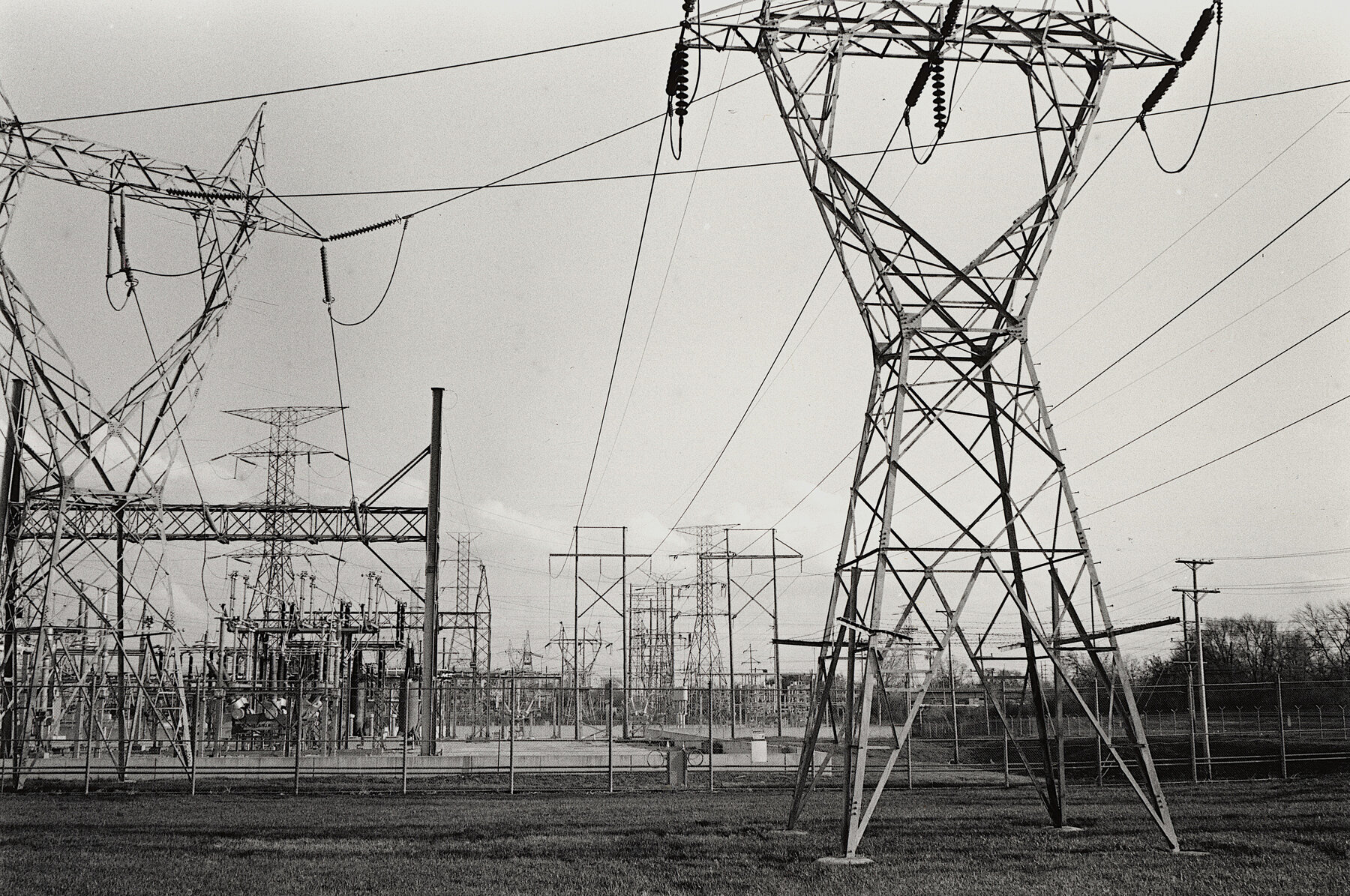

OK, here we go.
These are all scans of 8x10 Fomabrom Variant 111 silver prints split printed under a Heiland LED head, made from Fomapan 200 exposed at EI 200. These were all lightly toned in Kodak Rapid Selenium Toner 1:40 for 3-4 min.
[ April 2024] Plane A Pierance (Reference print as requested)
Leica M2, 35mm f/2 ASPH Summicron
Pyrocat-HDC 1.5:1:250, semistand 45 min
[ April 2026] Swamp Thing
Leica IIIf, 35mm f/2.5 LTM Color-Skopar
Pyrocat-HDC 1:1:500, EMA 60 min
[ April 2026] High Wire Act
A few observations (thereby changing quantum state :wink::
  • The scans were very lightly adjusted in post so that the tonal range and sharpness are shown as closely as possible to the physical print.
  • To my eye you can see significant improvement in sharpness in these scans, but it's really clear in the original silver prints.
  • Neither in the scan nor the prints themselves was there any objectionable (to me) grain.
  • A similar degree of sharpness can be obtained with Fomapan using D-23 1+9 with 0.5g/l sodium hydroxide (lye) with a potential for also increasing grain.
  • You may see a few blemishes in the scans. This is an artifact of uneven Fomapan quality and I have seen it before.
  • I can't quite see if there are edge effects here or if that just the natural sharpness from this process.
  • If you magnify the top of the vertical post in about 1/3 from the left side of the last image, you can actually see a wire loop. I'd call that fairly hi rez :wink: Compare that to the resolution of the plane in the distance of the reference print.
  • As @koraks notes, there is an homeopathic amount of active developer available at this dilution. It is very important that you use a sufficient amount of developer in the tank. I did this with a 500ml tank filled for just one test roll of film. You can also open tank process this in a 2 liter Kodak rubber tank which would also ensure there is more than enough developer. As always, the reel goes on an inverted funnel.
  • I realise that in some degree you have to take my word for what I've done here.
Constructive and corrective comments, criticisms, or questions are welcome. However, if you're going to be nasty, you jolly well better be funny too ...
Chuck those apier 😉 to be nice prints....
I really like the delicate tonal separation in the swamp photo!
It's that long, slow, low agitation boosting midtone separation, and dilute Pcat keeping the highlights happy. Like I said, I probably should have exposed at EI 160 for just teensie more shadow detail.
