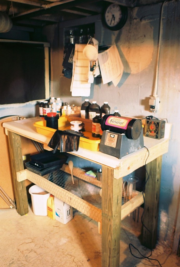

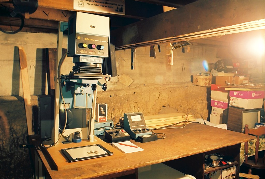

Thanks. I did a lot of bracketing to test out the film. The darkroom shots were both shot at f5.6 for 2 secs. They were also shot at f2.8 for 1/2 sec. The ones at f5.6 for 2 secs are much sharper and the coloring is more balanced. I really learned the limits of my Chinar 28mm (my only non-Nikkor lens).
