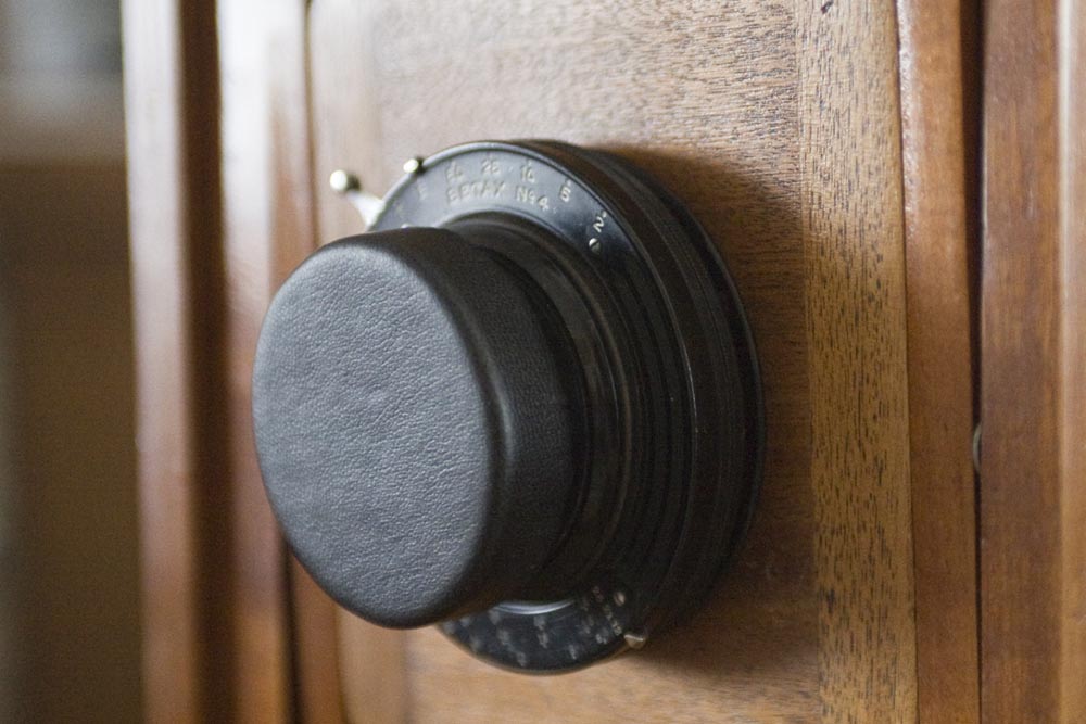

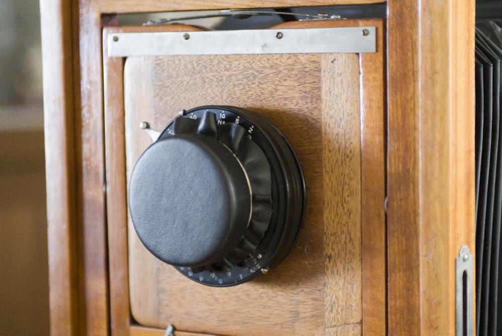

Found a groovy article on making lens caps taken from the book 'restoring classic and collectible cameras'. All you need is, card, leatherette, wax paper an elastic band and a bit of glue. Here's one I'm half way through...

In a pinch,thats not a bad fix.The card is round and goes between lens and leatherette and the band holds it around the lens,were does the wax paper go?

No prob Mike! Here's the finished cap, the inside is lined with black felt. It's a really nice snug fit.
