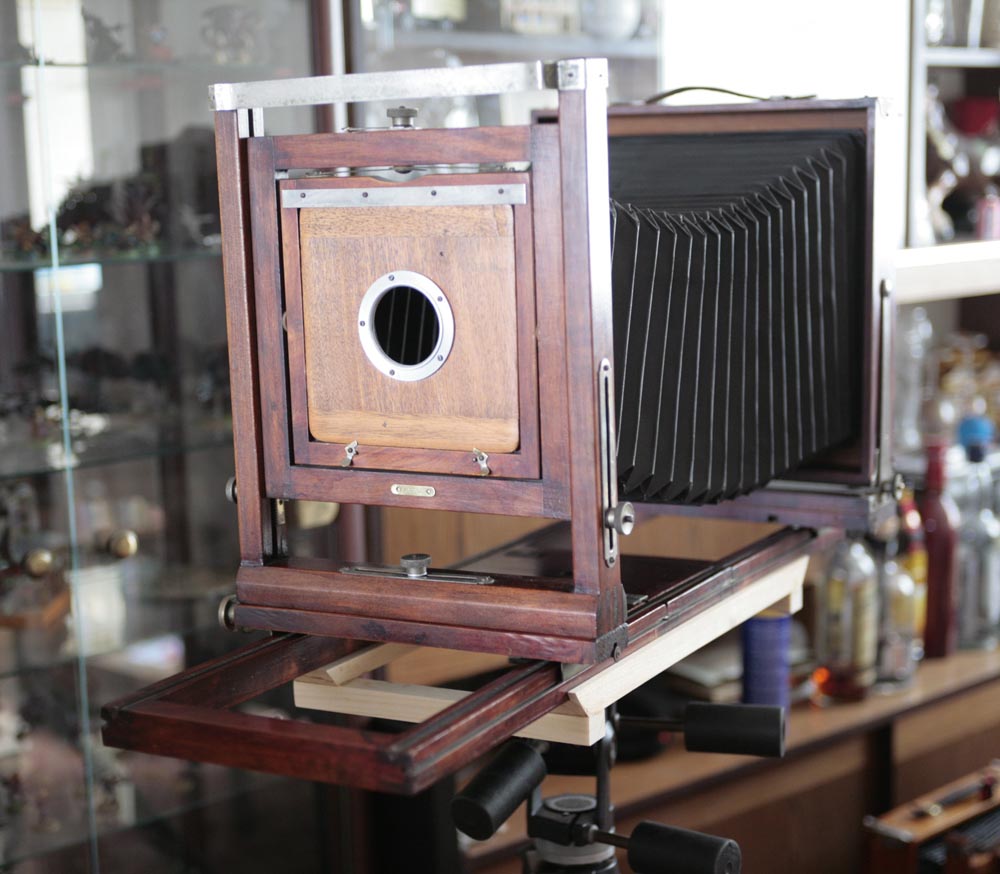

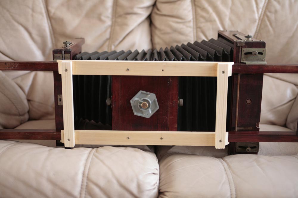

Attached some stabilizer bars to the bottom of my Korona 8x10" destined for wetplate work. Should hopefully take the strain off a big hunk of brass lens when I get one.
Have you ever had the camera turn when using the quick mount Bogens? On my cameras either the finish is too smooth or the metal is too slick and they will sometimes turn. I was thinking of putting in a post or hole so the quick mount will stay in place. Mine have some material that's not cork but a plastic. Looks like a nice job making the stabilizer, even though these cameras are strong they sometimes flex at the hinges.
Curt
Yeah, it happens quite often. They need to be screwed in real tight to avoid it don't they. That sounds like a good idea Curt. If you do it please show your results. :smile:

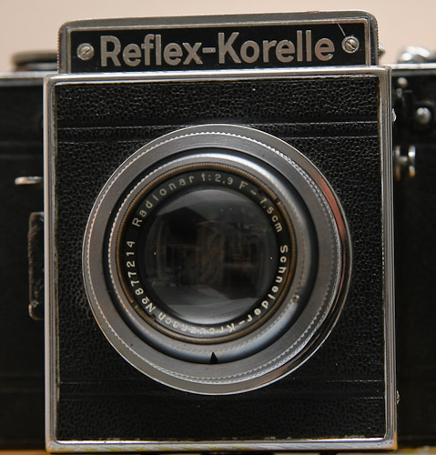

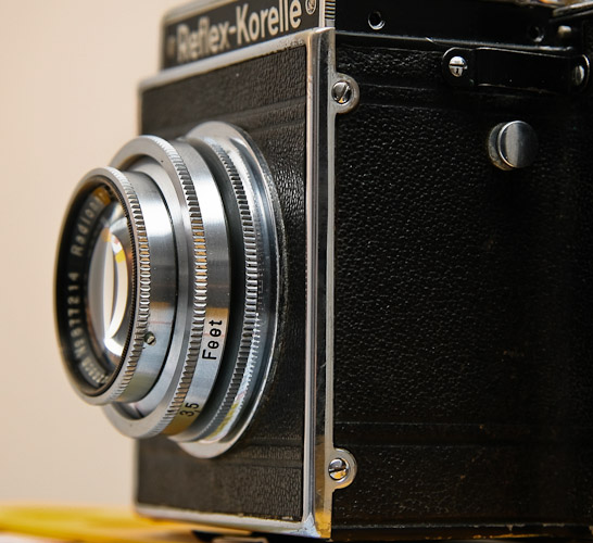

Had the fun of cleaning a reflex-Korelle Lens 1:2.9 F=75mm , came apart nicely but getting it back to is proper setting was Hell, took over Four hours to get it back to be where it was [I think ] I must remember to think twice before I do this again:
