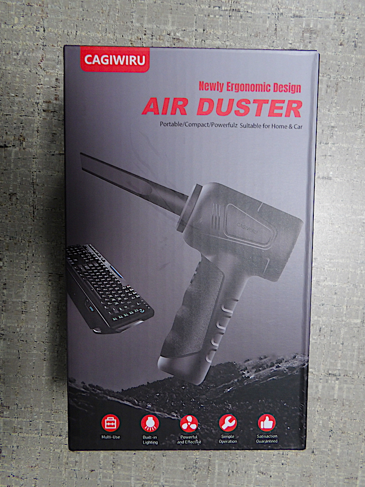

Mine is similar to this:
But it's a vacuum, not a compressed air source. The trick would be to find an oil free small compressor.
I am still in the process of getting the darkroom set up and haven't had a chance to try this out.

I went with the WolfBox model reviewed here:
It's extremely strong, overkill for many tasks, in those cases I just use a rubber handheld blower.

The worst thing for film, paper, and delicate camera and lens cleaning would be a high air pressure emitter, like in the posted video, even though every one of those looks like a pathetic toy right out of a Cracker Jacks box. I even question how safe something that inexpensive can be in terms of flimsy high RPM fan blades and cheap battery fire risk.
At the other extreme, once high-pressure CO2 tanks come into play, they need to be equipped with high-quality dual step-down regulators (as is legally the case if leased from a professional service specializing in compressed gas). But when things get DIY jerry-rigged, then you potentially have a deadly bomb on you hands if a weak regulator fails.
