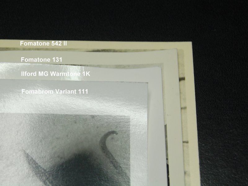

A quick snap of some of the papers in question:

I am not sure how to explain what I think is the difference between "creamy" and "yellowish". I might say "ivory" or "ecru" instead of "creamy", but I doubt that clarifies much. Referring to the picture posted by miha, on my monitor and to my eye: the Fomatone 542 II looks very yellow; the Fomatone 131 looks much less yellow; the Ilford MG Warmtone 1K looks white; and the Fomabrom Variant 111 looks white but less bright than the Ilford. Nevertheless, the base of Ilford Warmtone does not look white to me in person, especially compared to Ilford Classic. This difference is most noticeable in sunlight, less so in the florescent lights in my house, and less still in tungsten (unknown color temperature). But I still see a definite difference in tungsten.
