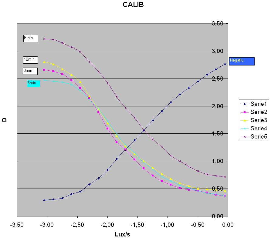

Sorry, I've not explained it clearly. What you say is true with classic home reversal, this is a calibration I made with a hacked Rodinal and Sn fogging 2nd developer :
We see there the same gradient not matering development time, we have some DMax improvement with extended 1st developer time. The top 6 min curve was using a different solvent...
It is a calibration I made personally, so I'm well aware of that.
What I was trying to propose is a reversal variant with minimal silver solvent effect, with enhanced energy, with partial light re-exposure, and with promoted infectious development of the unused silver, to reach (say) 4.0DMax with Delta 100, while having clear highlights. In that case, with little silver solvent effect, 1st development gradient controls the slide contrast.
My suposition is that a silver solvent rich first developer limits actual development, as unexposed little silver crystals around big exposed crystals are disolved by when infectious development would attack them, so no density-contrast increase would take place after that point.
A more energic developer would develop more before touching unexposed crystals are destroyed by the solvent... so what you say is true for regular BW reversal.
...but consider that I was talking about another situation: no silver solvent, when this limitation if not acting then 1st development time rules on contrast, which follows Mr. Woods recommendation, and he is the one offering 4.4D from Delta 100

Lachlan, there is no EI, and no "metering method": this is from contact copies of an Stouffer T2115 wedge on film strips, with luxmeter measured real Lux reaching the wedge, so having absolute H units (Log Lux·Second) in the exposure axis, like in Kodak/Fuji datasheets. If you need to review how film is calibrated then see BTZS book, it is a good reading for that.
When calibrating with absolute exposure units we can predict exactly what density we'll obtain for any spot in the scene, when wanting to know it. And of course we know what ISO speed and metring says.
Usually I adjust contrast to match Provia, and as Provia datasheet also has absolute units I simply adjust my BW slides EI to match the Provia result after comparing the exposures at the respective speed points. In that way I adjust the reversal processing and EI from sensitometric curves nailing a perfect result since the very first roll. Of course I may later adjust EI/processing for aesthetics, but from the Reversal calibration and Provia reference I get very good results at the first try.
I've not been shooting BW slides for two years, I'm to engage again soon, this time I've my calibration software ready and newly learned concepts to try to enhance my workflow, when I have it I'll publish may results if they are worth.

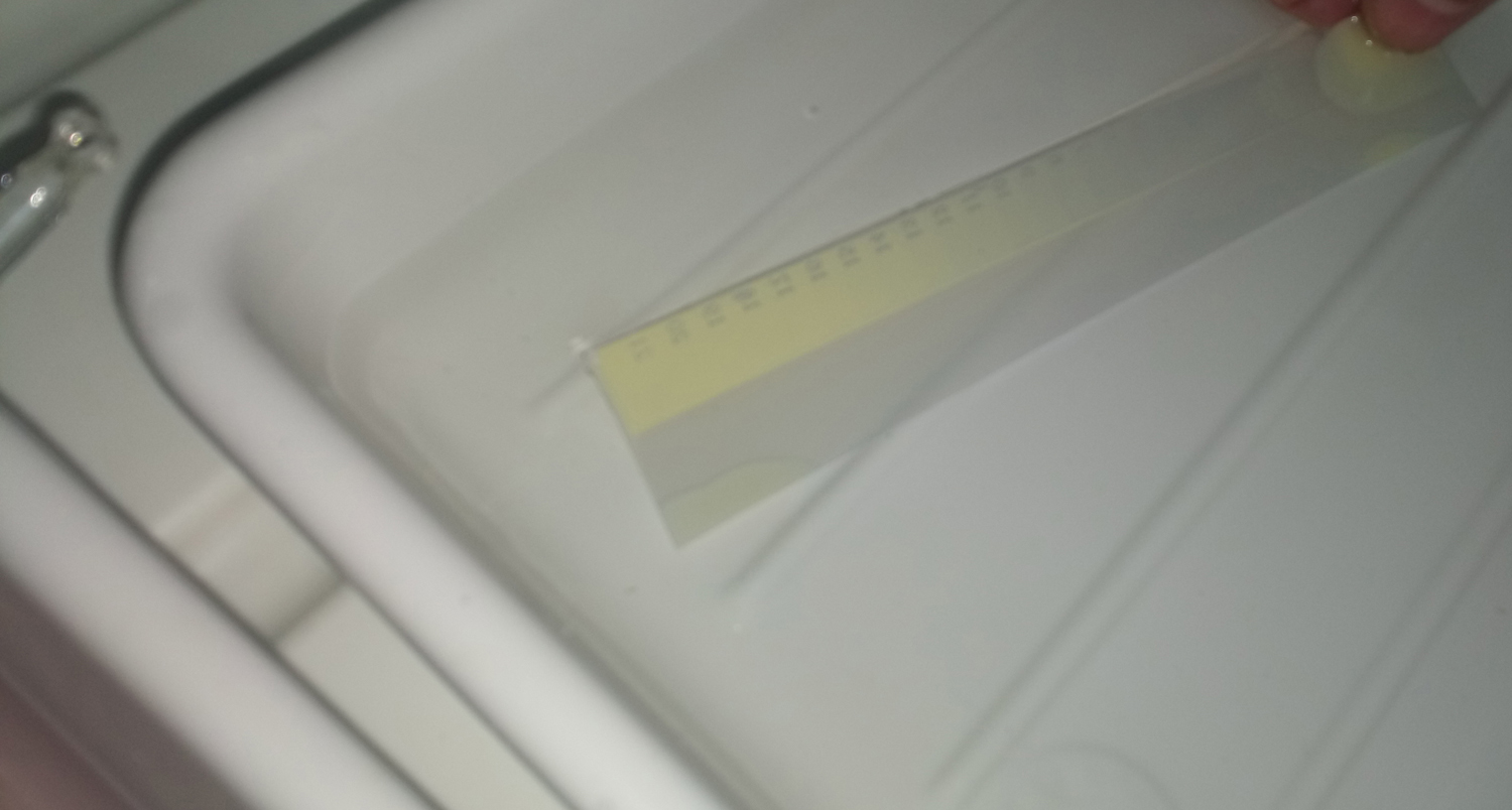

I made that particular calibration for a friend who is a proficient Pro chemist, in my darkroom with him. I don't recall his exact formula, If you are very interested I can search it in my darkroom or ask him, with HP5+ he was using Rodinal R09 with boosted pH and silver solvent. 2nd developer was the same without silver solvent with Sn fogging, but 2nd development was made also lights open to completion as we saw all halide disapear totally.
IMG_20191123_142454.jpg That day, just the contact strip falling in the 2nd dev...
He had low contrast and poor DMin, so I helped him troubleshooting those two factors.
That time I learned what Eldorado explained (https://www.photrio.com/forum/threa...g-but-also-not-die.174178/page-7#post-2269433), with the regular processing 1st development you cannot adjust contrast from development time because of the silver solvent (I guess) destroying small crystrals.
With my chemist friend we had an smart idea: not using silver solvent in the 1st development... Then if wanting to clear highlights we use the silver solvent in an additional bath just after a water stop bath or (better) after clearing bath, in that way we can separately adjust contrast in the 1st development and DMin in a following "silver solvent" bath, with a less complex interaction. As silver solvent and 1st development have an interaction an smart way is separating both jobs in two separated baths.
...but presently I'll experiment wtih no solvent (or the less possible), to me it's the way to obtain an extended DR in the slide.

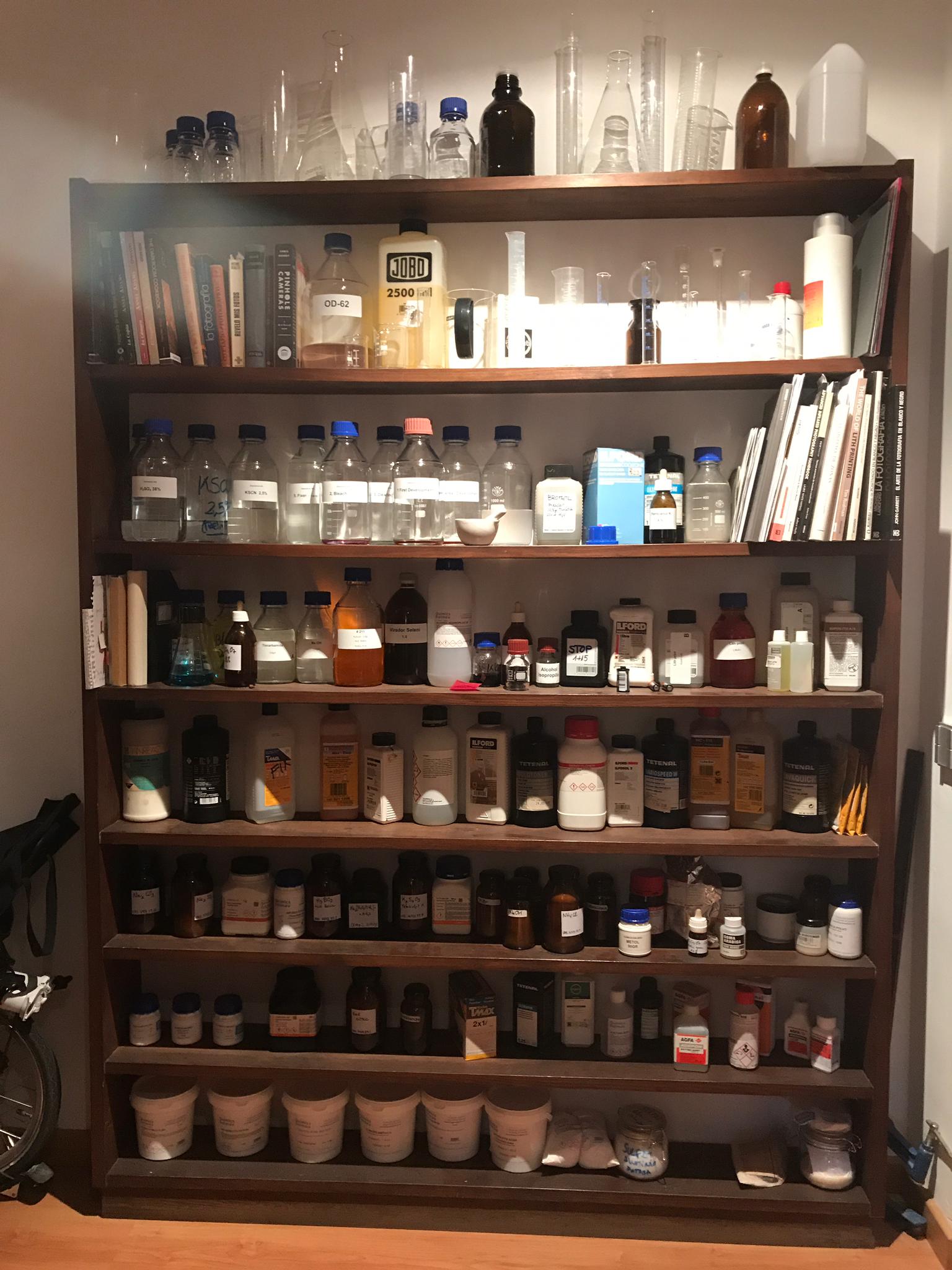

Did you/your friend try out any of the well known first developers (such as those posted by @Ian Grant ) before settling down with the Rodinal hack developer?
He tested many reversal formulas... but chemists a bit are like witches, they want to cook the soup they eat :smile:
A fraction of his photo-chem shelves:
Some 60 stored substances for reversal...
And he got low contrast as well as low DMax for HP5+?
You really don't want show-your-chem-shelf-porn posts to derail this thread. :smile: It could be a good idea for a separate thread though. :wink:
You asked about what my friend knows or not, that chem-shelf-porn :smile: doesn't say all, many (like me) have decorated shelves, but another thing is writing all reactions , calculating equilibriums and speed of the reactions. Still photo-chemistry is quite complex and there is a lot of conceptual knowledge around.
