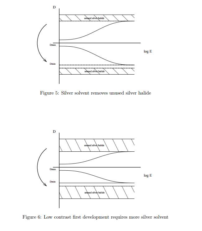

Ian, let me to bring attention again to this graph:
What we do with unused silver ? Eliminating it with silver solvent ? Building fog if we do not eliminate it ?
Let me tell you my view on how we can use that unused silver to increase DMax without generating fog (without damaging DMin).
That unsued silver has very, very low ISO, but we fog it if we use a fogging developer or if our re-exposure is total... if our reexposure is total then that silver has to be eliminated by a solvent at some point to clear highlights...
But see next strategy:
> We don't develop or disolve the unused silver, but with a very energic first development we (infectiously) develop that unused silver in the highlights, and we clear it in those highlights with the bleaching.
> We make a controlled re-exposure that is not enough to expose the "unused silver": mostly it wont develop, it won't generate fog, we will remove it in a final fixing.
> If we use a very energing second development that "unused silver" will infectiously develop in the shadows, increasing DMax.
In that way we use the "unused silver" to get an extended DMax with no fog, so a boosted Dynamic range.
David Wood further adds a toning, wich is a kind or proportional stain that increases both contrast, and dynamic range.
Well, Fuji makes Velvia 50 with 4.0DMax power. It shines in the projection. In my experience those BW slides sporting a high dynamic range are quite powerful when projected !!

The films Ian was talking about these controls being used on were pre-WWII technology - heavily polydisperse, active gelatins, curve shapes not ideal, a lot of unsensitised silver. What you might have been able to get away with in the 1930's is probably going to not work terribly well with modern grain structures, additives & highly controlled growth and sensitising measures.
Modern films also have lots of "unused silver". If you home develop BW slides you will that your slides fail to reach film DMax by a great extent.
Note too that many of the films recommended for DR5 often seem to have EI's suggested that amount to a fair bit of overexposure & that getting to box speed requires 'pushing'. That suggests that the process has issues chemically accessing the silver in an optimal way to maximise speed for many emulsions.
I see this related to clearing highlights without silver solvent, which would damage DMax.

That has nothing to do with "unused silver" (whatever that means).
With a properly calibrated system a true DMax is achiveable even at home.
My view is that is has to do with it. Unsued silver halide is the one not developed by 1st developer and that is to generate fog in the second developer if it is not removed by silver solvent in first and/or 2nd development, or by other means like a density reducer.
At home, when you use a silver solvent to clear highlights (and obtain a good DMin) you also decrease your DMax potential, as the silver you disolve won't generate density.
With a wise processing you may infectiously develop that silver to add density in the shadows and not in the highlights. Some low Dyn Range scenes won't require a high DR in the slide ...but some scenes are to benefit from an extended DR in the slide, showing bright hightlights and fully detailed deep shadows at the same time. One thing is a 2.3D Dynamic Range slide, and thing is one sporting 4.0D.
I don't really know what Foma put in their first (=second) developer in the kit but the results are stunning. A truly calibrated system with a fantastic emulsion. This is my piece of advice to the original poster: get the Foma reversal kit and the Fomapan 100R. You'll save yourself tons of money of burned films and spare time.
Grant & Haist states that the silver halide solvent has also the function of physically develop the Ag specks so to redeposit some Ag in the growing area. This allow a greater DMax achievable.
