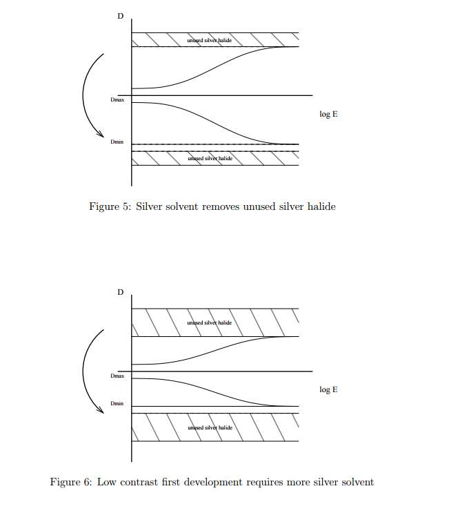

Please see attached document (http://www.ars-imago.com/productinfos/osbahr_reversal_films.pdf)
Page 12-13...
...shows the unused silver halide. The question is that some Pro Lab jobs (Scala, DR5) do sport a DMax vs DMin that home processing may not reach by far.
This is only a suposition, something I'm to investigate: perhaps a way to obtain an extended dynamic range for the projection is provocating a large infectious (2nd) development of the "Unused Silver" in the shadows but no development of the "Unused Silver" in the highlights.
My reasoning is: if we fog and develop all "unused silver" when we remove that density (solvent, etc) then we also decrease DMax potential... The single way I see to conserve top DMax and min DMin is infecting the "unused silver" in the shadows and not fogging the unused silver...
Disclaimer, just trying to find an explanation for the Pro Lab vs Home yield difference, just speculating while preparing to check it.

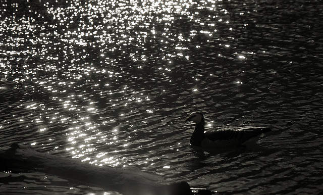

This Silvermax slide, for example:
...it's quite dull in the monitor, I can't edit it to show the contrast between glares and shadows.
Instead in the (boosted) projection contrast is amazing, glares are so powerful that one nearly needs sun glasses to view it, and at the same time shadows in the backlighted duck are fully detailed.
...so what I'm asking is the way to obtain top DMax and base DMin, for a high dynamic range in the projection. Not all scenes require that, of course.

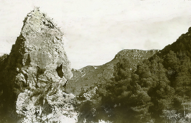

Here is what CMS20 looks like in Scala - a very quick and dirty scan of a not great image, but overall corrected contrast to match the transparency. You can see that on a sunny/ contrasty day the shadows and specular highlights crush & clip very hard respectively - not much roll-off at either end of the straight line. On a shorter contrast scale day, they will likely look a lot more 'normal'. Improvement from here would likely require modification of the first developer. I note that Adotech IV does contain both HQMS and KSCN, so it might make a surprisingly good first developer - but under no circumstances should you use the permanaganate bleach with it.
